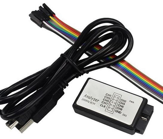

or would a logic analyzer be better? since i could look a lot of signals at the same time to check timings
A logic analyzer is good in that way, but if you have signal problems (such as what you might be experiencing now with the USB thing) that mean the digital signal isn't being decoded properly, the logic analyzer won't help much with finding that. I'd definely go for a 'scope first.

a logic analyzer would be more useful to check the function of the actual computer, since it would allow you to look at the data bus, RD/WR signals, etc at the same time without having to single step through everything, and manually check with a logic probe.

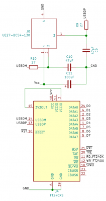

this is a section of my schematic, showing the USB connector (top) and the FT240X (bottom).
pin 15 and 3 are connected to eachother like the datasheet says,
Vcc and GND are connected as well,
USBDP is connected to pin 3 (D+) of the USB Connector, and USBDM is connected to pin 2 (D-) of it.
SI/WU is being held high at all times so that one deos nothing.
the Data lines, RXF/TXE, and RD/WR are completely irrelevant at the time (but i checked the RD/WR pins and they are held high as well)
pin 17 (which is actually VCORE) and CBUS5/6 are also not needed and therefore just left unconnected.
CBUS5/6 are programmable but by default are used to detect if the device is plugged into a host, and to keep the device from putting itself into a stand-by mode when not plugged in.
i did actually use that CBUS5 pin to see if the device even considers itself plugged in. and when plugging it into my PC it pulses High a few times but afterwards stays low. (it's always the same pattern when i un/replug it)
I'm almost tempted to make a new PCB that just has the FT240X, a USB Cnnector, some passives, and a few pin headers on it.
so i can see if that one would work, and that way i could have a functional USB device that i could compare to my currently not working on.

so it either is my soldering, the chip being broken, a problem with the PCB, or the traces.

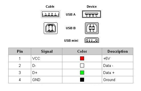

Or just a problem with the design. One thought occurs to me: are you absoutely certain that you have the D+ and D- lines wired correctly? Reversing those would definitely confuse USB interfaces since the polarity of them is what's used to determine the transfer speed.

Well, the logic analyzer is useful if you really need more than four channels or need a lot of memory. For that quite different kind of debugging I suspect that a PC-based system might be ok. (Unlike PC-based oscilloscopes, which are universally considered to be a pain.) That's easy to try out cheaply; grab one of the cheap <$10 USB interfaces (pictured below) and use it with Sigrok. If you're still on the edge about getting a 'scope, going ahead and doing that might be a good start, since it's nearly free except for your time. That said, I have one of these and have yet to plug it in; I've found that for my limited needs debugging with just four channels has been fine so far.
thing is that i would like to look at exactly what the CPU is doing at all times, which would require me to check the data bus, address bus, chip select pins, etc. which is a bit more than 4 channels can handle.
i think i can actually do that right now since the CPU can easily run with a slow clock, so i can use one of my arduinos to generate the clock for it, and capture the data/address bus on every clock cycle... to see what it's trying to do.
which is more useful for debugging actual programs than anything else.
but since i also want to test the function of the computer it would be useful for me. i'll have to look into arduino programming again later.
because timings of the 65c02 still confuse me, and i don't know if it's accessing the ROM correctly because the test program i'm trying to run doesn't work as intended.
Yes i'm very sure.
using the image below (USB B, Device) i confirmed that 1 is Vcc, and 4 is GND exactly as shown.
2 is D- and checking with my multimeter is connected to pin 14 of the FT240X, which is USBDM (USB Data Minus)
3 is D+ and checking with my multimeter is connected to pin 13 of the FT240X, which is USBDP (USB Data Plus)
that looks correct to me.

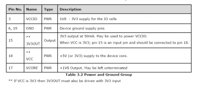

I agree it sounds critical. Surprisingly, it may be "left unterminated."
"Synchronous and asynchronous bit bang interface options." Interesting product! Datasheet attached. But I barely skimmed it.
Among other things, it does mention "storing device descriptors and FIFO I/O configuration." Sounds like there could be potential for a show-stopper there...
FT240X USB fifo.pdf [952.67 KiB]

Yes as the datasheet says it's a 1.8V output. there is nothing on the chip that requires 1.8V, and if you check the example circuits below it doesn't even show VCORE anywhere.
problem is that in order to program the chip you need to use FTDI's software for it... which as you might guess connects via USB. so if the Chip is not connecting it cannot be programmed.
if you look into the datasheet (section 8.1) it mentions the default values that are pre-programmed into it.
