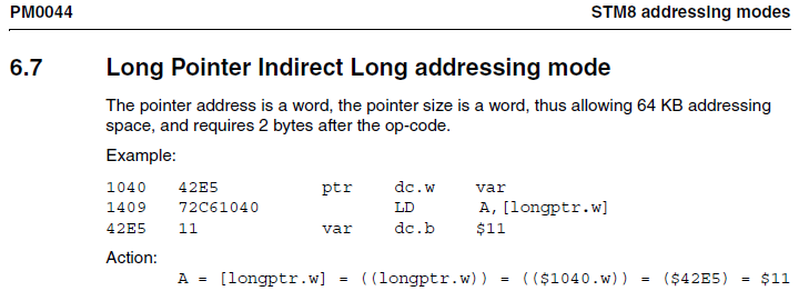

Tor wrote:
architectures which don't have indirect-indirect addressing (and many don't. Maybe very few - not even the very CISC-y mini I worked with, with its 28 addressing modes, had it).
The STM8 has a couple of Pointer Indirect addressing modes, but the pointer-to-pointer must be a constant, encoded in the instruction.
Edit: STM8 also has LDW X, (X)
