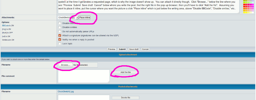

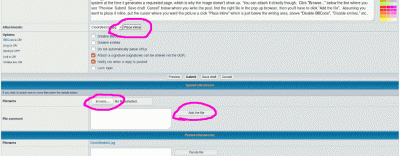

The [img]...[/img] tags are for when you have the URL of an image that's available online. The forum software can't access your computer's onboard file system when someone requests a page for it to generate, which is why the image doesn't show up. You can attach it directly though. Click "Browse..." below the line where you see "Preview Submit Save draft Cancel" below where you write the post, find the right file in the pop-up browser, then you'll have to click "Add the file". Then, assuming you want to place it inline, put the cursor where you want the picture a click "Place inline" which is just below the writing area, above "Disable BBCode", "Disable smilies," etc..
Someone loaned me a netbook years ago, and as I remember, it worked like a normal laptop, just smaller. This was before the iPad and similar computers were out. Anyway, I'm sure you can attach your pictures this way.

As I recall my frustration that day, the browse button wasnt working (for whatever reason). I have a GalileoPro, RCA (chinese/Asian manufacturer; RCA, David Sarnoff's "baby", was sold off back in the 80's I think (I was 0-10 years old, back then!); now it is just a name. Though a friend of mine just got an RCA microwave?).
I hate the darn thing. It doesn't let me name the file I am downloading, it doesn't always tell me when the download is in progress or when its finished, so I sometimes get truncated files because I multitask and go do something else, without the computer asking me if I want to let the file finish downloading.
It shoves all downloads into the download folder, and then between the two programs designed to move files, one will rename, delete and/or copy the file to a different folder (but not move or read the pdfs or video files). The other program will not rename, but will delete and/or read the file, but, again, won't move the file.
So , hassle above all hassles, I must scroll through one program to read and see what the file is (annoying if it is 4673967923.pdf?), then rename with the other program, then copy with the other program, then back to the other program to delet the original. HASSLE! Stupid OS! Android lollipop or marshmellow or something stupid like that.
I am cheap, and only use the free apps. Most of them stink and are only marginally useful. I found one or two good 6502 programs, though, and I wrote an asssembly program to help the local kids learn to prgram 6502 syntax. No takers so far, but I overstimate their abilities and proclivities sometimes. I need to find the precocious kids, I think?
So, one more try on this posting my photo, in a post below this post (i.e. this rant).
