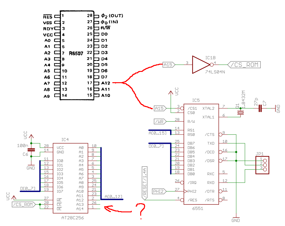

I think your code is probably correct, given the very simple hardware configuration. Just tie off those input lines and try again.

Okay - so we should take another look at your physical circuit layout. You now have a second oscillator in use, and we know that clock edges are a sensitive subject.

PostPosted: Fri Feb 22, 2019 8:01 pm
More questions. Sorry! :)
hitlp wrote:
I'm using the AE29f2008-12 which is a memory flash removed from a PC BIOS. The pinning is very similar to the AT28C256.
Except the AE29f2008-12 has one more address input than the AT28C256, is that right? Just checking.
since the 6507 only has addressing up to A12, I connected this port to 6551 as if it were the A15 of 6502.
Alright, we use A12 as the substitute for A15, and you say you attached A12 to the 6551. Did you also attach A12 to pin 3 of the inverter? (both changes as shown in the diagram upthread)
And can you also tell us please what assembler you're using. Also, what do you use to load the AE29f2008-12 with the file produced by the assembler? And what sort of file is it?
I attached as below:
6507 Pin A12 -> 6551 Pin 3 CS1;
6507 Pin A12 -> SN74ls04n Pin 3;
SN74ls04n Pin 4 -> AE29f2008-12 Pin 22 CE#
SN74ls04n Pin 4 -> AE29f2008-12 Pin 24 OE#

The 6551 has /CS1 (active low) and CS0 (active high). Presumably you've tied CS0 high?
So you have an assembled object file. How is that getting into the ROM? And given that you have a 2KB address range mapped to the ROM, why is your image 8KB long?
Yes .. I put CS0 on VCC.
It is a good question .. :roll: But in this case, the 6507 doesn't ignore the rest oh unused ROM?
PostPosted: Fri Feb 22, 2019 10:03 pm
It does. So think about exactly what vector addresses it's reading, and what happens next.

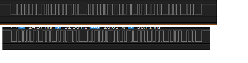

Hello guys. It's me again.
I came back with a new 6502 processor and by the time I communicated with the ACIA (6551) it worked correctly. Now I'm trying to do a serial output with "Hello World!". I'm trying to use Putty but I do not see anything in the text output. Using the logic analyzer, every time I press the 6502 reset, it "spits" the same output. But I can not analyze it.
What can it be now? :(
