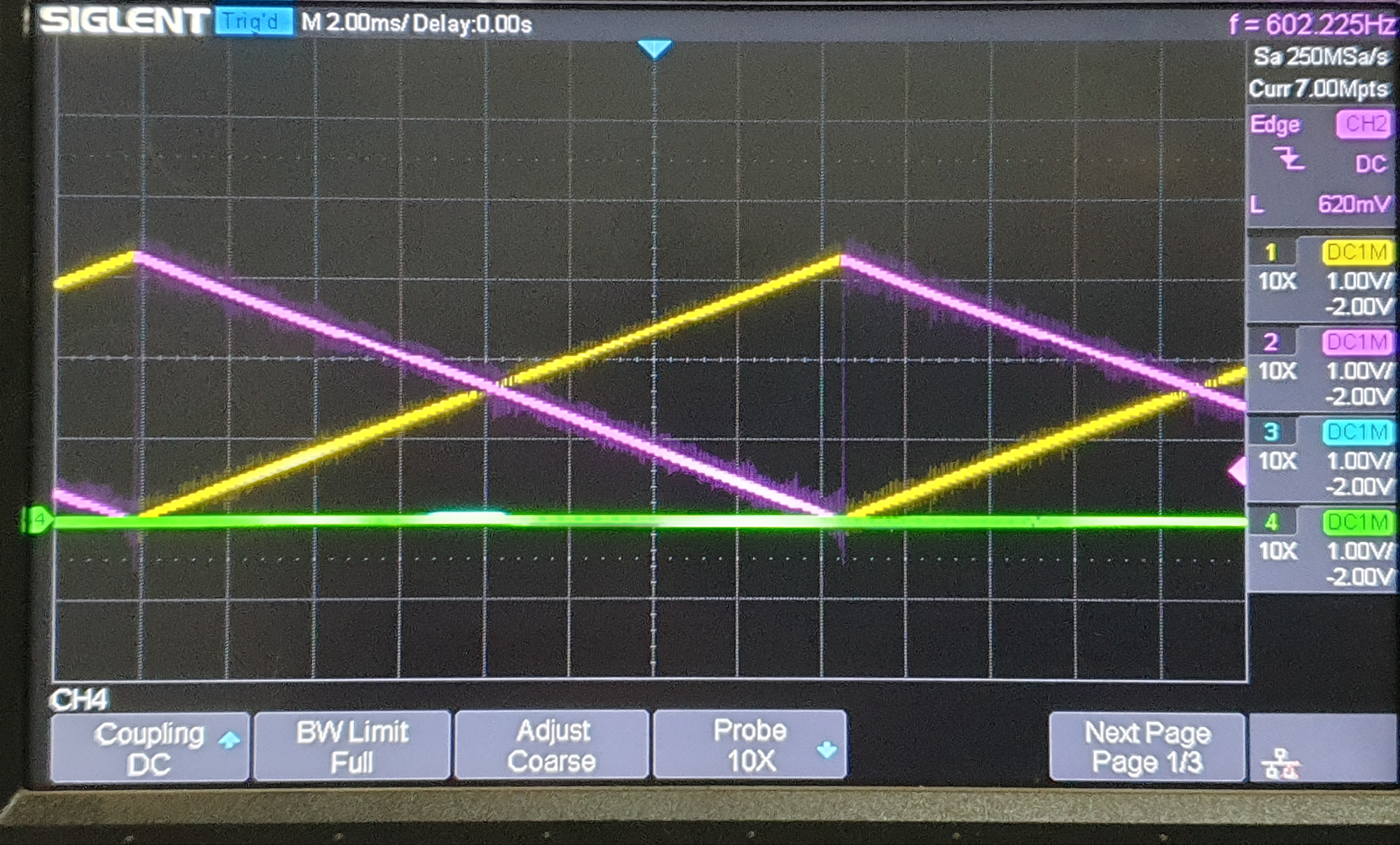

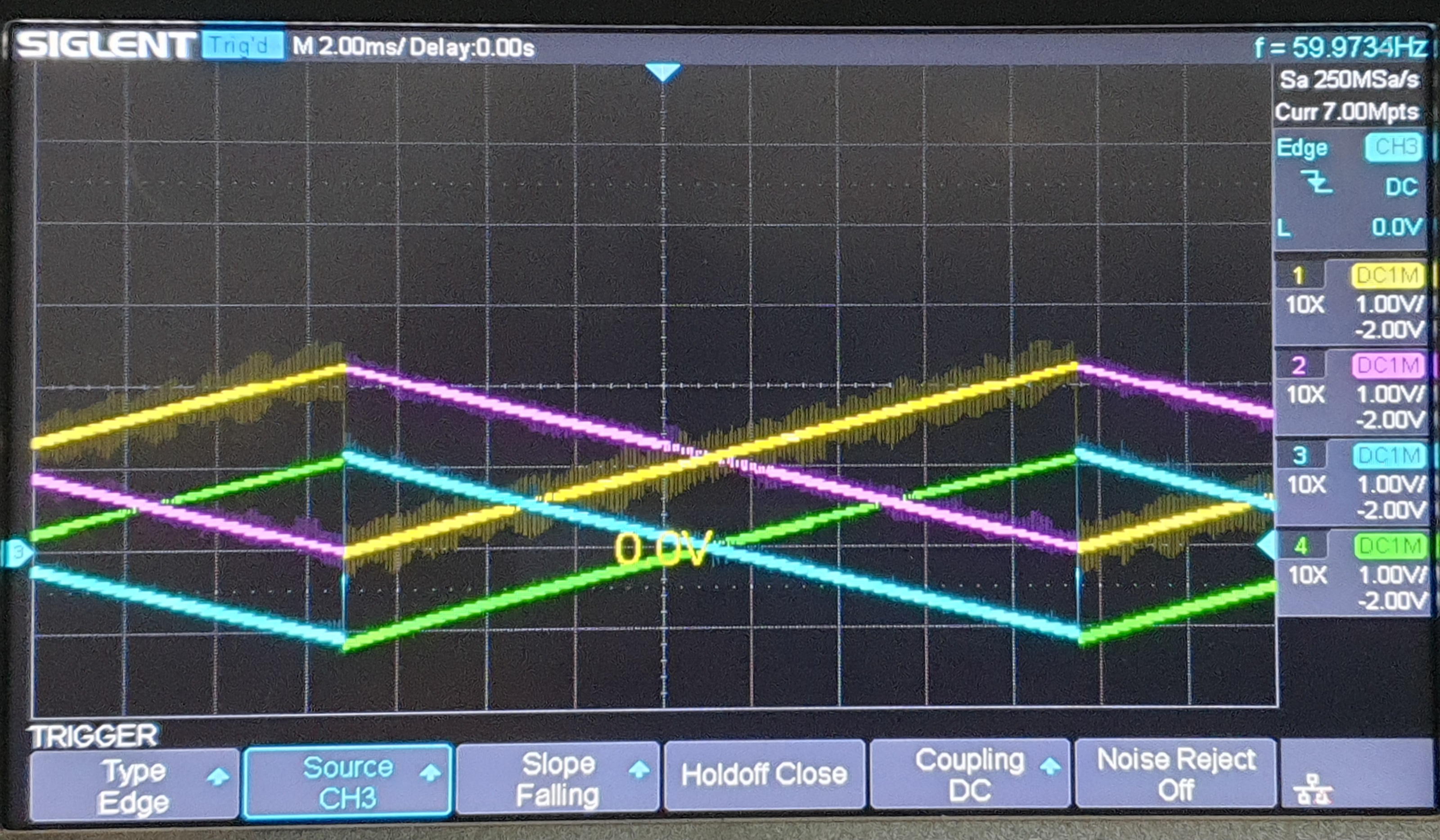

How do I do it? I'm stumped (because I don't understand analogue signals at all).
I have a 0V to 3.3V analogue signal that I would like to convert to an audio line level -1V to 1V signal.
This thing above. It's just a 600Hz saw tooth generated by feeding an 8bit counter into a MAX5102 DAC. Let's say yellow is the right channel. And pink is the left channel outputting the inverse. Green is 0V.
I have an op-amp and an inverting charge pump and I think I should be able to use them level shift the 3.3V signal to at least -1.5V/1.5V. Optionally to also scale it down to two thirds.
Is an op-amp the way to go? I can run it at +ve VDD -ve GND using the charge pump but all I've succeeded in doing is clipping the signal rather than offsetting it into the negative. I've searched the internet for op-amp tutorials and calculators but none have taken a -ve virtual ground into account. And I really do not understand op-amps.
How do I do this? Any help would be most appreciated thanks!

What you have there is a triangle wave. A sawtooth wave is like this, with a vertical edge:
It is extremely rich in harmonics compared to a triangle wave.
For getting the output centered around 0V, all you need is a series DC-blocking capacitor.  The value will depend on the load.  If the load itself doesn't bleed the capacitor down, a bleed resistor from output to ground will do the job.
Since what you're starting with spans 3.3V and what out want to output spans only 2V (ie, -1 to +1), you could do a simple voltage divider with no op amp and no power-supply conversion if you know the load impedance with reasonable accuracy.  Do you know what it will be?
So the whole job may come down to nothing more than a capacitor and a resistor or two.

He does actually have sawtooth waveforms there on channels 1 and 2 (yellow and purple). One is just the reverse of the other.

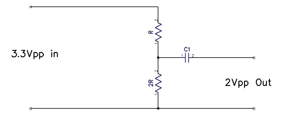

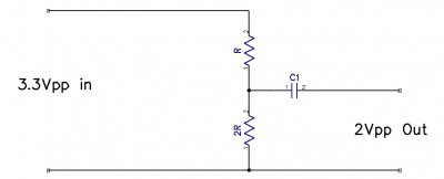

Here is sort of what you need:
Ah—Right you are.  The vertical lines just don't show, for whatever reason.  I would have expected a DSO to fill them in.
I'd recommend putting the capacitor before (to the left of) the resistors, so the driver doesn't have to drive the DC offset into the resistors.  Also, the load impedance will affect what the resistor ratio and values should be.  The load impedance and R2 (ie, the bottom resistor) will combine to make the bottom portion of the voltage divider, meaning the output voltage will be:
      3.3V * ( 1/(1/ZL+1/R2) / (1/(1/ZL+1/R2) +R1)
The ZL, ie, load resistance, can be complex (ie, have a capacitive or inductive component), and as long as complex-number arithmetic is used, the equation will still work correctly.  The equation assumes the capacitor value is sufficiently large that we can ignore its reactance at even the lowest frequency of interest.
They are there, just difficult to se. The channel that is active in the control group is the purple one, so it's going to be "on top". Unfortunately it's much harder to see than the yellow.
Edit: It would show a lot better if he did a proper screen capture too.

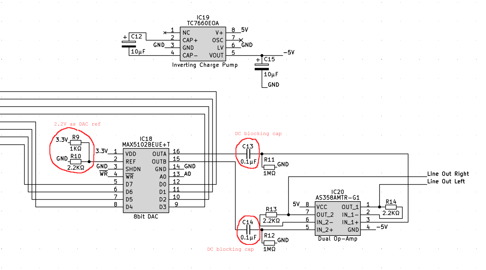

That's perfect thanks! In the end I used a 0.1μF MLCC cap (because it's the smallest I have but I suspect smaller would be fine [EDIT] - a 0.01μF MLCC cap was not fine). And I also needed a 1MΩ bleed resistor, anything smaller caused the signal to 'warp'.
I changed the DACs reference voltage from 3.3V to 2.2V and that gave me a suitably scaled analogue output signal.
However plugging the output into my amplifiers Line In dragged it's voltage to zero. I tried a bigger DC-blocking cap and another MΩ resistor in series after it but that just gave me a rounded signal that still went to zero when plugged into the amp.
In the end I brought the op-amp back again and used it to buffer my signal giving me a final schematic:
and a signal (into the speaker amplifier) of:
The blue and green traces are the level shifted outputs and seem to remain pretty stably centered around 0V.
BillO wrote:
Here is sort of what you need: ... Of course! But I did say "sort of" 8)
Thanks BillO! In the end I just poked roughly valued components in until I got a decent signal :D
(Oh, the oscilloscope is not drawing the vertical saw tooth line nicely because I left the scope in 'dotty persistent' mode rather than line mode.)

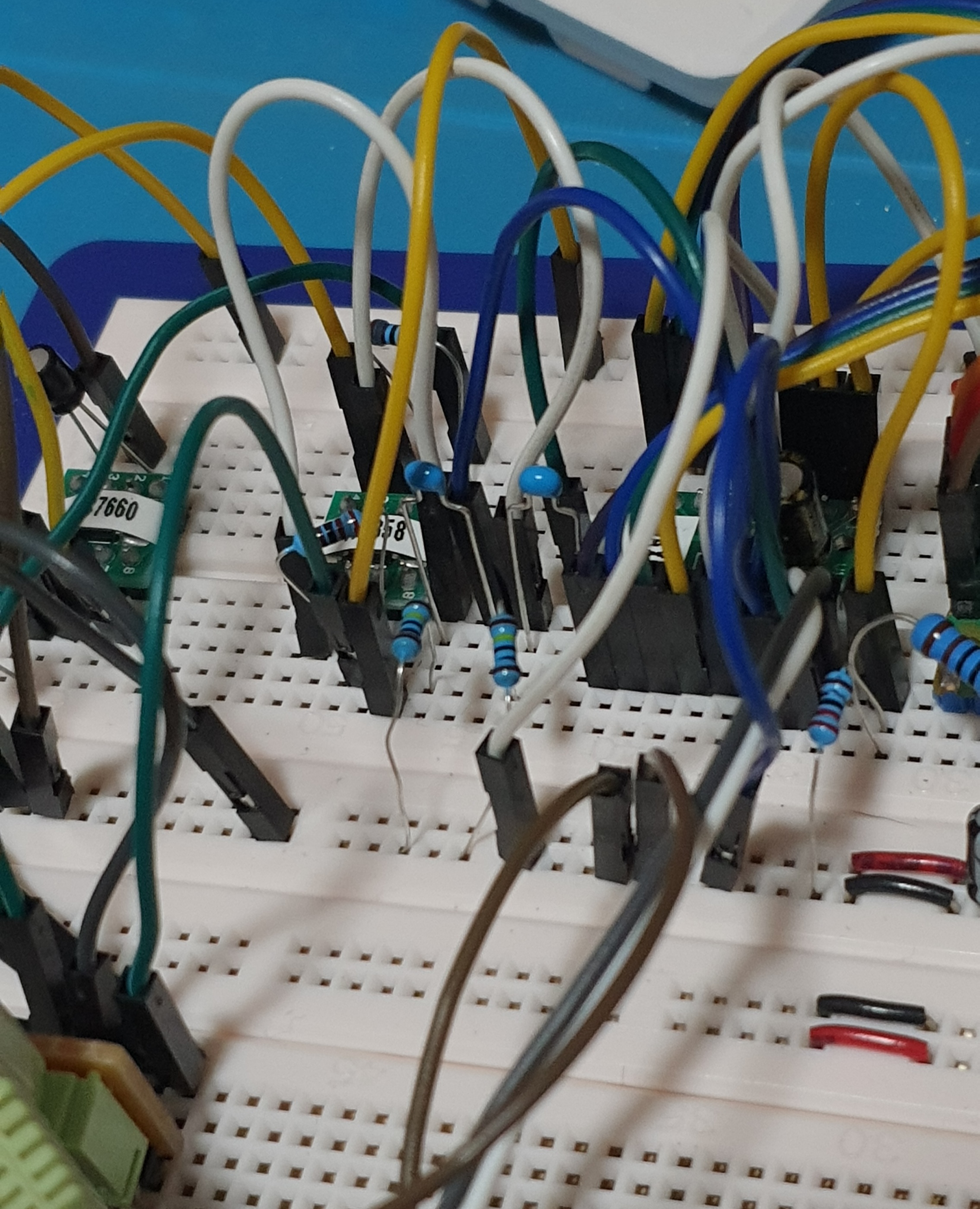

And no post is complete without the messy breadboard, the MAX5102 is hidden behind the mass of jumpers on the right

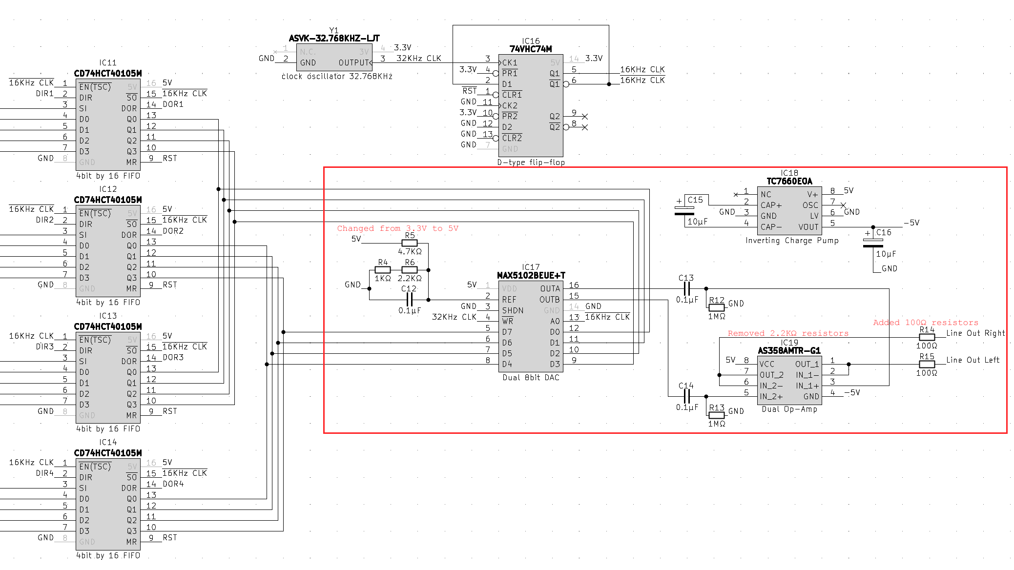

Tell me what you want to drive with this circuit, and I can probably get you fixed up. You generally won't want your R13 and R14, but rather just make those hardwire connections; but depending on the load, you might need an output resistor or 100Ω or so.
Thank you muchly. I think this is it. I want to drive any standard audio line-in device.
I've made the changes you suggested and if using an op-amp is not a bad way to deal with the impedance matching issue then I think I'm done. Both the op-amp and the charge pump are so cheap that, even if overkill, I don't mind using them. If not right then any more suggestions would be most appreciated.
At a slightly higher level what I'm trying to do is create a generally useful digital sound device. Something that could be easily interfaced with anything that can output an 8bit signal.
To do that it's almost as simple as four 74HCT40105s sitting on the data bus*. Their outputs are ticked at a constant 16KHz (for 16Khz 8bit stereo sound) and fed into the MAX5102. In my case I have a 2KHz NMI derived from the same 32KHz clock that ticks the '40105s which I use as a general watchdog / OS timer thing. As long as I can feed two times 8 bytes into the '40105s every NMI then... sound.
I've marked the changes I made in red but I forget I also added a bypass cap between the MAX5102 REF and GND (suggested by the datasheet).
That's intentionally a VHC flip-flop. At KHz speeds it should handle 3.3V VCC just fine - and I have a few knocking around that I picked up for something like a US cent each.
*Address decoding sold separately
[EDIT - I just realised the 10μF cap between -5V and ground is backwards. Ground is relatively positive here.]
I think you'll still want to look into whatever it is you want to drive.  "Standard" input devices, like an amplifier's line inputs, used to take much higher voltages than you're going to be outputting there.  When I worked at TEAC, .316V RMS (ie, SQRT(10)/10, for -10dBV) was considered line level for the high-impedance audio stuff.  Much of the high-end home-audio industry shared this level.  .316V RMS is .894V peak-to-peak (which I'll abbreviate Vpp) for a sine wave, so if you add 20dB for headroom, you get 8.94Vpp.  That amount of headroom is kind of a minimum for music; but if you only have 8-bit samples, you'll probably have a fair amount of dynamic compression, or at least a lot less dynamic range, making life a little easier in that department.  These devices usually (but not always) have/had input gain adjustment knobs, so hopefully you could bring your weak signal up to the desired level.  (However, a higher level helps get over the hums and other noises that could couple in from cables and less-than-ideal ground schemes.)
Back in the day, I've seen even phono cartridge pre-amps that could put out 40Vpp.  Studio and high-end audio stereo headsets are generally 300Ω per ear (so is our aircraft stuff), and generally need whatever drives them to be able to swing at least 10Vpp to get good volume without clipping on the peaks.  Ear buds' input voltages have come way down though because of power-supply limitations on the tiny battery-powered devices that drive them, so these are often 8Ω, getting the necessary power from greater current rather than voltage.  Someone mentioned professional studio equipment which regards +4dBm into 600Ω as line level, which is .775V (even though loads are usually much lighter).  [Whoops—See my correction in my next post, below. :oops:20dB of headroom would require being able to swing 22V.  30dB of headroom would require being able to swing 69V.  I doubt you're interested in professional studio equipment, so this is just some reference information for orientation.  Pro audio was one of my intense interests in the 1970's and early 80's, and I got a useless degree in recording arts technology.
There are so many op amps and D/A converters on the market that it's impossible to be familiar with a significant percentage of them.  I've taken a quick look at the MAX5102 D/A converter, but I can't take the time to really dig into the details.  If the output voltage swing is adequate for what you want to drive, just put a series capacitor on the output, with a bleeder to ground out the output from that capacitor so the final output will be centered on 0V, and omit the 358 op amp.  The D/A apparently has internal rail-to-rail op amps at the output anyway.  I would still put a 100Ω resistor in series with the output capacitor as I mentioned earlier.  It's possible the internal op amps could handle a lower-value resistor ok and remain stable regardless of what load is past that; but 100Ω is low enough that it won't have any significant effect on any active circuitry you might want to drive with it.  If you do leave the 358 there with a charge pump to supply the negative voltage, you might want to consider the charge pump's operating frequency (10kHz typ for your 7660) and the PSRR (power-supply rejection ratio) of the 358 at that frequency and see if there could be irritating effects of beating with your sampling frequency and intended output signals.
And speaking of the sampling frequency:  The maximum audio frequency you can get with a 16kHz sampling is below 8kHz (the Nyquist frequency), which is a lot better than many people think, but if you don't have some sort of output anti-alias filtering, the images above 8kHz resulting from aliasing could have some strange effects.  For example, frequency content at 5kHz would also show up at 11kHz, frequency content at 6kHz would also show up at 10kHz, etc..  It's hardly a concern at the lower frequencies though, for a couple of reasons.  The wikipedia article has an audio demo at https://en.wikipedia.org/wiki/Aliasing#Audio_example .
