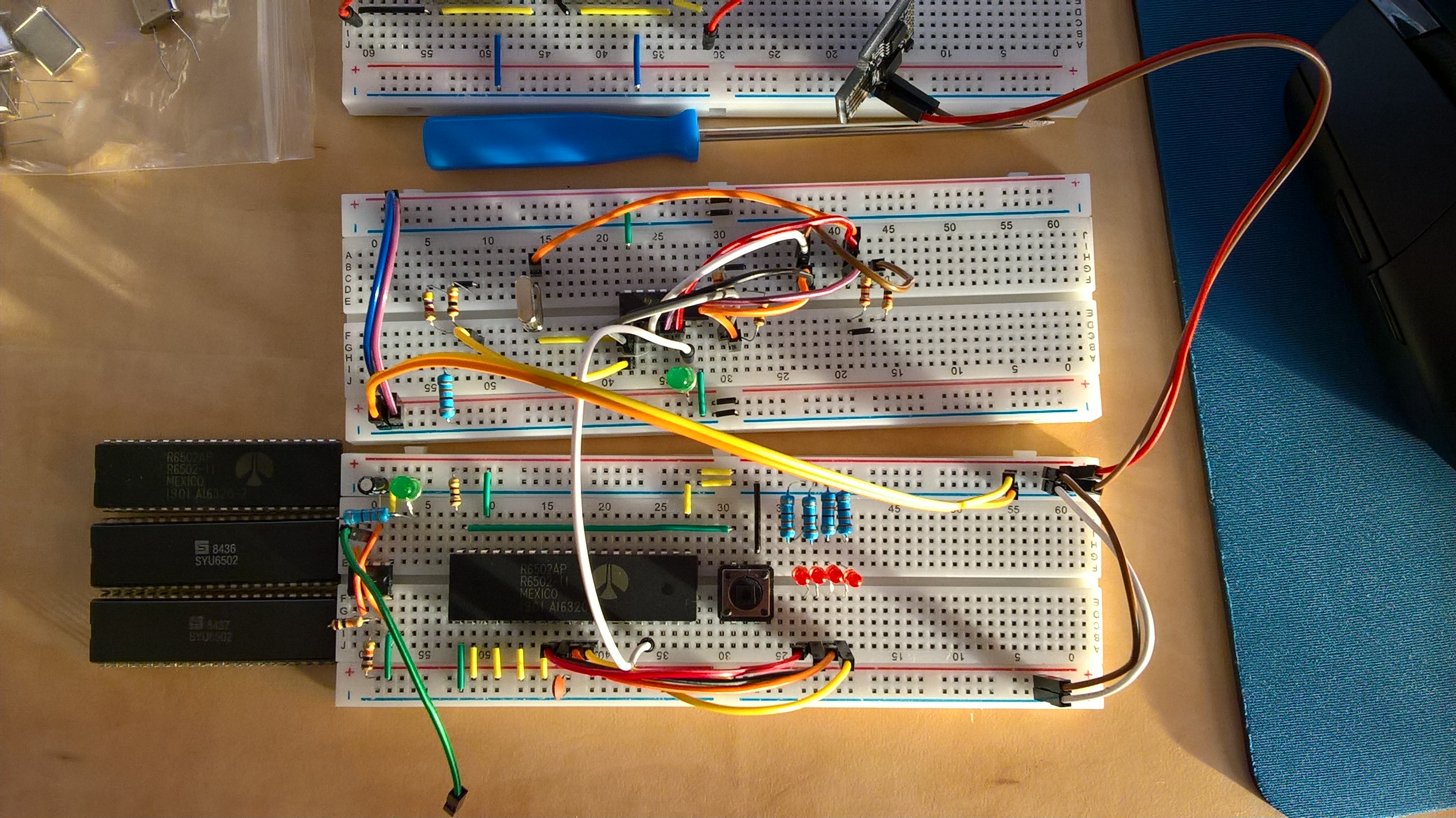

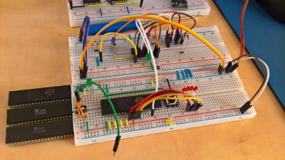

Dear community,
I bought a few 6502 CPUs on eBay. I have two 6502 units by Rockwell and two by Synertek. I have hand wired the CPUs and tried them with 555 timer, but later I found out that the pulse from 555 timer is not fully compatible with 6502. I know, that Synertek CPUs had built-in clock generators, so I have tried these CPUs without any external clock generator. Unfortunately I didn't get any result, any of LEDs connected to 16-bit address bus didn't shine. I have also tried connecting data bus to ground and 5V with 1k resistors to simulate RAM. So then I connected crystal oscillator circuit according to R6502AP datasheet. (see attachment) Synertek CPUs did not show up any artifacts of life, however, both processors have warmed up slightly. One of Rockwell 6502AP units, connected with CMS 1.8432 MHz crystal circuit, showed up some artifacts of life, a few random LEDs were shining. Other LEDs began to light up after the reset, but they never shone all. I expected every LED to shine. What could be wrong? Crystal generation circuit and connections in general should be okay.
Is it possible that all of these processors are defective? Can I ask for refund?
Thank you in advance.
Nogard

You don't have any clock input on the processor, which has to come in on pin 37. Even if you use the onboard oscillator, it needs external passives to control the frequency, even if it's just an RC. See the clock-generation page of the 6502 primer. It covers all this.

First of all, your two Rockwell chips are probably counterfeits. The date code on both is Week 01 of (20)19, long after Rockwell ceased to exist as an independent concern, never mind stopped making NMOS 6502s. This is commonly seen from Chinese eBay sources; they really like Rockwell branding but some show up with counterfeit WDC markings too. They *might* still be working 6502s, but at the very least the markings have been changed on them, and you should ask yourself why.
The two Synertek branded chips look more likely to have original markings on them, as they have date codes from roughly August or September 1984, consecutive weeks. In other words, they're more likely to actually be what they say on the box. It's probably worth trying a little harder to get these working.
When wiring up any chip, you normally need to connect all input pins to something, otherwise they'll float around and cause digital havoc; output pins can be left open-circuit if you don't need them. On a generic 6502, that means the /RST, /NMI, /IRQ, /SO, BE, Phi0 (marked Phi2-in by WDC), and all eight of the data bus pins (that's from memory; I might have forgotten one or two). The data bus should be set using resistors, not wire shorts, because they can also be outputs some of the time. Pin 1 should be left open-circuit; it's marked Vss or GND on some 6502 variants, but /VP on others.
The term "built-in clock generator" here means that you can connect a crystal and a couple of other components, or an RC tank, between two pins to generate a clock. It's easier to use a canned crystal oscillator, which is not what you've got, but a plain crystal wired up in a circuit - another potential source of failure.
I'll let other regulars guide you from here…
Please try to look closer, the wire goes directly from clock circuit to the pin 37 on the CPU.
The thick white wire? That's going to the complete opposite corner of the CPU to where the Phi0 pin is. Take note of where the notch in the end of the chip is - that marks which end pins 1 and 40 are.

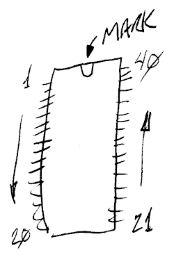

See the little half-circle on the left end of the 6502? That marks the end with pin 1 and pin 40. You have it going to the wrong end. The pin-1 mark is normally on the left when the printing is right-side-up.
You are right, I am sorry. OMG I am so stupid, I messed up the direction of pin 37. I hope, that other pins are connected right. According to the new testing, one of Synertek 6502 CPUs works. Both Rockwells are probably fakes. Thank you so much for this note!

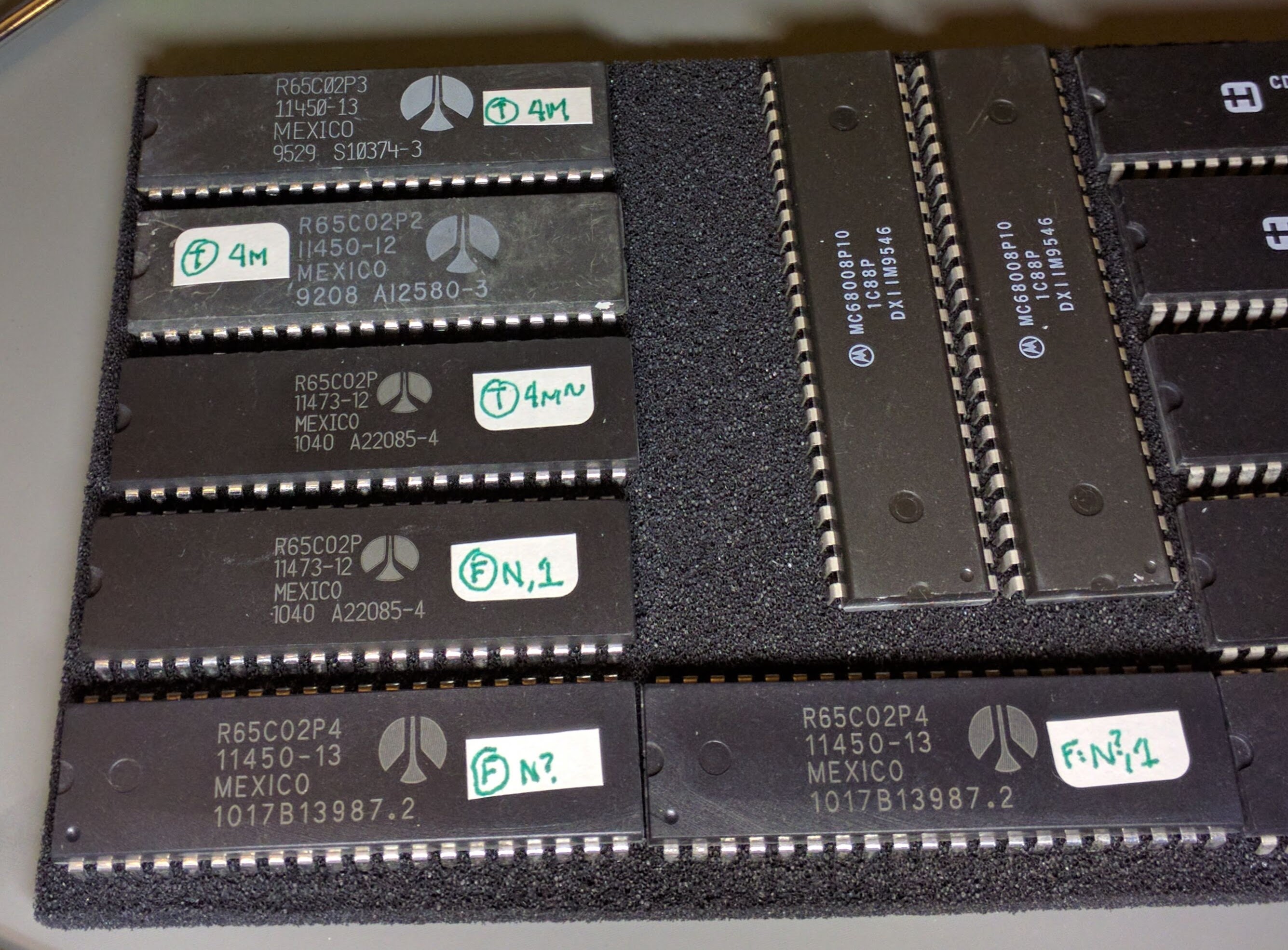

So I tested (just with NOPs and an ammeter) the rest of my 6502s (except for the ones in computers), and it was interesting.
  • The R65C02P3 and R65C02P2 at the top draw about 1.3 mA, and even at 4 MHz the clock output and A0 are quite clean. (Adding a bypass cap at the Vcc input did help all the CPUs quite a lot. :-P) Date codes are 9529 and 9208; both are clearly well-used chips, no doubt pulls from something.
  • Of the two R65C02Ps below that, both look identical (the slight difference in colour in the picture is due to the lighting) and have exactly the same markings, both in the numbers and the font/logo. But the upper one draws 3.7 mA and has clean edges even at 4 MHz; the lower one draws 102 mA and the Φ2 rising edge starts to get slow at 2 MHz, becoming useless at 4 MHz. (I tested both twice, because I at first thought I must have confused a chip.)
  • Of the two R65C02P4s at the bottom, side by side, the right-hand one is the one I tested earlier, and the left-hand one tests out the same: they draw around 100 mA and Φ2 again goes downhill at 2 MHz and is terrible at 4 MHz.
The interesting thing to me was that the two middle ones I suspect came from the same source and they look like they were remarked by the same vendor, yet, at least by power usage, one is CMOS and the other isn't. I guess they just dump massive batches of "whatever 6502-type things" into their remarking line and mark them all the same, even if they're possibly better than what they're remarking them as.
Ergo any Rockwell 65C02 with a date code later than 1999 IS A FAKE.
Or at least re-marked, I'll believe. But there's no way an NMOS device pulls only 3.7 mA, as far as I know, so that third processor down, with a 1040 date code, is some sort of CMOS 6502. The lottery is subtle!
It completely baffles me why folks insist on purchasing 65xx MPUs from eBay. The excuse about price doesn't wash, as the genuine article is worth more than the one or two dollars being charged....
Well, no, it's not. (Or, at least, is only sometimes worth more.) An article is worth what someone's willing to pay for it given full knowledge of what it is. And for my playing around a 6502 of any kind is worth about $2, whether it's an old 1 MHz NMOS CPU or a brand-spanking-new 14 MHz W65C02. Either one is fine for the little projects I build (or at least am currently building or anticipate building this year).
That said, it is sad that one does have to understand that parts get remarked or have a bad experience like Nogard did above. But that's really just a part of building hardware, it seems to me. There's a reason that system vendors carefully qualify their vendors and the parts they receive, even when not buying from cheap and dodgy distributors.
