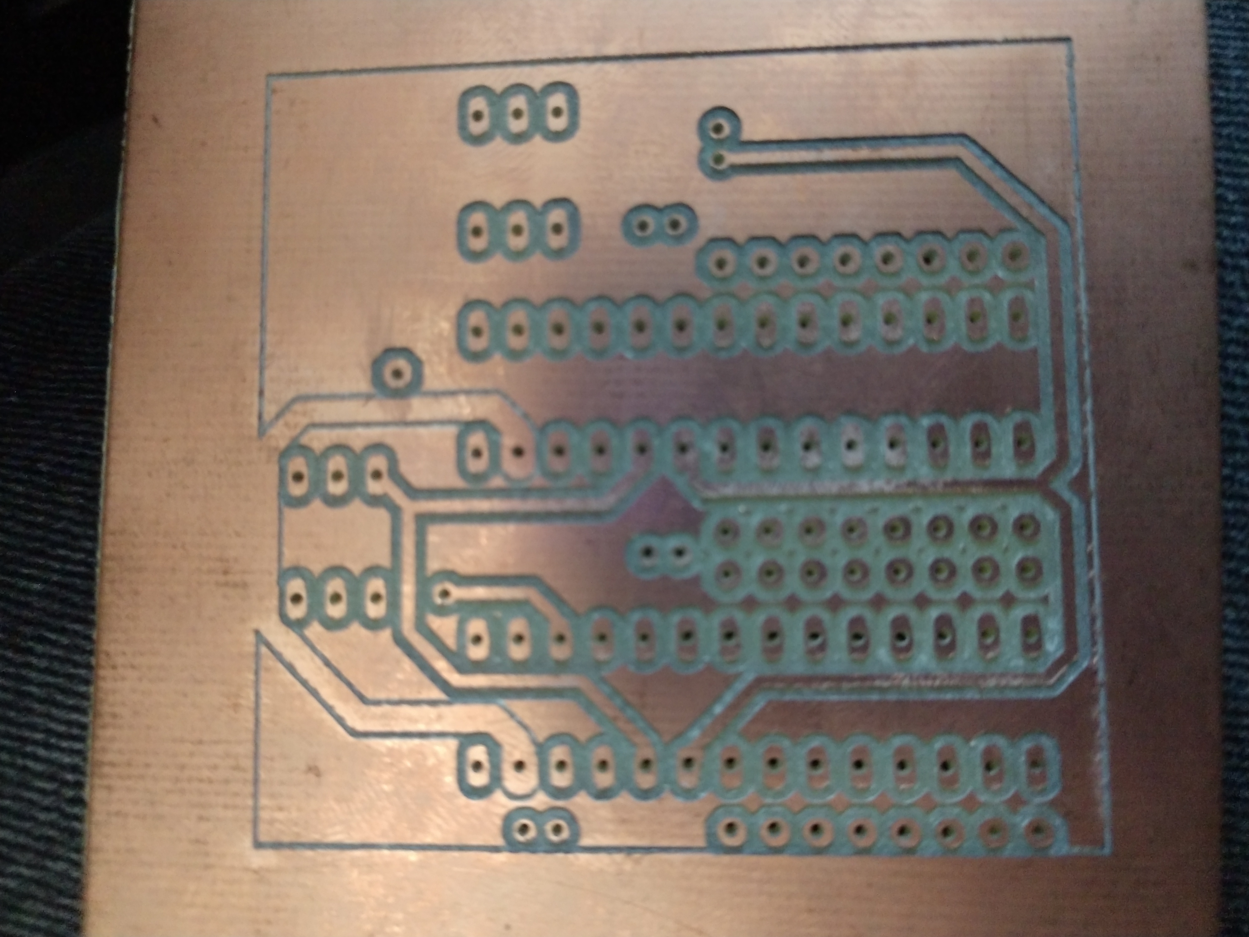

    I have a small CNC router that I've made double sided boards with before, will I be able to make a double sided board with it for this (it does through hole pretty well, but struggles on super small traces, I'd say resolution goes down to about 0.2mm) ? I'd like to do it this way instead of going to a fab just for the fun of it (I'm using KiCad and FlatCAM for my CAD/CAM stack)

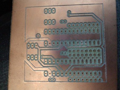

I'll be very interested in seeing your results - last time I saw some CNC routed PCBs the quality was somewhat lacking and trying to get a track between 2 IC pins was not possible...
PostPosted: Fri Jan 25, 2019 3:30 pm
Posts: 346
Location: Knoxville, TN
There is some effort that has to be put into the setup of every PCB (levelling with a software that will edit GCode on the fly) if you put in the effort, and use the correct bit and feed rate, you can get very high precision results. Generally, since my machine is sort of cheap, 0.2mm is about as low as I can go, and for most boards I shoot for 0.4-0.6mm. It works great with through hole components like DIP sockets, the only issues I've had so far are with SMT devices. I've attached a picture that I just took of a failed board I had laying around (this was early in the process of making PCBs, I keep the failed ones around though to remind me of particular failures) so you can see the resolution
EDIT:
I forgot to mention, this was also with a previous CAD/CAM combo that got a bit lower resolution. Getting tracks between ICs is difficult, but I have a board laying around somewhere showing it can be done, if I find it I'll take a picture.
Additional EDIT: I meant between IC pins, rather than between ICs, ultimately though, I do try and avoid going between pins unless necessary, because the difficulty is fairly high and the yield of good boards is low even with good setup. Same for putting vias under chips, because soldering small wire to connect both sides can cause the chip to not seat.
EDIT:
Thanks for that. I have worked in very high precision CNC mill, etc. environments in years past where it might have been relatively easy, (with mills costing a 6-digit sum) but I just wasn't sure about the "home" type of mills that seem abundant these days.
As for vias under chips, well... :) On that board of mine there are resistors and decoupling capacitors under some of the ICs. You just need sockets without too many internal webs to make sure there is space... And note the memory ICs are vertically stacked too - just need to get a bit creative...
You might find issues connecting the chips up without going between IC pins though - especially going 6502 to 6522 - the 6522 is just ... hard, or designed to be mounted on a pcb vertically rather than horizontally as mine is. So on mine, the output pins are on the left of the chip, so have to go through (or round) the 6522 and the data/address lines are on the right, so again through or round....
Do read Garths stuff here though - but you might know some anyway - in particular you don't actually have to wire d0 on the 6502 to d0 in the ram chip, same for the address lines into the ram - that can make routing easier sometimes. My board puts this to good use.
