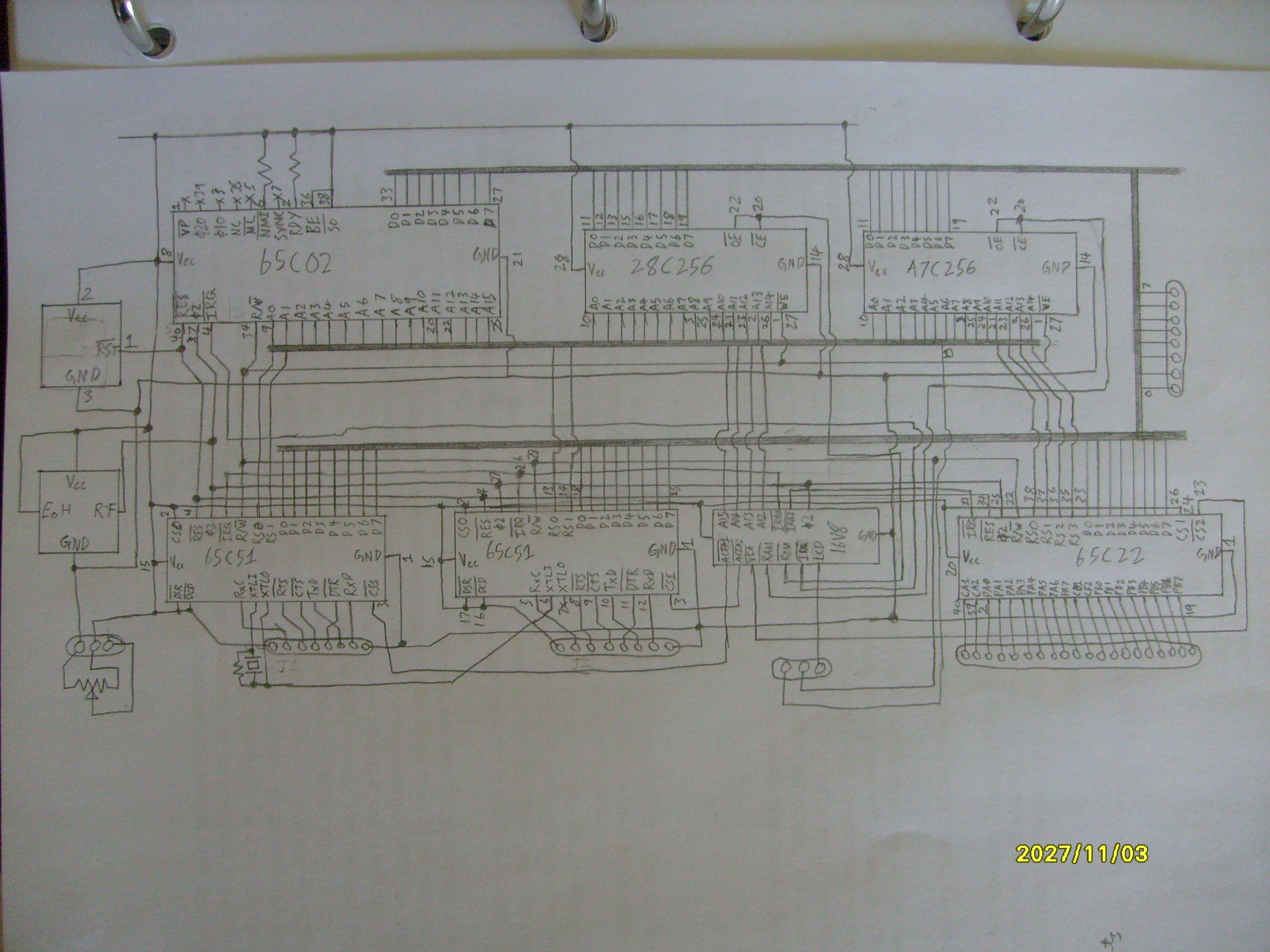

I've gone and put together a computer, and I'm starting to write test programs for the various parts on it.
This VIA test program should count upwards on port A, but it isn't doing so.
This is the code I'm using(hand-assembled):
;The VIA is at $6000
LDA #FF           A9 FF
STA  VIA.DDRA     8D 03 60    ;Set the VIA's port A to all outputs
LDA #00           A9 00
STA  VIA.ORA      8D 01 60    ;Set the VIA port to all low
INC  A            1A
BNE  -2           D0 FE       ;This is supposed to be a delay loop; at 1 MHz, it should produce enough delay to see the count rise on the LEDs.
                               ;The branch displacements are determined by starting at 0 on the branch operand, and counting backwards to the first byte of the desired destination instruction.
INC  VIA.ORA      EE 01 60
BRA  -7           80 F9    ;Branch into the waiting loop
I have tested that the 'C02 works, by pulling everything else off the board, wiring the data bus to $EA, and then watching A15 using an LED.
I have also tested the connections on the board with a multimeter, and they trigger the continuity beeper, so that's not the problem either.
The way I see it, there's two options: I could have done something wrong with the program(the BNE springs to mind), or the VIA could be a dud.
Have I done anything wrong here?

The branch operands are relative to the first byte of the next instruction; so B__ 00 is a two- or three-cycle NOP depending on the flag you're using as the condition.

I implemented that tweak, and did start getting results out of the VIA, but they're somewhat weird.
I changed the program to repeatedly write $FF to the port. Sometimes the lights don't come on, and sometimes they're dim, and often I can affect them(all at once, usually) by twiddling or pressing the wires under the board near the CPU.
It's is looking to me like a construction problem.
This is confusing and frustrating. This seems like a really simple little thing for it to be doing, and it's just not working. Maybe I should give up for now and try getting one of the ACIAs online instead.

I've probably gone and done a bit of a silly thing by not drawing up a circuit diagram. I should probably do one now, given that the design is not likely to change much.
Also, all I have in the way of equipment is a DMM. Unless you count an LED on a breadboard with a flying lead.

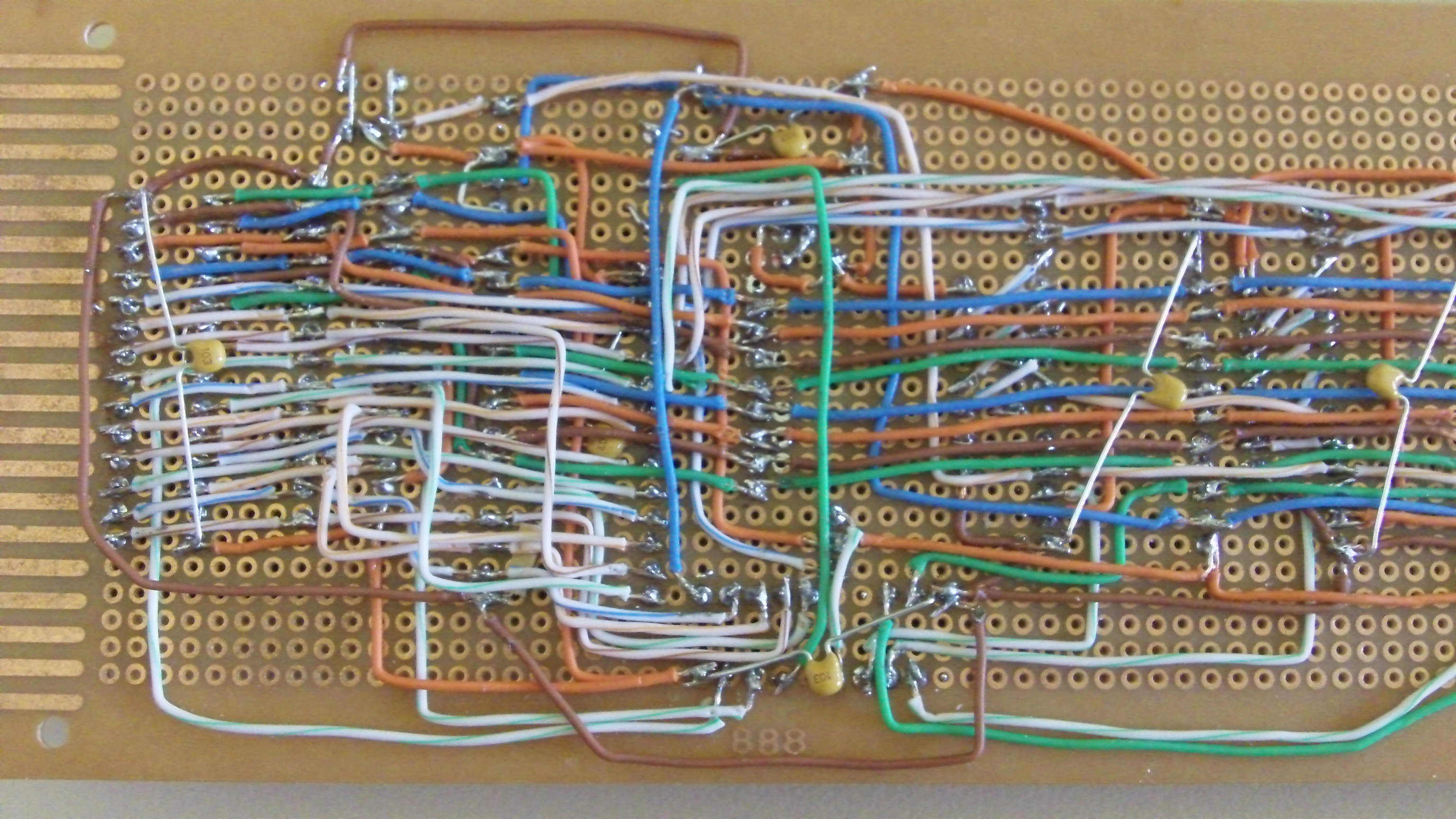

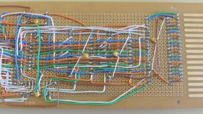

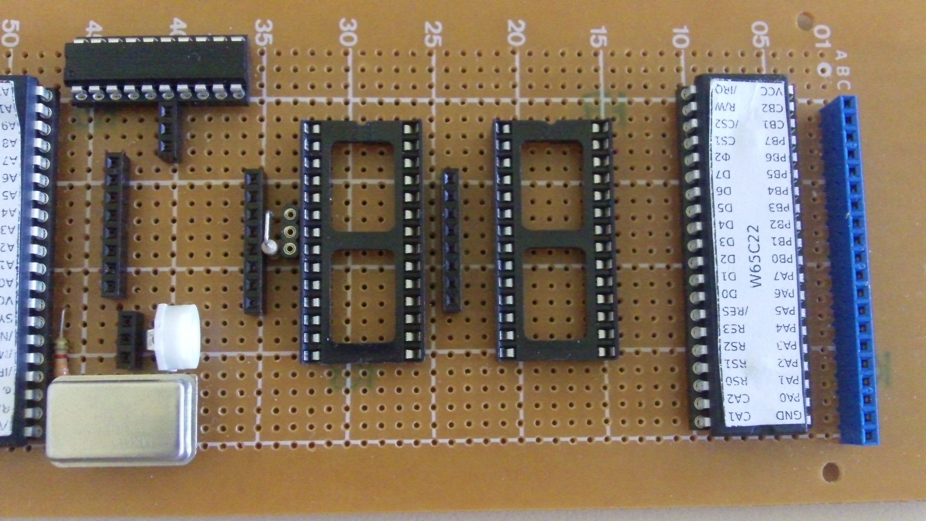

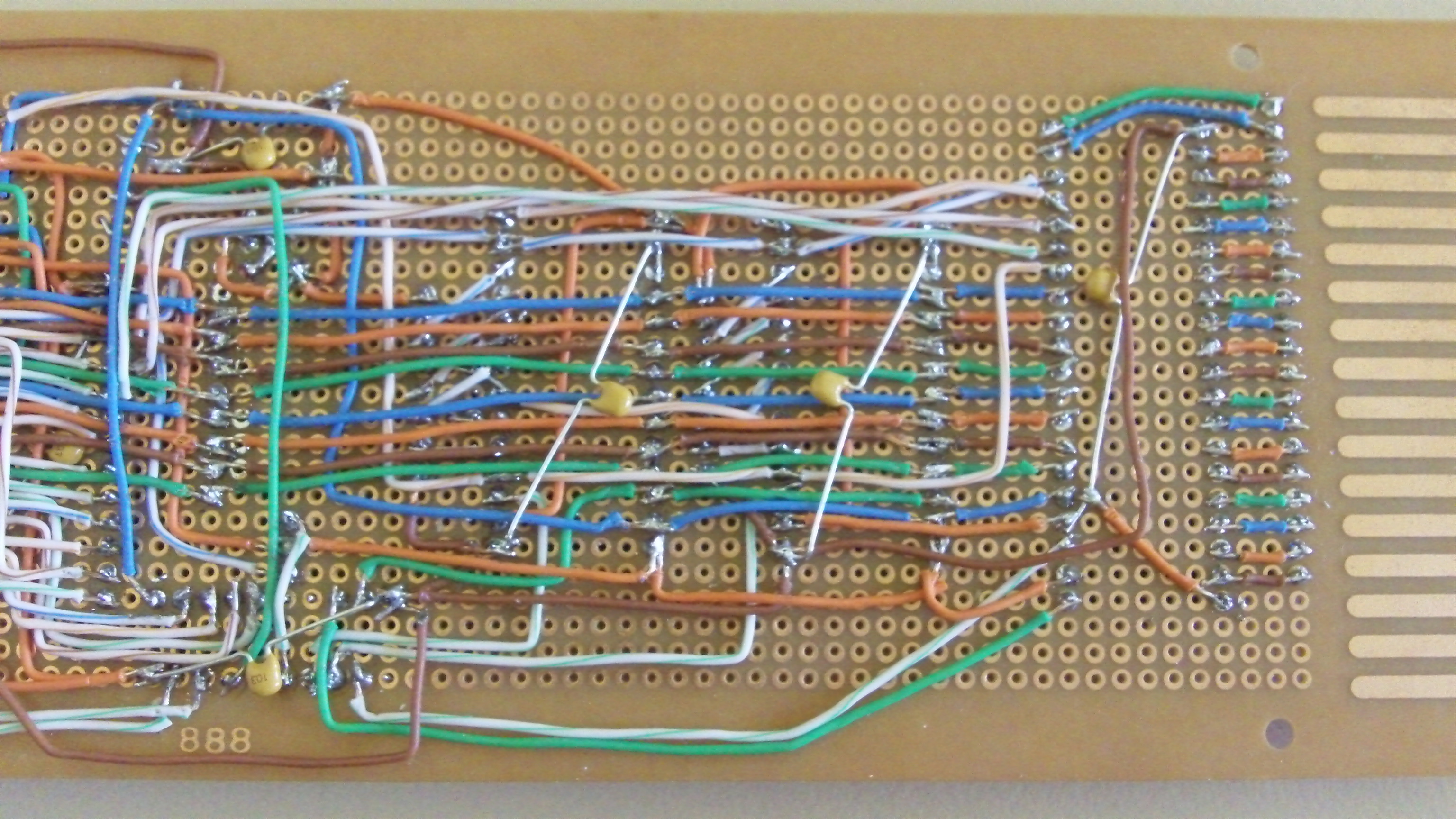

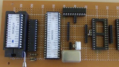

Anyway, I've attached some photos. They're only about half the board each, because the camera I'm using goes fuzzy if I try to get the whole thing in frame.
Judging by what happens when I press there(and the fact that it doesn't seem to happen anywhere else), I think that the fault is in the mass of wires pictured in 133_0613. I tried connecting my DMM(in the continuity range) to the legs of the chips in the sockets, and pressing wires and wiggling the board. The beeper stayed solid the whole time. This is the sort of test that I would expect to reveal such a fault, and it seems to deny the existence of said fault. That's why it's frustrating. I did catch one of the VIAs register select lines that had come unstuck, but I've since re-soldered that. I've also tried re-soldering several other wires that had suspect-looking joints(grasping at straws, I suspect).

PostPosted: Sat Nov 19, 2016 8:52 am
Posts: 10977
Thanks for the photos! Looks nice.
With your LED, or your continuity tester, it might be worth walking around all the pins, checking for shorts on any two adjacent pins.
Having checked for shorts, the next step is to test for opens - visiting each bus and control line in turn and checking all the drop-off points are indeed connected.

PostPosted: Sat Nov 19, 2016 2:10 pm
A diagram is very important, and I encourage you to create one. If you're feeling a bit lazy you can omit some of the more obvious details, such as connections for the data bus. You still need to *check* those connections; I'm just saying that in the schematic they don't necessarily need to be drawn in painstaking detail.
The drawing helps us as well as you. We can guess how the data bus is connected because it's so predictable. But almost every other connection needs to be declared. This will help avoid questions such as the following:
What's the white object next to the oscillator -- a potentiometer? What is its function? Also, I don't notice any RC reset circuit for the CPU. Is it merely hidden, or has it been accidentally omitted? And have you tied off unused CPU inputs such as SOB etc? (Garth talks about the "mystery pins" here.)
DerTrueForce wrote:
Judging by what happens when I press there (and the fact that it doesn't seem to happen anywhere else), I think that the fault is in the mass of wires pictured in 133_0613.
The natural conclusion is to suppose something is loose, or being caused to bend. However, this behavior could also be caused by an input that's floating rather than being properly driven either high or low. The input impedance of MOS and CMOS chips is *very* high. That means the touch of your finger -- even though it has high resistance -- can conduct enough current to influence a floating input.
A floating input can result from a design error or a construction error. Either way, a wiring diagram will help you find the problem.

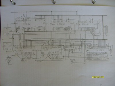

I finished the schematic this morning :) . I'll attach a photo, if I can get it to come out clear enough.
I also did the check for opens, and the board passed it. So nether check yielded anything out of the ordinary. No shorts where there shouldn't be, and no opens where they shouldn't be.
The white thing is indeed a variable resistor. It's for the LCD I plan to connect once the rest is working. There is no RC reset because I'm using a DS1813 for it. It's not in the pictures, but it sits in that 3-pin header between the RAM and the button.
Checking the board, I've tied /SO and BE straight to +5v, pulled RDY and /NMI to +5v with seperate 3.3K resistors, and left PHI2O, PHI1O, /ML, /VP, SYNC and NC unconnected. Would the proximity(not contact) of my finger cause a response, do you think? Because I was trying not to make electrical contact. It would also happen when I pressed on the board from the top, so I don't think that it was interference from my fingers.
I did end up melting the insulation and causing a short at one point. I stuck a bit of cardboard between those wires, because I can't replace them at this point. But I am being more careful now as a result.

Maybe it is time to build yourself some tools to better be able to diagnose your circuit.
A logic probe would be helpfull. You will find many circuit diagrams on the internet and they are cheap to build as they usually have only a few opamps, logic gates, LEDs and resistors. You would need one to detect high, low, high impedance (no driver) and pulsed signals down to 1/4 clock duration. At 1MHz for example you need to be able to detect a 250ns pulse.
Another helpfull tool would be a single step clock circuit. That way you can measure your bus and control lines in a static state. But that is only a second step if you fail to find the bug only with the logic probe.
