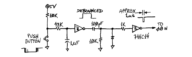

A circuit diagram made by you looking at your circuit as it is now is definitely needed as others have said - even if hand drawn and scanned in.
Also, it may be worth single cycling the circuit. I.e. instead of the entire circuit running at full speed, replace the PHI2 crystal with the following circuit:
The above is from Garth's website and is the fifth image down on this page: http://wilsonminesco.com/6502primer/ClkGen.html
What it does is generate a single 1uS pulse (a clock cycle) per click of a button. You can then use your oscilloscope to measure the buses/signal lines as needed to see if you are getting what is supposed to be there. I.e., the reset vector after reset, etc..
