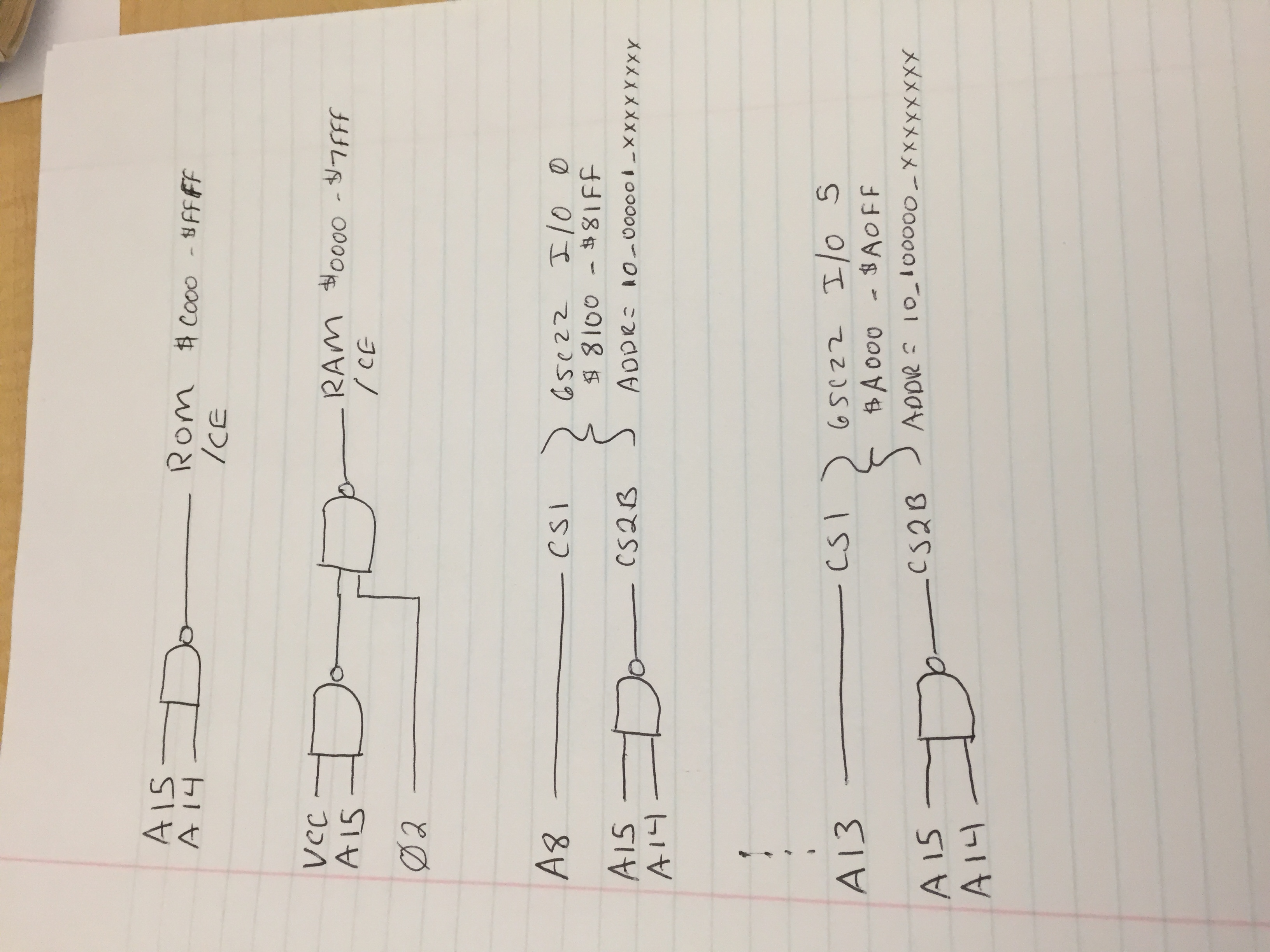

So, I think I finally have a more sane decoding scheme that isn't crazy or hard to build. I would love everyone's input.
I'm not at my normal computer at the moment so I can't upload a true schematic but I have attached a hand-drawn version.
The basic plan is 32K RAM, 16K ROM and 6 I/O devices. I don't think I really need that many. So I could shorten the list.

I like the idea of full page I/O because I plan on using a micro-controller as one of them and I need the 256 bytes for it.
Here is my *CRUDE* schematic:
So I'm thinking I would need 3 quad-input NAND gates for the decoding logic. One would be for RAM, ROM and one I/O. And another would be for four I/O. I could ditch the third one and "settle" for 5 I/O devices.
What do you guys think?
I haven't spec'd the part yet. But I have a few 74HC132's around. Top speed for the computer would be 1-2MHz.
Do you think the setup would work with an even faster clock? Say 4-8 MHz? I imagine I would have to use faster NAND gates.

Going into the NAND gates for the I/O select, you don't need to repeat it for every I/O IC. You can use the same one. What you do need to do though is invert the A14 before it goes into the NAND. However, what you have is pretty close to what's in the 2nd-to-last schematic of the address-decoding page of the 6502 primer.

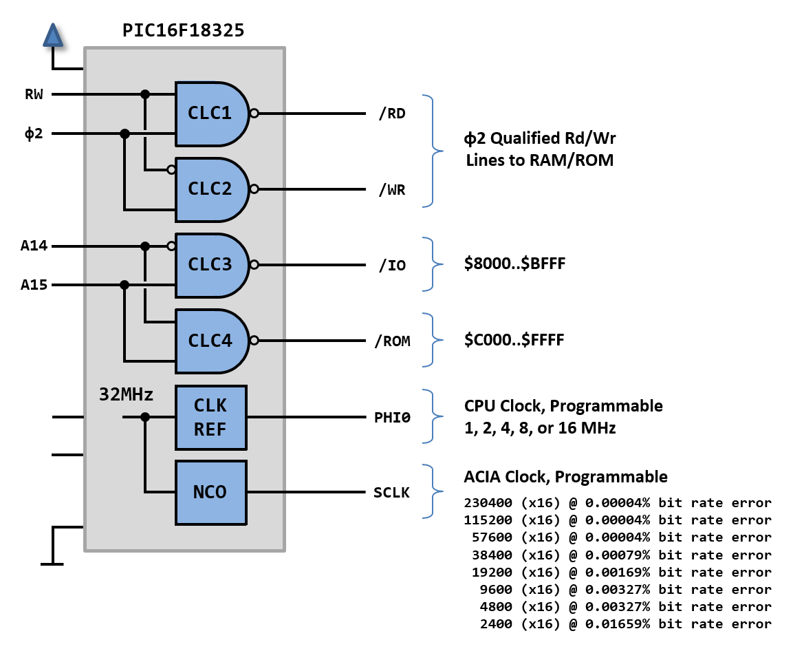

Would there be any advantage using ɸ2 qualified /RD and /WR signals instead of a ɸ2 qualified RAM select signal? You would use the A15 address line for the active-low RAM select ($0000..$7FFF). Also, if you think you might use an EEPROM and you'd like the capability to program it in-circuit, I think EEPROMs require mutually exclusive /RD and /WR signals, don't they? Please correct me if I'm wrong, guys.
I wouldn't mind trying this simple decoder scheme using the CLC (configurable logic cell) modules on a little 14-pin or 20-pin PIC.
AH yeah! That's much better. lol
I don't know what I was thinking. Anyway, I certainly can't take credit as I got the idea from the primer site. :-D
So I should be able to use only one NAND chip right? Even for all 6 I/O's? Plus I think I can invert A14 using VCC and one of the NAND inputs.
I'll draw up another schematic soon.

I wouldn't mind trying this using the CLC (configurable logic cell) modules on a little 14-pin or 20-pin PIC.
I'm not familiar with CLC in PIC's. Is that some type of low-level CPLD/FGPA functionality? That would be pretty awesome if it were.

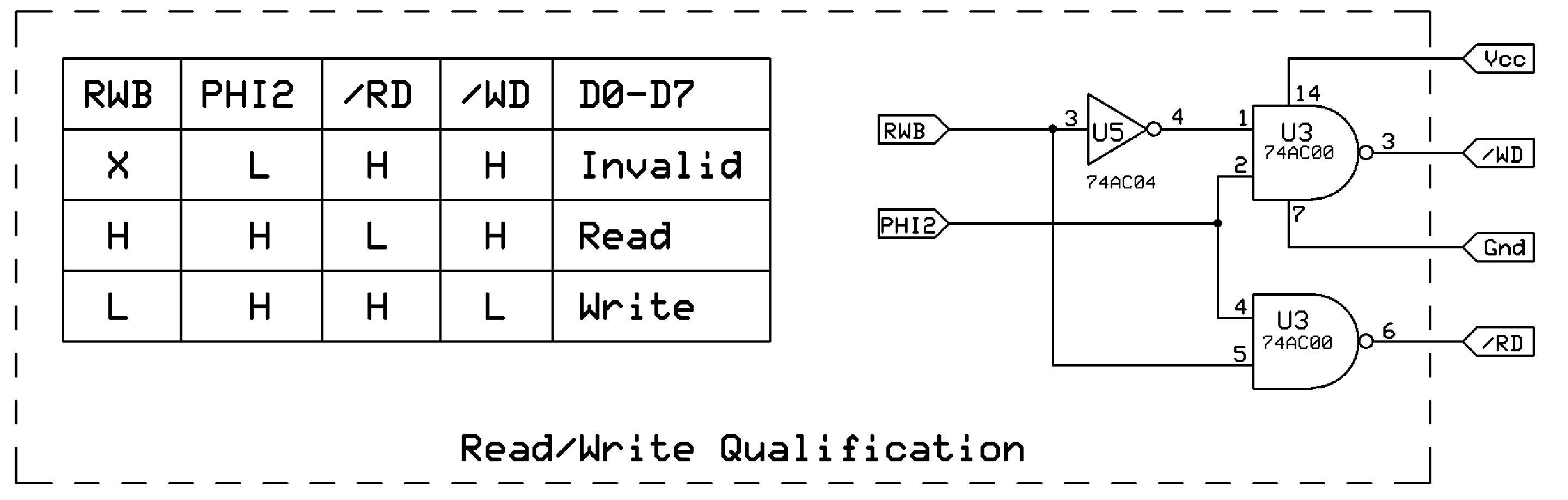

I would also recommend the idea of Micheal to have a master read and write signal that is connected to the OE and WE signal of ROM / RAM. These signals are also useful for non 65xx peripherals like the UARTs often proposed by BDD.
Here is the circuit I devised for POC V1.
File comment: Read/Write Generation

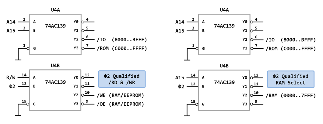

A couple single chip solutions come to mind;

Hi Micheal, I would rather not use the '139 to create the PHI2 qualified signals as the '139 is rather slow compared to a 74AC00 and due to the very short data hold time provided by the W65C02 and the required data hold time of normal speed RAM (55ns or slower) this could violate the guaranteed times for writes.
