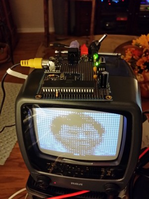

PostPosted: Wed Dec 03, 2014 4:17 pm
Joined: Sat Nov 22, 2014 6:49 pm
Posts: 36
Thank you for the kind words and interest in my project!
I finally found a workaround for the gap between pixels! I can now generate a stable 400x256 signal (50x25 chars).
Full battle report on my blog:
http://petenpaja.blogspot.com/2014/12/e ... ignal.html
I also received my WDC 6502s in the mail from Coltek UK today. So I can upgrade my computer to ran at 8 Mhz and get rid of the address line 74HC541 buffers. 8 Mhz probably does not run robustly on a breadboard tho, but it's nice to have the option when I rebuild this on a PCB.
The nice thing about this design is that the video chip (the ATmega1284P) and the 6502 can run at their own clock rates, as long as the ATmega is able to generate the necessary clock frequency for the 6502.
File comment: 400x256 PAL, black and white for now, bit banged using USART in MSPI mode.
