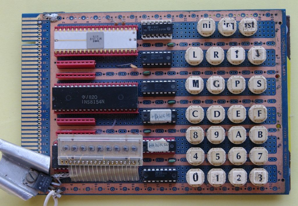

Hi Everyone,
I am planning to build a copy of the first micro-based system on which I programmed - it was an Acorn System 1 at secondary school in the UK in 1979. Details here: http://speleotrove.com/acorn/index.html
I aim to be as faithful to the original design as possible and most of the parts can be obtained fairly easily (except, see below). I am at the parts gathering and design stage and am pondering a few things for which I'd appreciate your input and thoughts:
    * Although I am doing this for myself, is there any interest from others? If so I'll document the build, make it more repeatable (see below), and also publish any info that may be of use for others.
    * The INS8154 RAM/IO chip is hard to track down at a good price - I am being quoted around $35 each with a minimum order qty of 10 or 20 (where available). Looking at the spec sheet, I feel I could do a pin-compatible emulation using a microcontroller without too much trouble (although it would be useful to also have the real part to check timings etc.), but has anyone emulated this chip already (microcontroller or CPLD etc.) and can anyone suggest a good place to buy one. I am based in the UK but will be in the USA for two weeks in June 2015.
    * Any encouragement to go ahead and emulate the INS8154? Would this be useful to others (if it's not already been done)?
    * Easiest way to program the 74S571 PROMS or an EPROM (I have quite a few 27xx devices) - I have seen a few designs 'out there' for simple programmers based on Arduino and PIC Micros, but is there a 'go to' one in this field?
    * Original crystal frequency is 1.006MHz. Any ideas where to get one before I just go with a 1MHz part?
    * I'm tempted to just wire wrap the boards (2), but if there is sufficient interest that others may want to build a copy perhaps I'll lay out PCBs and see whether I can make them similar in size/shape to the original - perhaps even aiming for single sided boards so they can be a DIY etching job.
Hopefully I'll find some time in the near future to kick all this off.
Thanks in advance.

Thanks to everyone for the feedback and extra pairs of eyes. You're all correct about the crystal - the one in the original photo is 1.008MHz but the one in the wikipedia photo and original parts list is 1MHz so I'll be going for that.
I'll order an INS8154N from UT Source - any opinions on % likelihood it's a genuine part?!
If/When I get my system up and working I might still try to emulate the chip using a microcontroller as a 'fun' side exercise.
I'm gathering parts now - just need to decide on how to make up the keyboard and whether to do wire wrap or layout PCBs.
I have found the Nat Semi doc on how to program the bipolar TTL PROMs - it doesn't look like it would be too difficult to rig up something to either do it manually, or under the control of, say, an Arduino, but, again, if anyone has already invented this wheel do let me know otherwise it will be another side project!

Here's another part sorted - had this knocking around in my 'LED Displays' drawer for about 20 years (as you do!) - it's marked as an "Antex SK-2-151" and it is pin equivalent to the original NSA1198.

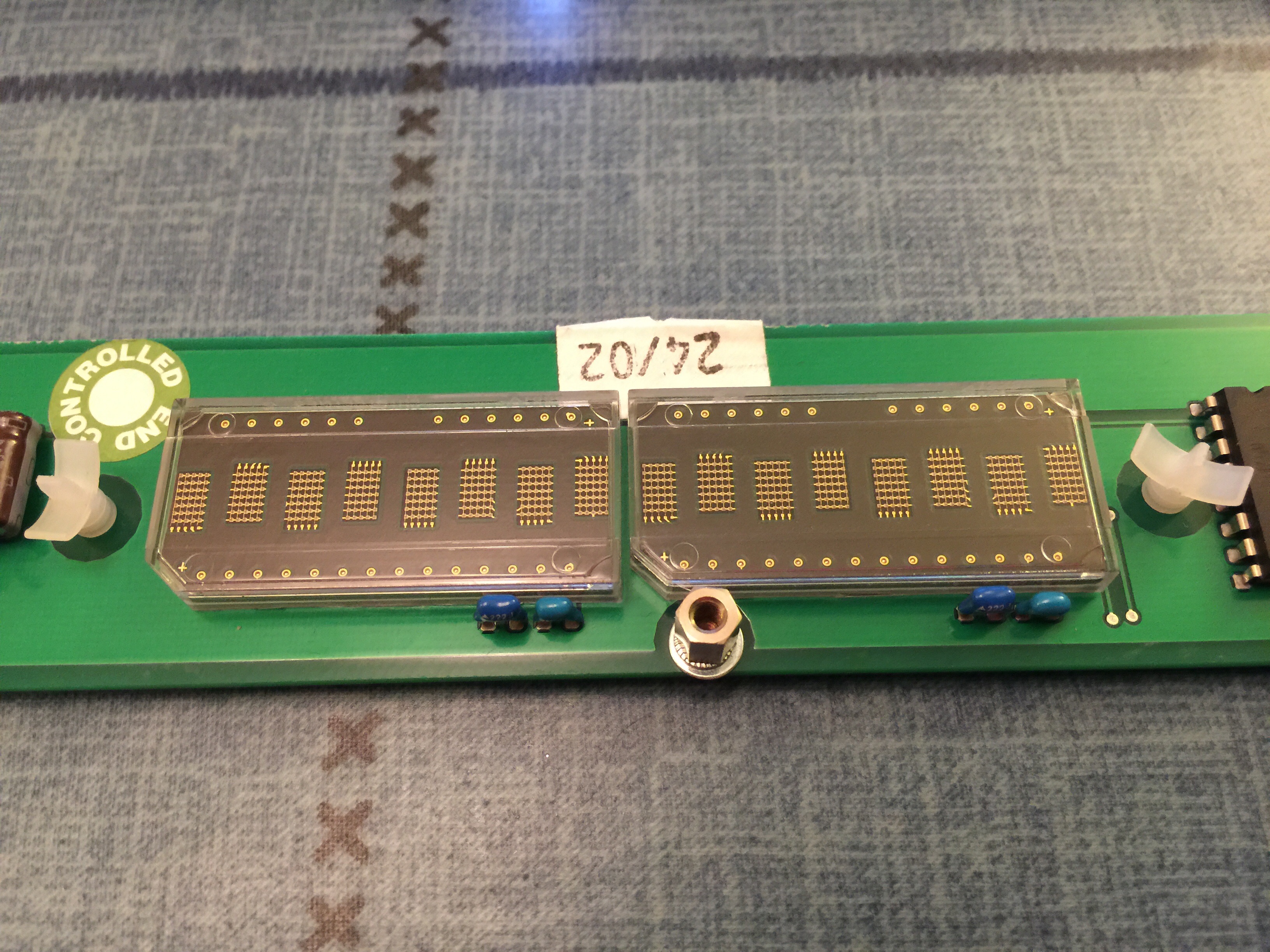

Avago Technologies has some very nice similarly-sized sets of four-character serially fed LED displays in 5x7 dot matrix at http://www.avagotech.com/pages/en/led_d ... hcms-2963/, but they're not cheap!
By strange coincidence I have a board with a pair of those displays that I'm going to desolder.
They are very expensive. Around £30 each in the UK in small quantities.
