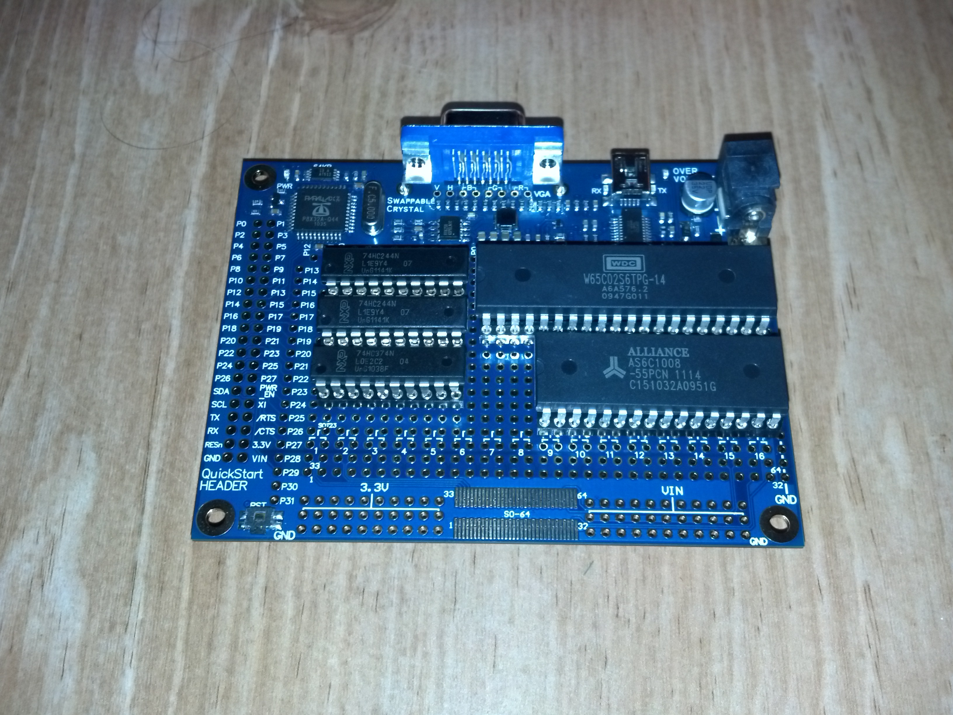

PostPosted: Sat Sep 21, 2013 12:43 am
Posts: 229
Sorry for beating my own drum here, but I think my Propeddle project would seem to fill a need here. Once it's done anyway :roll:
For those who haven't seen it before: I combined a 65C02 and a 128K SRAM chip with a Parallax Propeller (based on a project that did the same thing in a slightly different way). The Propeller bitbangs the clock and other signals to the 65C02 and can also emulate hardware such as ROM, video adapters, serial communications etc.
The 65C02's view of the world is determined by software running on the Propeller; If you want to map a video screen into the 6502 memory map: no problem. Emulating a VIA, PIA or CIA should also be fairly trivial. ROM is a matter of either mapping a Propeller memory area into the 6502 memory map, or copying it to the SRAM chip at system startup and allowing only read access. I'll also make it possible to connect real hardware via an extension bus.
As I mentioned, implementing ROM is very easy; if you would use my hardware to emulate some old system like the Commodore PET, you could probably just use a ROM dump file and use it directly. But I'm thinking, as proof of concept for those who would like to try to "bring up" their own system, I should provide a program that starts out with a blank ROM, and an on-board cross-assembler. You'll start out with a non-functional 6502 computer but you'll be able to "break out" from the keyboard, and "toggle in" a program from the Propeller, which will be executed from what the 6502 thinks is ROM. It should be just as much fun as bringing up your own system but without the "cheating" part of doing the cross-assembling on a PC, and without the tedious parts of waiting to flash and erase an [E]EPROM or download a ROM image like you would do with an Arduino or something similar: it will be "flashed" as you write it. A blank-slate computer with a self-contained development system. All you need is the hardware, a monitor or TV, and a keyboard.
Sound cool?
Of course this still needs a lot of work. First of all, I have to figure out why I can't run the main bitbang-loop at 1MHz yet (it runs one step slower, at 0.99MHz but something in the timing goes wrong at the full 1MHz speed, and I have to hook up my logic analyzer to figure out what it is). Then I need to re-design a circuit board: the previous PCB designs were based on the Propeller Platform but that's pretty much non-existent nowadays so I have to design an all-in-one PCB and I just haven't gotten that done yet.
Meanwhile, I did figure out that the Parallax Propeller Project Board (#32810) is big enough to do a wire-wrap version for those who might be too impatient to wait for the next revision of the PCB. Here's the first ever picture of a possible wire-wrap version of the Propeddle. This is a proof-of-concept, it doesn't work yet. And wire-wrap is not where I want to go: I want to make a simple PCB with through-hole parts only that has everything on board; it will probably be about twice as big as this.
File comment: First ever picture of a wire-wrapped Propeddle on a Parallax Project Board #32810. No extension bus and no wiring yet, but everything you need for a 1MHz 6502 computer is here :-)
EDIT: the wire-wrap version should be about $50, not including wire-wrapping and soldering tools and wire, and not including a PS/2 keyboard or monitor.
===Jac
