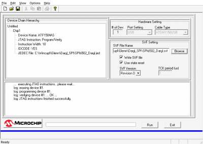

A quick step-by-step process to generate an .svf file from your .jed file created above :
( note : this process is also very useful for generating .svf files for ERASING a device and performing BLANK CHECK )
Start ATMISP
Click on "Options", then "JTAG Port check override" (this is supposed to stop ATMISP from checking if their programmer is present)
File comment: ATMISP window (port override)
Click on "Edit", then "Add New Device"
(After which device ?) default to 0 : OK
Select the correct device from the drop-down text box (e.g. "ATF1504AS")
"JTAG Instruction" : select "Program/Verify"
(or "Erase" : to generate the correct Erase.svf [no JEDEC file needs to be defined])
(or "Blank Check" : to generate the correct BlankCheck.svf [no JEDEC file needs to be defined])
"JEDEC File" : click on "Browse" to select your .jed source file (e.g. <sourcefile>.jed )
Now, on the RH pane, activate the "Write SVF File" tick box, and supply the destination File Name in the text box (e.g. <sourcefile>.svf )
File comment: Ready to run
Click on the RUN button. You should see the message "JTAG instructions finished successfully" in the message pane.
Look in the source directory, you should find your .svf file(s) !
