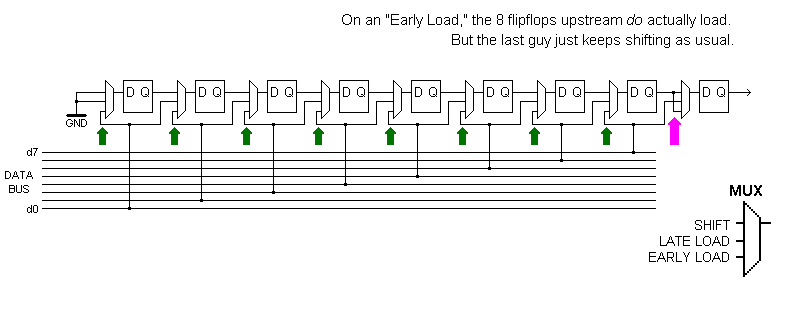

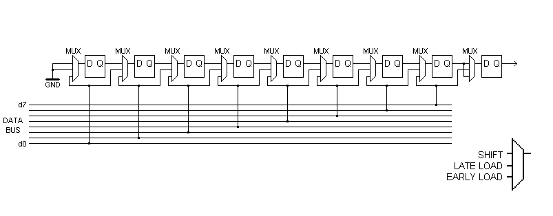

Instead of an 8-bit shift register, a 9-bit shift register is used (implemented within the CPLD). It is clocked once per CPU cycle, and there are two possible alignments for a byte being loaded from the data bus into the shift reg. The "Early Load" path loads the byte one place further upstream than the "Late Load" path.
Every LDA ($b0),y will touch the $4000-$DFFF region for either one cycle or two. On the first of those cycles (and using using the Early Load path) we always load the shift-reg ... even though it's unknown at that time whether we have good data or garbage. We find out on the following cycle. If there was a page crossing then the CPU will be re-running the access, and we can detect that based on the $4000-$DFFF address or the fact that the SYNC pin is still low. If the access is being re-run then once again we load the shift-reg, this time using the Late Load path. But if the access is not being re-run then the LDA ($b0),y is complete and the CPU will be fetching the next opcode. We can leave the shift reg alone (don't load; simply let it shift), but we need to give the CPU a Wait State, and this is easily done. I think this covers it... :) :roll:

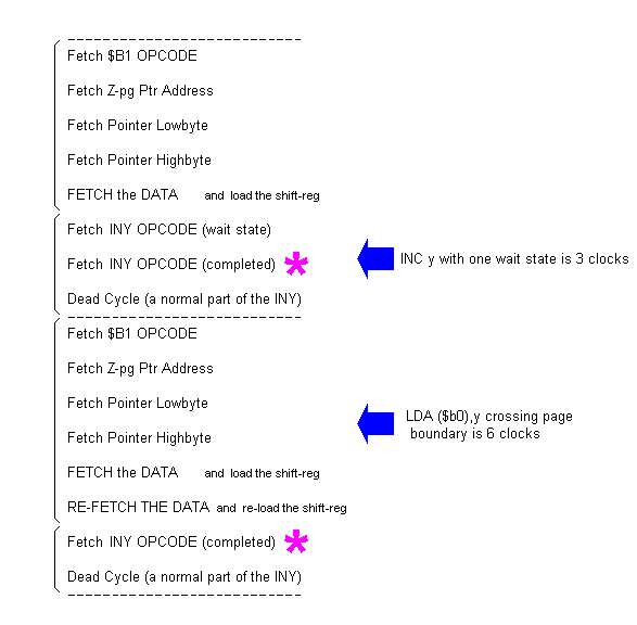

I'm struggling, too, Bill -- with the explanation, at least... My previous post was kinduva mess, so I went back and made some edits, particularly to the final paragraph -- dunno if you noticed the (hopefully) improved version. :roll:
And today I'm including a chart of what happens each cycle, with and without a page crossing. It should be clear that these two sequences end up in the same place even though they each take a different route to get there!
It's also true that the data on the shift register output needs to end up in the same place, timing-wise, despite traveling by different routes. As a reference point, the big asterisk shows when the first of the fetched bits actually appears at the shift register output.
In the case on the left there is a 2-cycle delay from the "Fetch the DATA" cycle to the asterisk cycle. Check me on this, but I reckon it's consistent with what I said about aligning the shift-reg load one place further upstream (ie, via the Early Load path).
In the case on the right there is only a 1-cycle delay from the "RE-Fetch the DATA" cycle to the asterisk cycle. The shift reg actually gets loaded twice, but of course the results of the first load get overwritten by the second load (which puts the byte further downstream, via the Late Load path).
Is this making sense yet? I admit I had an "oh, crap" moment while writing this post... (ie, is this idea fundamentally misconceived??) :lol: But mostly I do think I'm on solid ground, and with luck I've now managed to make it clear why there's never any discarded data bit and also no need to insert a wait state into a previous instruction.
I know about that feeling...very well. This is why I designed with PROGEAMMABLE logic and taught myself how to modify existing circuitry. :oops:
I see one wait state is inserted when address above $4000 was encountered in the previous cycle and current cycle has SYNC asserted. OK, that's easy to do. I'm still having problem with fetching the data (presumably from memory above $4000) and re-fetch the data again when page boundary is crossed. I understand this is due to page boundary crossing where calculation for the real address requires an extra cycle so there is a dummy cycle as a filler. This dummy cycle, if addressed to memory above $4000, will wreck havoc on my current software because it will cause two loads into the shift register when only one is expected. I would see significant data corruption, one pixel for every 8 pixel, in the part of the image scan where page crossing occurred, but I don't see that. I instrumented with scope of the shift register's LOAD/SHIFT input (which is A15 OR A14) and I see a 40nS pulse (one period of 25MHz clock) every time. The dummy cycle is NOT addressing to memory above $4000.
I'm using WDC W65C02, maybe it has different dummy cycle characteristics?

9 clocks is actually OK. :mrgreen: That 9th bit in the shift reg is a buffer that gives us some wiggle room, timing-wise.
Within each LDA / INY pair, the first (and possibly only) load of the shift-reg happens before the shift-reg has entirely emptied from the previous load. It still has one bit remaining, so you're one cycle ahead of schedule -- that's why I call it an Early Load. The same clock edge that early-loads 8 bits of new data is also the clock edge that causes the final bit from the previous load to make its way to the output of the shift-register, where of course it will remain throughout the following cycle. Here's a diagram.
File comment: When all 9 muxes select their top input, I call that a Shift. All 9 on the middle input I call a Late Load. All 9 on the lower input I call an Early Load, although the last bit is actually connected so as to shift.
And during that following cycle we find out whether the load was good data, or just garbage because of a page crossing. If we have good data then at the end of the cycle we cause the reg to shift (and this shift will cause the first of the newly-fetched bits to appear at the output of the shift reg). But if we have garbage then the CPU will re-run the fetch and at the end of the cycle we cause the shift reg to do a second load. We're no longer one cycle ahead of schedule, so we use the Late Load path to put the byte one place further downstream so it'll immediately appear at the output of the shift reg.
INC y with one wait state is 3 clocks, and LDA ($b0),y crossing page boundary is 6 clocks
Yup. So, let's look at what happens during those 9 clocks. I'm appending a rehash of the chart I presented earlier.
Note that the asterisks (which show when the first of the fetched bits actually appears at the shift register output) are exactly eight clocks apart, as required. That's despite the fact that bytes won't necessarily enter the shift-reg at an exactly regular pace.
Questions welcome. It's hard to feel confident that this is clear now, and I haven't omitted anything important... :roll:
