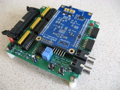

A couple of years ago I started work on a FPGA based framebuffer for the Beeb that connects to the 1MHz Bus.
It used the 1MHZ Bus FPGA Adapter and a cheap Xilinx LX9 FPGA board:
(there are several other projects for this board)

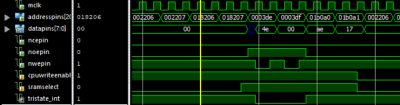

Dealing with multiple clocks requires care. What is the relationship between the clocks? Do you know the phase difference between the 100MHz and 25MHz? Is the 8MHz actually 8.333? (that would make life a lot simpler)
The first step is to draw a timing diagram. Put all of your signals on it, and add arrows to show which edges control which transitions. If you've got a signal changing too close to the clock edge that samples it, that'll cause problems. If you don't know or can't control the timing between clocks, it gets a lot more complicated.
If you haven't already learned how to use the simulator, do it now. It'll show you a reasonable approximation of what's actually happening, and that will save you a lot of time in the future. I've got a testbed set up for mine, with a fake SRAM attached to the rest of the system. There's no way I could have got anything working without it.
It's also worth running a timing analysis. I don't know which FPGA you're using - if it's Xilinx, the tool you want is trce. FPGAs can be fast, but 100MHz is fast as well. It'll find your critical paths and tell you exactly how many nanoseconds you don't have spare.
I don't know what timing you intend this to have. But be aware that 10ns RAM doesn't necessarily mean a 10ns memory cycle, particularly if you want to write to it. There has to be some time between writes - you can't have a rising edge on /WE if the next cycle wants it low again. And it takes time for signals to make their way through logic and routing and to the RAM's pins. You have to take that time into account.
The memory in my design is driven by an 80MHz clock, and it takes two clock cycles for each memory access. One of the signals ended up 1.5 cycles long, and I had to use combinatorial logic to combine signals from both edges of the clock. It ended up with 40M memory accesses per second, which is exactly what my system needs. The other clocks that I use are derived from the 80MHz clock through logic (driving BUFGs), so I know exactly where in the memory cycle they go. I've attached a screenshot showing a couple of writes followed by a couple of reads.
