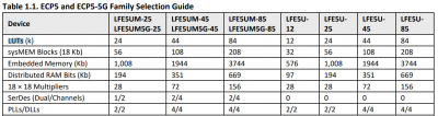

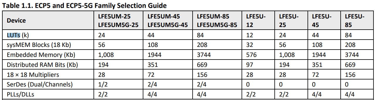

A replacement/upgrade to the GODIL would be very well received I think.
My concern with the ICE40-HX8K devices is they are actually pretty small, possibly smaller even than the XC3S500E part used on the original GODIL. The ICE40-HX8K has 7,680 LUTs and 128K bits of block RAM. The XC3S500E has 9,312 LUTs and 360K bits of block RAM.
It seems a shame to go to all the trouble of designing a replacement that is more space constrained.
If you prefer the Lattice parts (because of the open source tool chain) then it might be worth considering the newer ECP5 family.
The smallest part in this family has 12K LUTs and 576K bits of block RAM:
I don't know where the ECP5 parts sit price-wise, and I imagine they (like most FPGA) are currently being impacted by the global semiconductor shortage.

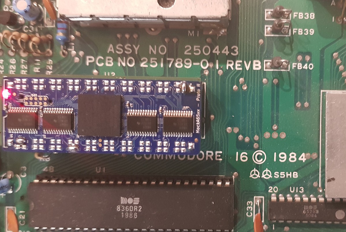

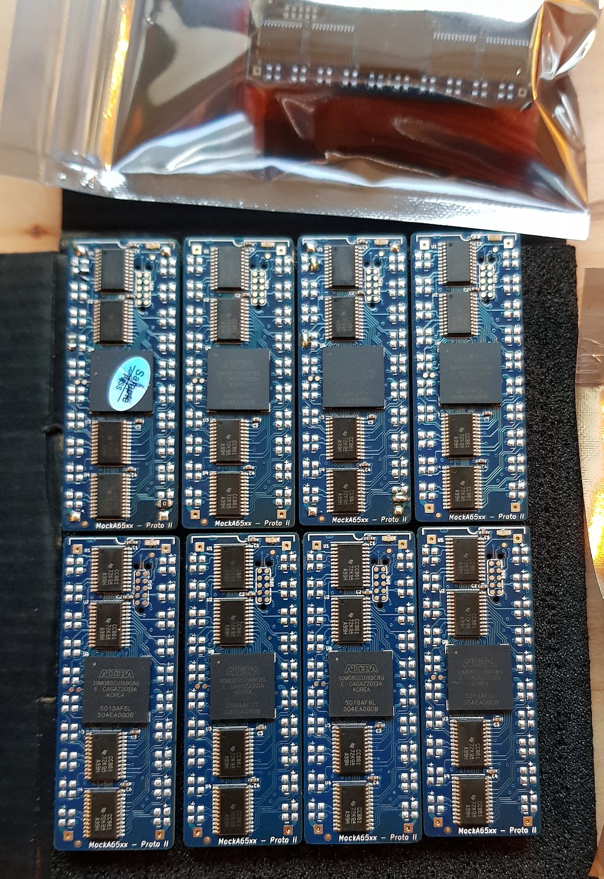

Just for what it's worth I made some kind of replacement for the GoDIL for my own projects:
MockA65xx
It's using a MAX10 FPGA and in order to save some space I'm using a TagConnect Adapter to program the device.
Power supply can be configured via solder bridges but it's also possible to supply power via JTAG connector.

Thank you for sharing! And you are using the MAX10, which I found tempting but had not seen in hobbyist use. Are you happy with the chip and with the development tools?
Your level converter solution is closer to the original GODIL, with pullups on every pin. The NXB0108 level converters which I am inclined to use are more elegant, but I am not sure how widely compatible they would be with host systems which may have their own pullup resistors on some signals. Which value did you use for your resistor arrays, and what has been your experience regarding compatibility of the signal levels with different hosts?
Anyway, what you have there looks pretty close to what I was planning to design. Not sure whether I should even bother? The one addition I had in mind was a USB interface, both for programming the FPGA (TinyFPGA style) and to potentially use the board as an in-circuit emulator/tester for various CPUs.
Oh, one more question: Where did you have the boards assembled? (Or did you hand-build them?) Thanks!

Yes... I'm quite happy with the MAX10 as it's easy to use with the builtin flash: No external components necessary (except
the power supply and caps off course).
The Quartus IDE is certainly not the best IDE but IMHO a lot better than the Lattice stuff...
The pullups in my design could (will?) be removed in the hopefully next/last revision as they are not necessary.
I'm using 4.7k or 5k IIRC... So far I never had a problem but I know that a there was a problem with Z80
in some Sinclair machine due to the pullups used on GoDIL
When I stated the project 2018 I was also contemplating to use the NXB0108 but decided against it: I don't like that automatic
switching of directions. Seems to be a matter of taste?! :D
If you look carefully at the schematics: The 10pin JTAG connector has some additional lines which I wanted to use
for primitive UART connection - but which could be used for USB too.
I did the design in order to be able to implement as many 6502 variants as possible (therefore the name: Mock a 65xx).
See attachment and here:
https://hackaday.io/project/165624-mock ... eplacement
But of course the design isn't limited to 6502....
The boards were produced by Elecrow.
