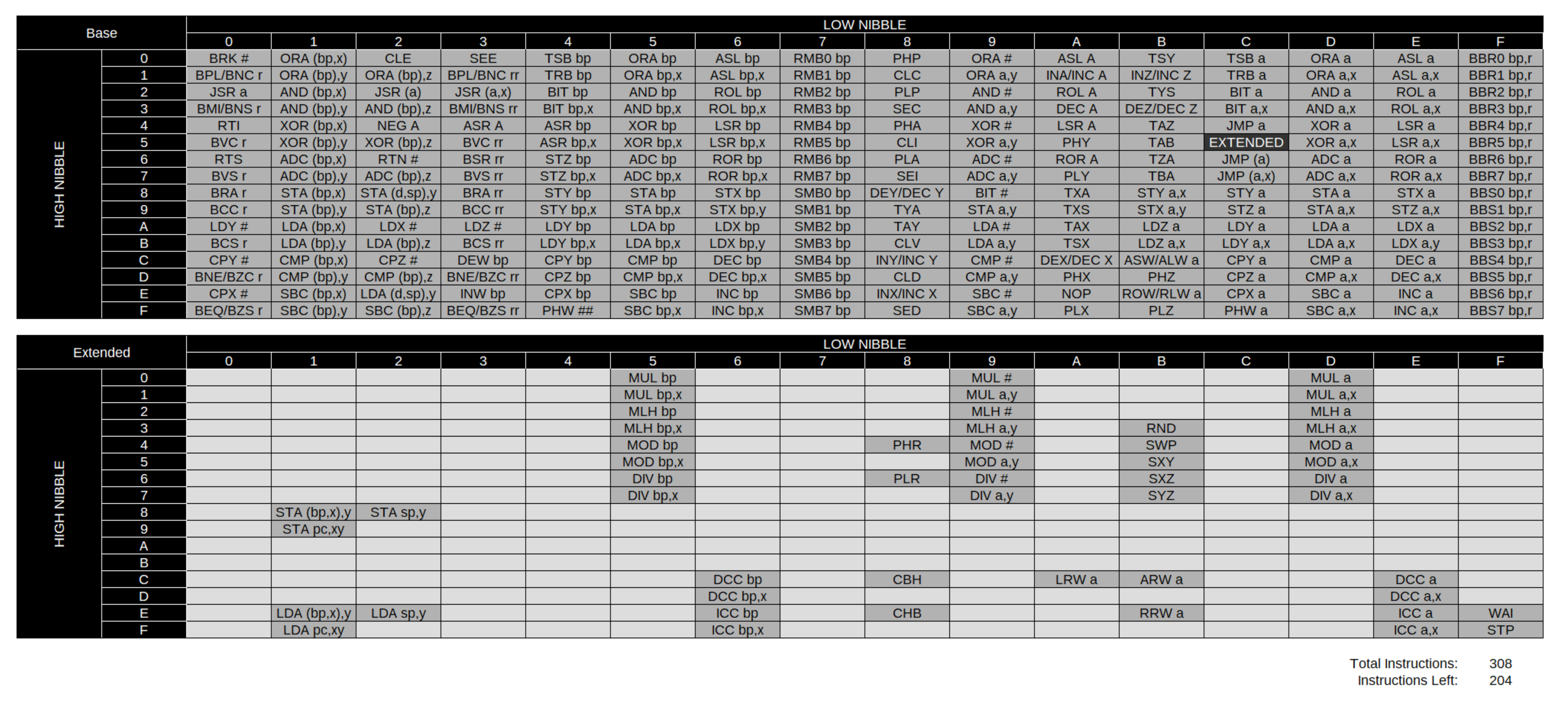

here the whole Opcode table:
I tried to place the Instructions in such a way that they match existing instructions. so for example taking ORA and slapping AUG infront of it turns it into MUL (assuming the addressing mode used also exists for the extended Instruction)
and here the full List of New Instructions (note that both Bytes and Cycles have a +1 to them because of the Prefix Opcode being executed before the actual extended Instruction)

now a bit more detail about the Instructions.
MUL, MLH, MOD, and DIV are pretty straight forward, their placement in the Opcode table matches ORA, AND, XOR, and ADC in that order.
though the actual Division circuitry is not really ready yet (which is why the Cycles have a +? next to them). i'll likely end up making a seperate state machine that does a simple subtraction loop.
it won't be fast but still faster and more compact than doing it in software.
LWR, AWR, and RRW, not much to say either, they are just counterparts to the existing ASW/AWL, and ROW/RLW, and are therefore also placed in the same opcodes (exception being LWR as it has no counterpart)
ICC, and DCC, Interesting Instructions that allow you to Increment/Decrement multi-byte long values in Memory without using Branches or long LDA/ADC/STA functions. note that like ADC/SBC they are effected by the D Flag. their placement in the Opcode table match INC and DEC
SWP, SXY, SXZ, and SYZ, again pretty straight forward. their placement in the Opcode table matches TAZ, TAB, TZA, and TBA in that order.
also note that none of them update any flags.
LDA/STA SP,Y, LDA/STA (bp,X),Y, and LDA/STA PC,XY, some crazy looking Addressing Modes. the LDA Instructions don't directly line up with existing LDA Instructions.
SP,Y is the simpliest one, it Accesses Memory at the location of the current Stack Pointer with Y added as an unsigned offset. note that the Stack Pointer is not modifed during this and that this counts as a Stack Read/Write Operation so VSA will be pulled high.
(bp,X),Y or "Double Indirect" is just both of the regular X/Y Indirect Addressing Modes mashed together. i've heard on here this is useful to do stuff like accessing an array of data from a table of pointers, all in a single instruction.
PC,XY the weirdest Mode, it Accesses Memory at the location of the Program Counter (ie opcode of the next instruction) with the 16 bit XY pair being added as an Offset. (X = High Byte, Y = Low Byte)
CHB, and CBH, allow you to convert back and forth between Binary and BCD, Carry gets set if the input was invalid
RND, not much to explain either, the CPU has a built-in LSFR that is ALWAYS running as long as there is a Clock signal connected to the CPU, it completely ignores anything else going on the CPU like Resets, RDY being pulled low, etc.
it's not really intended to be used as an RNG itself, but it can be useful to give a seed for an actual RNG Function.
PHR, and PLR, not much to say i just thought these would be useful for Interrupt Routines or debugging something.
WAI, and STP, both of these function similarly to their 65C02 versions. noteable difference:
WAI doesn't continue execution after itself if it received an IRQ while the I Flag is set, instead it will just ignore it.
also because my Aborts actually cancel the current instruction they can be used to escape both a WAI, and STP

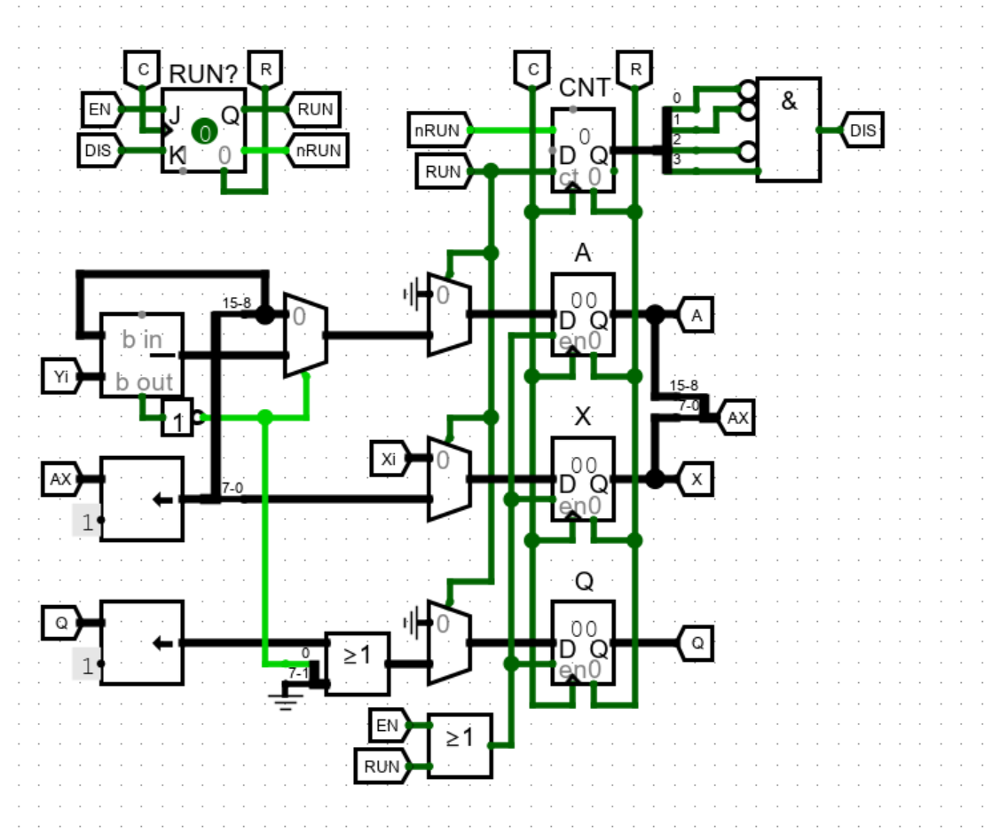

Alright, i have decided to go with both 1. and 3.
i sat down and made a proper division circuit/state machine, but it will not be interruptable. (except for Abort and Reset obviously)
I used this site (plus John West's Post) to design the whole circuit: https://projectf.io/posts/division-in-verilog/
overall it was a lot simplier than i thought it would be, i was never able to find an actual example logic circuit online, just example calculations, pseudocode, and text descriptions of the steps...
anyone who uses Division Instructions has to be aware of the potential Interrupt Lag they can cause.
though it's only 8 cycles for any division (there is no divide by 0 check or anything, any operation in it will always take exactly 8 cycles), so the longest division instruction (DIV/MOD Absolute) would need a total of 13 Cycles.
but that could also become 14 cycles depending on how exactly i implement the Control Unit waiting for the State Machine to finish.
my idea was to use one of the empty places in my conditional micro-branch selection thingy.
basically i have a few Micro-Instruction that check for some bit being set (a flag or data bit from Memory), if it is set the Cycle counter is set to 5, if not it will increment normally. but the Demultiplexer used to select the bit to check is larger than it actually needs to be, so without much effort i could add a bit for the State Machine, so the Control Unit would have a Conditional check at Cycle 5 and if that bit is set (ie the State Machine is still working) then it will set the Cycle counter to 5 again, making it loop for as long as the State machine is running.
i use the same exact thing for the WAI Instruction btw, i just have it contionally jump to the same cycle over and over until an Interrupt is caught and it can break free of the loop to finish the WAI Instruction, which in turn starts the Interrupt Sequence.
I'll post an image of the current circuit i have, but i won't go into much detail as i want to completely redo it cleaner for the CPU. but the register names and Labels (X/Y/A/Q) are identical to the site i linked so if anyone really wanted to they could probably pice the circuit's function together.

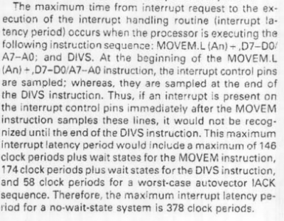

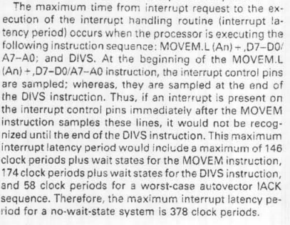

14 cycles doesn't seem so bad - especially if we're talking about running faster than 1MHz. Usually interrupt latency is caused in cycles but experienced in nanoseconds.
I note the 68000 has a worst case latency - even with a zero wait state memory - of 378 cycles. That's because MOVEM is sensitive at the start of the instruction, and DIVS at the end. And the interrupt acknowledgement sequence takes 58 cycles itself. (See page 2 of the pdf)
File comment: excerpt from Motorola App Note AN1012

    N V S B D I Z C
    Opcode  Addressing      Mnemonic        Bytes   Cyles
    5C 49   Immediate       DIV #nn         2+1     11+1
    5C 45   Base Page       DIV nn          2+1     12+1
    5C 55   Base Page X     DIV nn,X        2+1     12+1
    5C 4D   Absolute        DIV nnnn        3+1     13+1
    5C 5D   Absolute X      DIV nnnn,X      3+1     13+1
    5C 59   Absolute Y      DIV nnnn,Y      3+1     13+1
Assuming an Interrupt coming in during the Opcode Fetch of the lonest variant of the instruction it would take around 14 cycles for the Interrupt to be handled, which at perfect 25MHz Operation is 560ns (0.56µs), even at the plan-B speed of 12.5MHz it would still just be ~1.12µs. and i think any user should be able to handle their keyboard/IO stuff taking around a microsecond longer than usual, especially since modern PCs deal with Input lag in the milliseconds.
also cannot really think of anything timing critcal that couldn't spare a microsecond, even if there was something you can just use an Abort to really make sure the CPU makes it in time.
speaking of interrupts, i also changed some things about their Logic, specifically NMI and ABT are now being sampled at the falling edge of PHI2 instead of being asynchronous as it could otherwise cause some timing issues.
anyways, division and Interrupt latency aside, what about all the other features of the CPU?
the new addressing modes like the Stack indexed and PC Relative Indexed ones for example.
my attempt to complement the 65CE02's Instruction set by adding the Right Shifts/Rotate to it's own left Shifts/Rotate.
or just the new instructions in general. for example i'm not entirely sure about keeping CHB and CBH since BCD doesn't really seem to be a very commonly used feature of any 65xx CPU.
