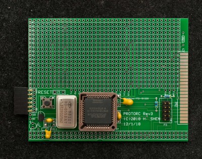

I found my EPM7064S prototype board and build it up and programmed the CPLD. So I'm off with breadboarding of CRC65.

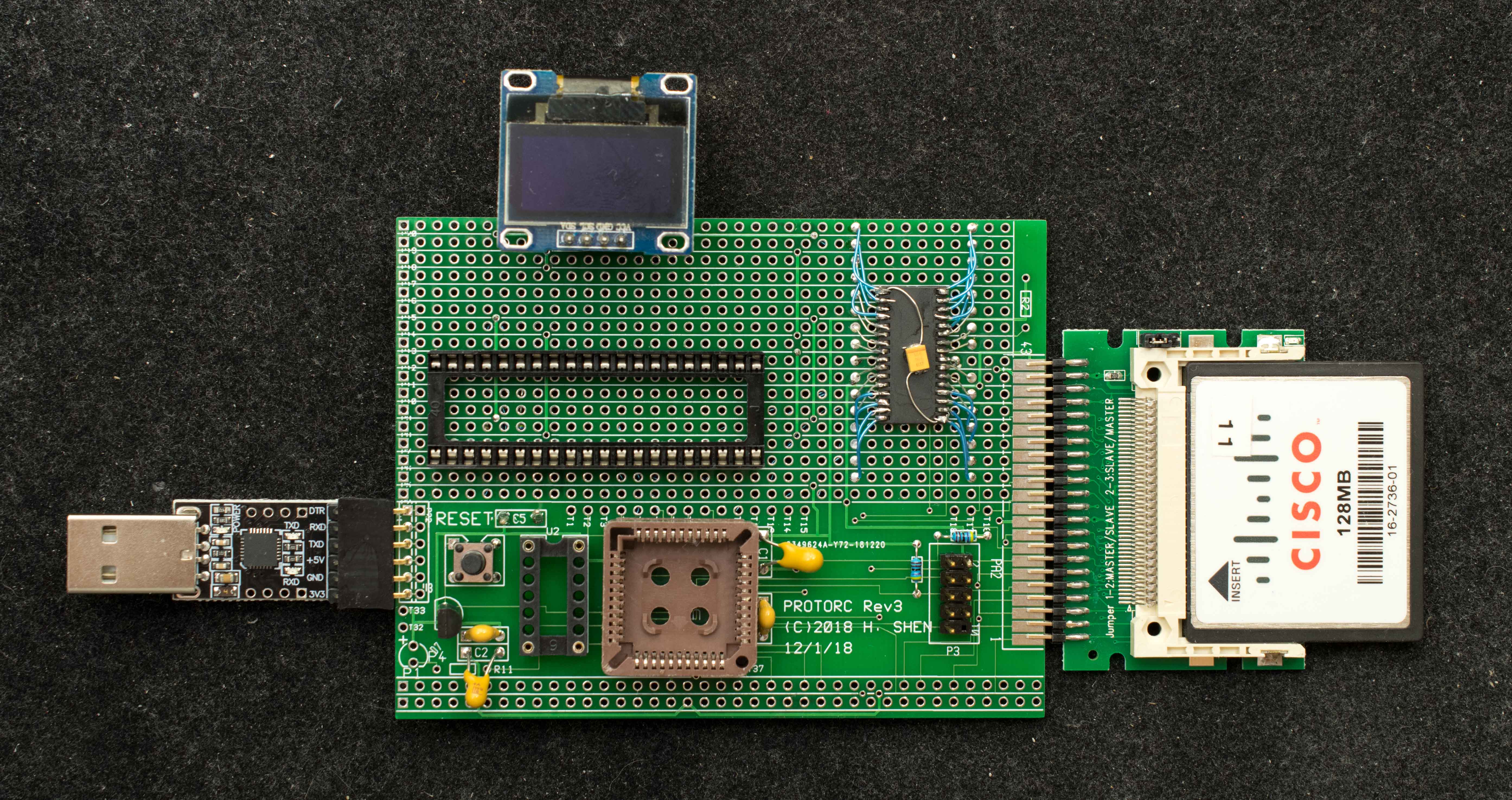

A mock up of what finished CRC65 prototype may look like.
So it begins...
