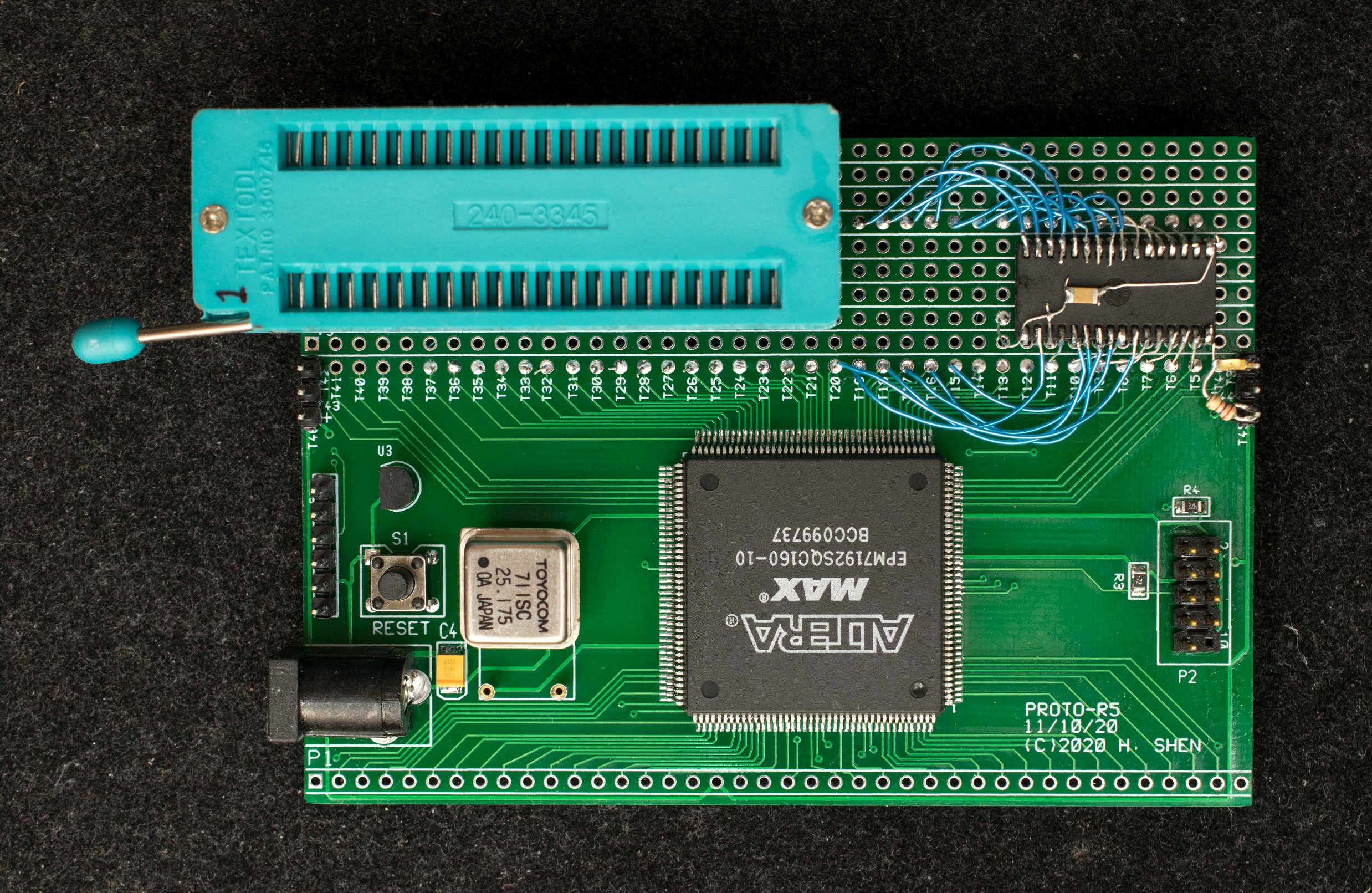

This being a more "techie" site, I will try something a bit unconventional: I want to build retro computers out of used, (possibly fake/rebranded) eBay parts. The challenge is not designing to the datasheet, but anticipating for the unexpected. The reason this post is under 'Programmable Logic' is because I anticipate having problematic parts and spending time debugging, so I'm depending on the programmable logic to work around the various problems. I'm comfortable around CPLD, so this is a good place to start.
I'll start with a batch of used EPM7192S purchased off eBay a decade ago. They have residual solders and some bent legs so were obviously removed from existing boards. I 'discovered' them recently in my overflowing garage and designed a prototype board for them. This is a simple proto board with EPM7192S, Altera programming header, reset supervisor (OK, confession time, the reset supervisor, MCP130, is from Mouser, but everything else is from eBay, so far...), oscillator, and header for a serial port. In the prototype area I'll place a 40-pin ZIF socket for CPU (6502 in this case), and put down a 128Kx8 RAM (specifically CY7C109-25 which I bought a reel from eBay years ago). I'll probably also install an IDE44 header for compact flash or disk-on-module. The goal for this board is a 'headless' 6502 SBC. Later on keyboard/VGA capability will be added through the expansion connector at the bottom of the board.
One step at a time, the first project is a 6502 tester to check out the random 6502 I bought off eBay.
To be continued...
File comment: CPLD EPM7192S prototype board

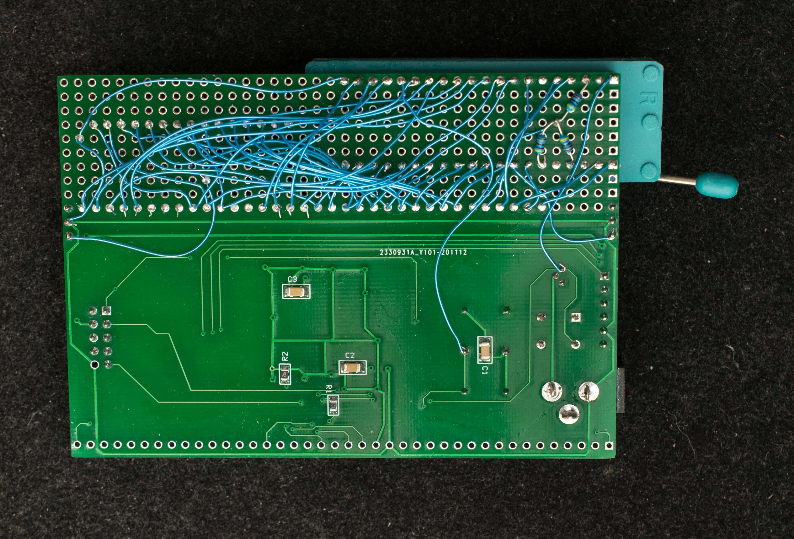

Making progress on the 6502 test bed. I wired up the 40-pin ZIF socket according to 6502's pin assignment. I also wired up a 7C109 128Kx8 RAM. The RAM is not necessary at this stage of development. I only need to feed 6502 some instructions and output data over a serial port (just a 10-bit shift register) to check out the working of the 6502.
Powered up the board; LED is blinking as it should and I can program the CPLD, so I'm settling down to program the CPLD now.

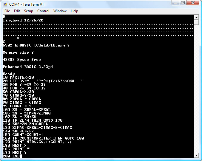

Tinyload is a 256-byte Intel Hex loader that is first loaded into Proto65 and, in turn, loads other program in Intel Hex format. The particular program loaded by Tinyload in first picture is EhBASIC that was ported to Proto65. To demonstrate EhBASIC is running correctly, the 2nd picture shows it running the mandelbrot benchmark.
I have documented the current Proto65 schematic, CPLD design, and software here:
https://www.retrobrewcomputers.org/doku ... r5:proto65
The next step is adding a compact flash interface so Proto65 can boot from CF disk.
Looking further ahead, the EPM7192S is only 50% utilized at this point so other peripherals can be added. The one peripheral I have in mind is a 640x480 VGA display where 6502 access one side of a dual port RAM and the CPLD access the other side of the dual port and drive the video interface.

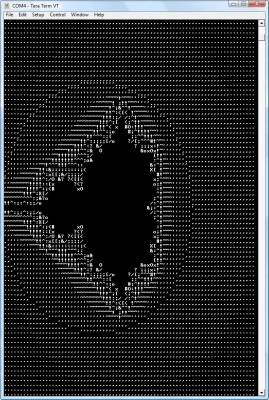

(Small note: you have there the buggy version of the Mandelbrot code. See here.
PostPosted: Mon Dec 28, 2020 3:42 pm
Posts: 1076
Ah Good, you caught me just in time; I was going to rewire Proto65 to add a compact flash drive. With the correction the mandelbrot looks much better, see picture below.
Lee Davison also had written EhBASIC for 68K and I have ported it to my 680x0 hombrews. The original mandelbrot program running on EhBASIC-68K looks just like the picture below, so the variable names on EhBASIC-68K must be longer than 2 characters. Good, this solves the mystery of why mandelbrot ran differently on EhBASIC 6502 vs 68K.

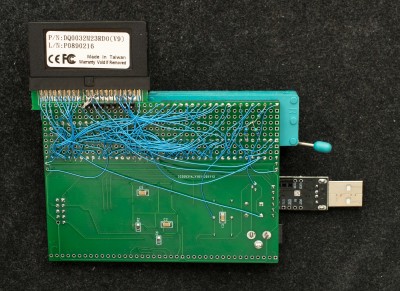

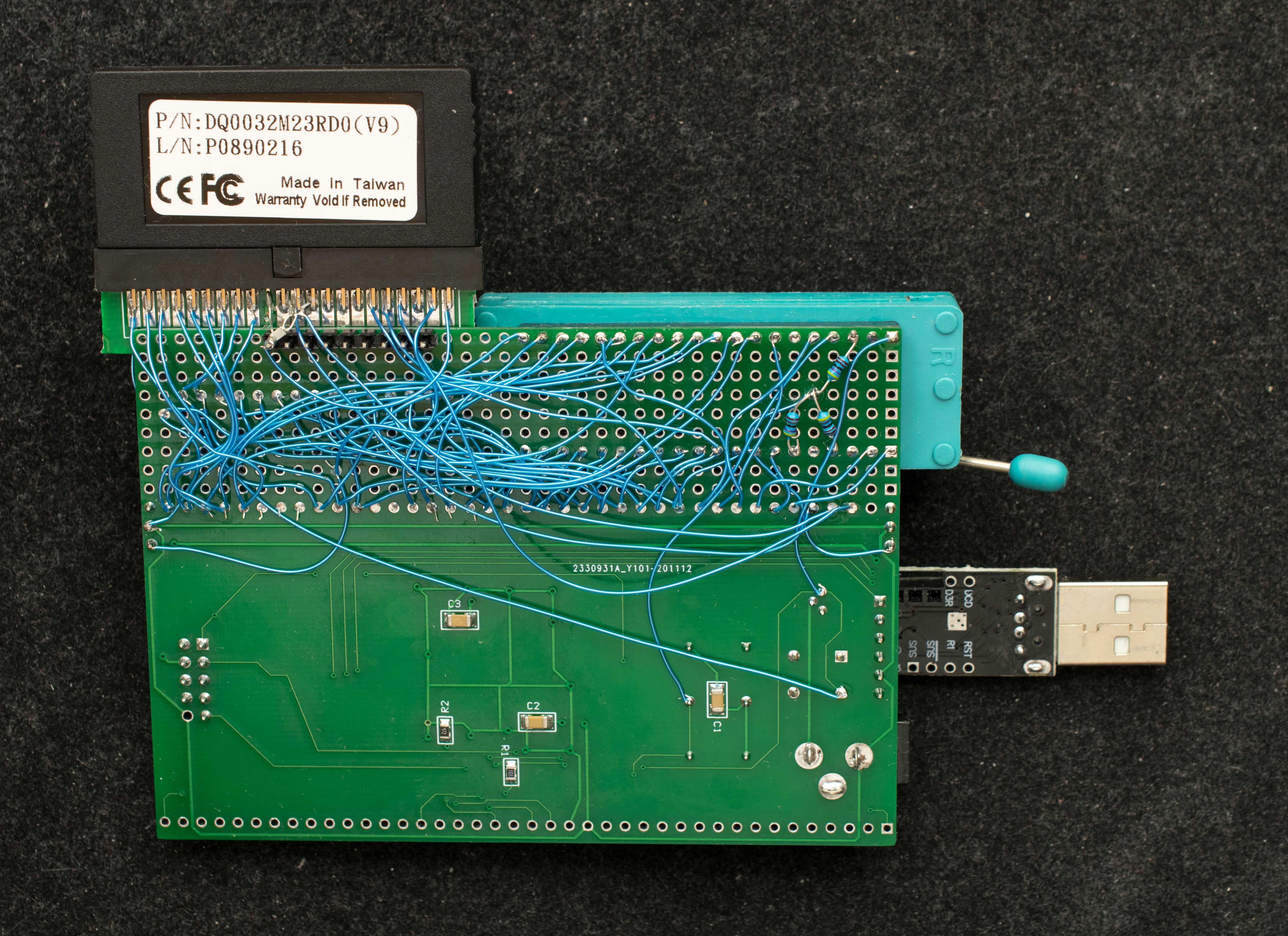

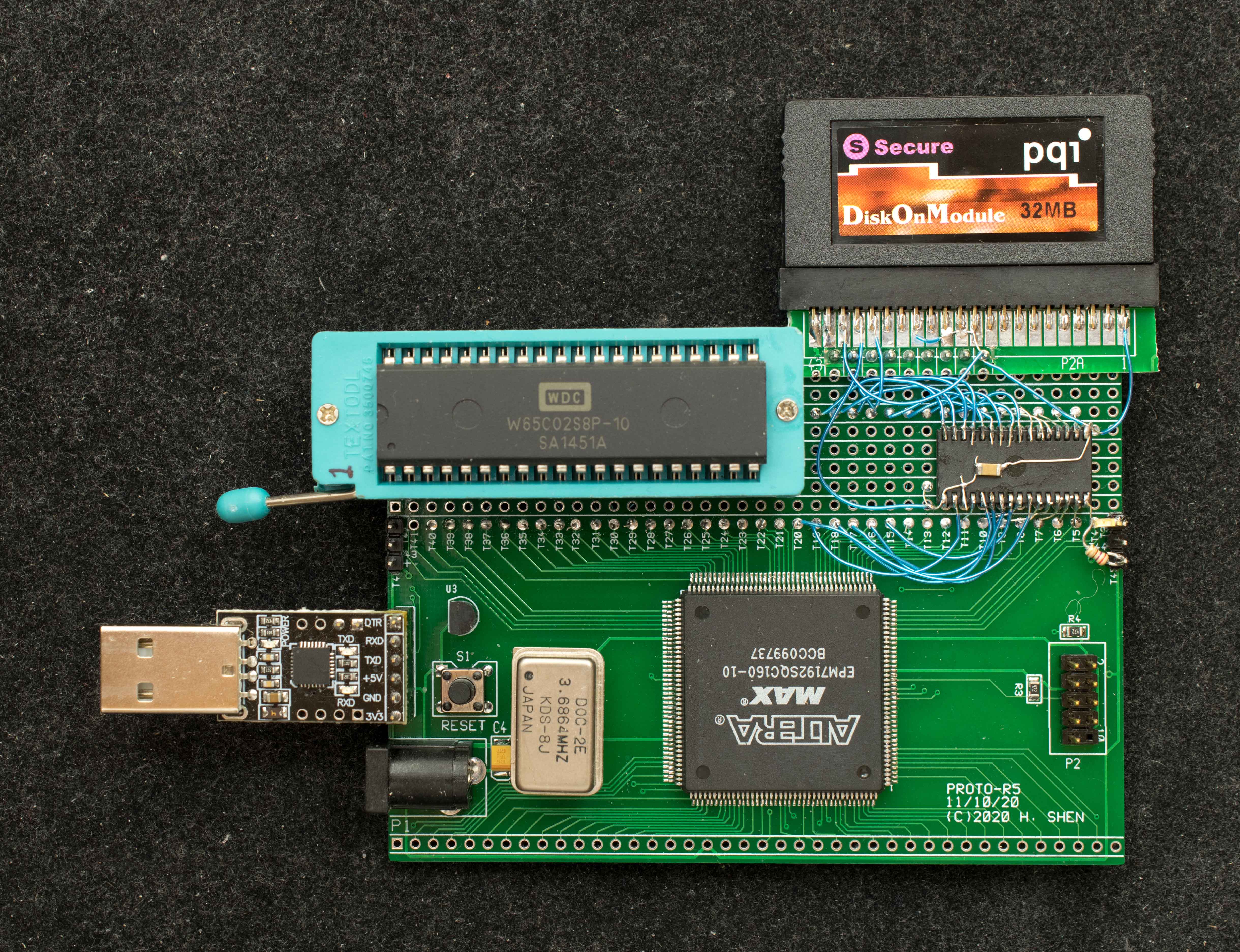

I am low on CF adapter hardware so I installed a header for disk-on-module interface, instead. DOM has the same electrical interface as CF disk except mechanically the connector is mirror of CF interface. Of course I happened to have few DOM from trusty eBay.
The memory map is now changed so internal ROM is at 0xFF00-0xFFFF; internal I/O such as serial port is 0xEF00-0xEFFF; external I/O sucha as DOM interface is 0xEE00-0xEEFF; and RAM is from 0x0-0xEDFF. When the memory-mapped VGA is installed, it will be at 0xF000-0xFFFF; ROM at 0xFF00-0xFFFF will be disabled with a register write in CPLD.
I'm able to set DOM to 8-bit mode and access it as a 8-bit parallel device. The plan is for the ROM to sample serial port receive ready or DOM ready bit and decide which device to boot from. Booting from DOM is also a multi-stage process where Master Boot Record at track 0 sector 0 is loaded into memory and run which, in turn, load and run a larger program.

Proto65 was designed as a testbed for eBay parts including the 6502 CPU. The two eBay 6502 are labelled "W65C02S8P-10", allegedly 10MHz parts. Well, I've read enough posts here to know that's not true; while they are functional, one part is good at 3.68MHz while the other part is only good at 1.84MHz. Proto65 circuit is consists of a 25nS RAM and CPLD with 10ns prop delay so it should work well with a 10MHz 6502, likely higher. So I ordered a few W65C02-14 from Mouser and they came in this afternoon. The Mouser W65C02-14 works at 3.68MHz as it should, 7.37MHz as expected, (serial port is now 230400); and it also works at 14.7MHz with serial port at 460800. Power is not much higher, drawing 190mA @5V at 3.68MHz and 230mA at 14.7MHz. This is because EPM7192 is a power hog overshadow whatever extra power 6502 may have drawn at higher frequency. Ran the mandelbrot benchmark, it now runs in 77 seconds @ 14.7MHz.
14.7MHz is too fast for the disk-on-module drive which is operating in PIO mode. I need to work on the RDY signal and provide proper setup/hold for the disk access.
