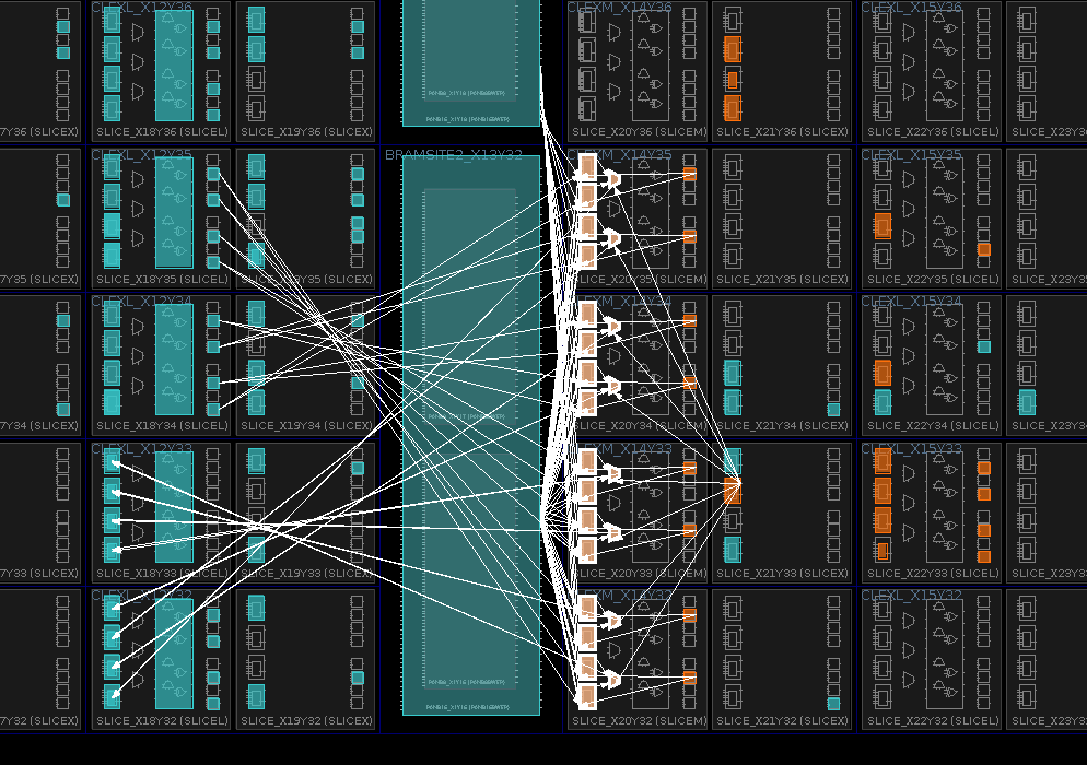

As you can see here, automatic floorplanning doesn't look very impressive. And if you show the ratsnest for some of these isolated elements, it goes all over the place.
Of course, the Xilinx business plan is to sell you a bigger/faster FPGA instead.

Here are the 8 base register muxes for the lower address bus, plus all their connections to other elements.
That area in the bottom left is where the lower half of program counter is stored.

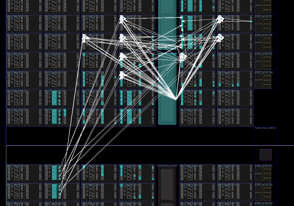

That's pretty bad. What does it look like for the same elements after you manually place stuff?

Here I have manually placed the same input mux in a row (the parts in orange). The blue parts are still left up to the tools, and are still scattered everywhere.
Some of the other orange things are just blocks I moved out of the way to make room.
The user interface of that tool (planAhead) is pretty horrible, by the way. I constantly ended up accidentally zooming instead of moving components. It is helpful that it shows you where you can place components. If you hover over the wrong place, shows that it won't fit there. For instance, in the slices with the F7MUX used, you can still use 2 of the 8 flip flops in the slice using bypass inputs, but not any of the remaining 6.
Together with the slice diagram, it's helpful to learn the possibilities and restrictions.
Unfortunately, on my (Linux) machine, the FPGA editor doesn't work. I'm missing some (old) dynamic libraries.
