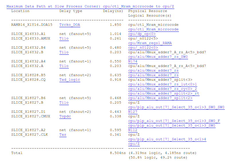

I will do some fmax experiments later today or tomorrow. Right now, it says around 85 MHz for the async model without memories, but obviously that does not including going off chip to external SRAM which will have a huge impact.
I will hook up internal block RAM using method above instead, to get some results we can compare to old core.
Whatever the results are, I expect to be able to improve them with manual instantiation/placement, which is planned for 2nd phase.
PostPosted: Fri Oct 23, 2020 4:59 pm
Keep in mind that you'll lose 2kB of memory with this core, due to microcode claiming one of the block RAMs.
PostPosted: Fri Oct 23, 2020 6:57 pm
Hooking up the core to a small ROM, using XC6SLX9-3, I can get it to pass 116 MHz.
