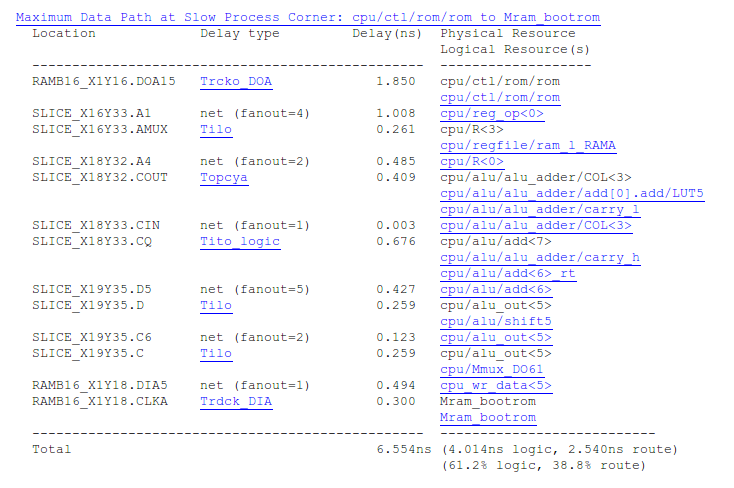

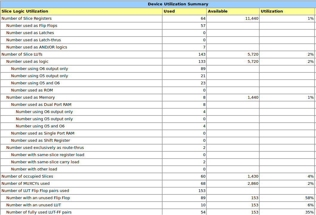

Current design, targeted for small Spartan 6, results in 60 slices. However, not all logic is included yet, so this number will get a little bigger.
Final design, generic version, still has around 60 slices (there's some random variation in each run). Connected to single block RAM, it meets 8 ns constraint out of the box, and 7 ns with SmartExplorer pushing.
The Spartan-6 version has 120 LUTs, around 50 slices when synthesized without any placement constraints, and around 6.6 ns with SmartExplorer. I tried hand placement of a couple of things, but that only made things worse. I'll have to test some more with that, but I doubt there is much improvement possible.
Longest path in nearly all cases is microcode ROM->register file->ALU adder->ALU shifter->DB out mux->RAM. Nothing fancy, really, and nothing that suggests any possible improvement. In earlier timing runs that I did, the output mux may have been optimized away, so I got some slightly better results.

Strange. After adding support for I and D flags, including CLI/SEI/CLD/SED, the slice count dropped to 55.
Adding support for CLV, and overflow detection in the ALU, kept it at 55.

More strangeness. Adding one more flop results in now needing 52 slices.
Another example of designing with LUT6 constraints:
I had a problem with the logic for the C flag update, that required adding an extra input to the mux. The LUT had a free input, but I had already used up all the possible cases for the select signals:

I took a quick look at the timing output. It's showing about 15 ns delay, but most of that appears to be routing/fanout. I'm not going to worry about timing right now. The synthesis is running with 'optimize for area' settings.
I think that with manual instantiation/placement, both area and speed should improve at the same time.
