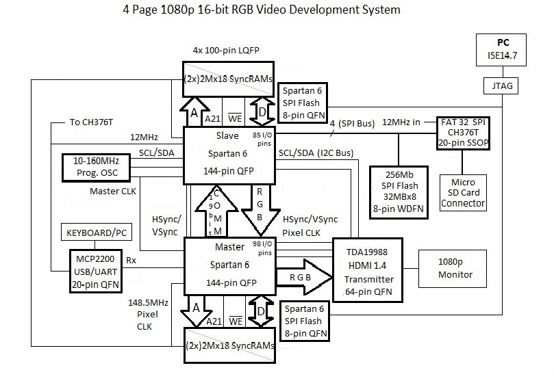

EDIT(9/11/2018): Added Block Diag.
EDIT(9/16/2018): Updated parts list. Cleaned up Block diag. Added more detail to explain goals.

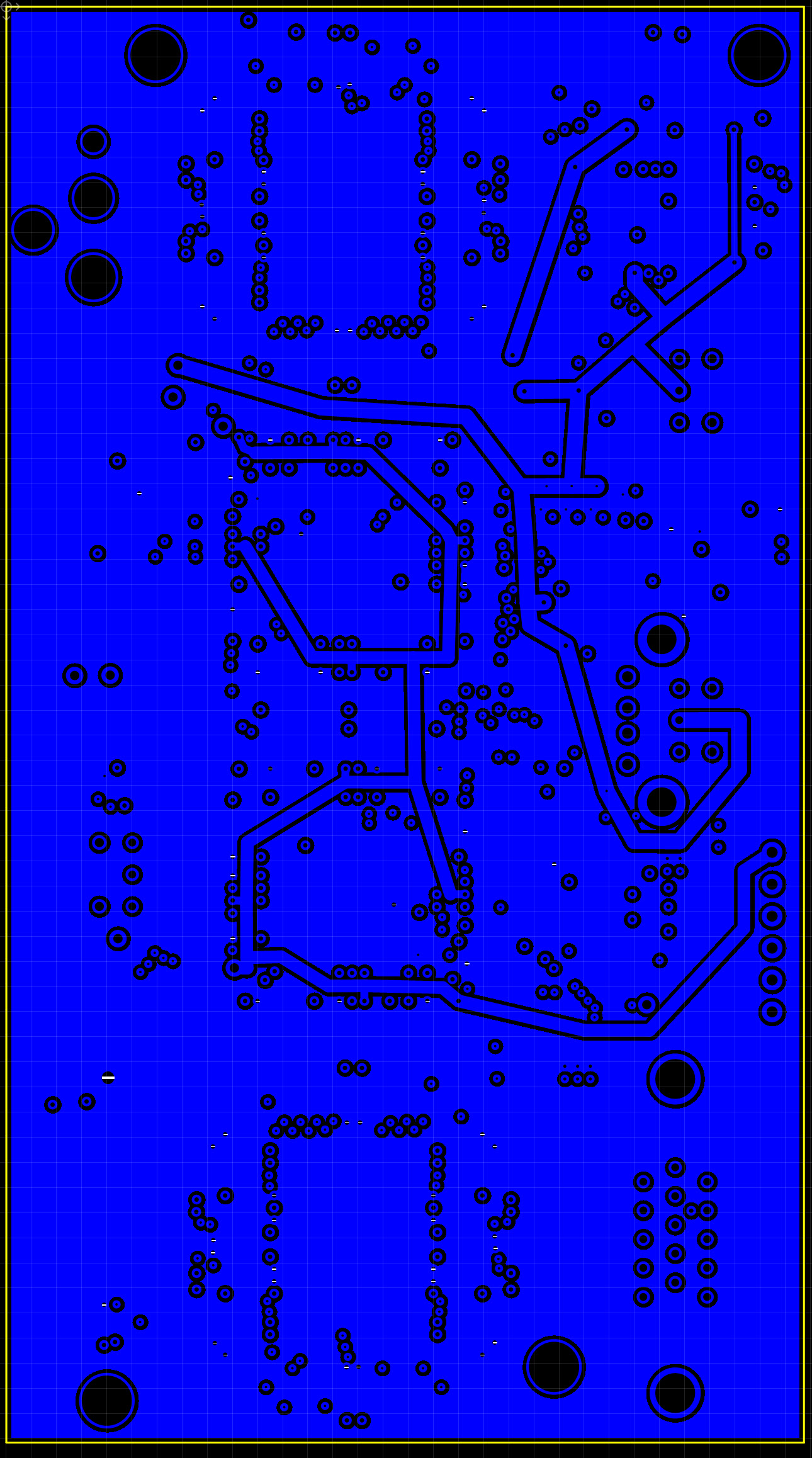

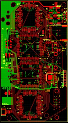

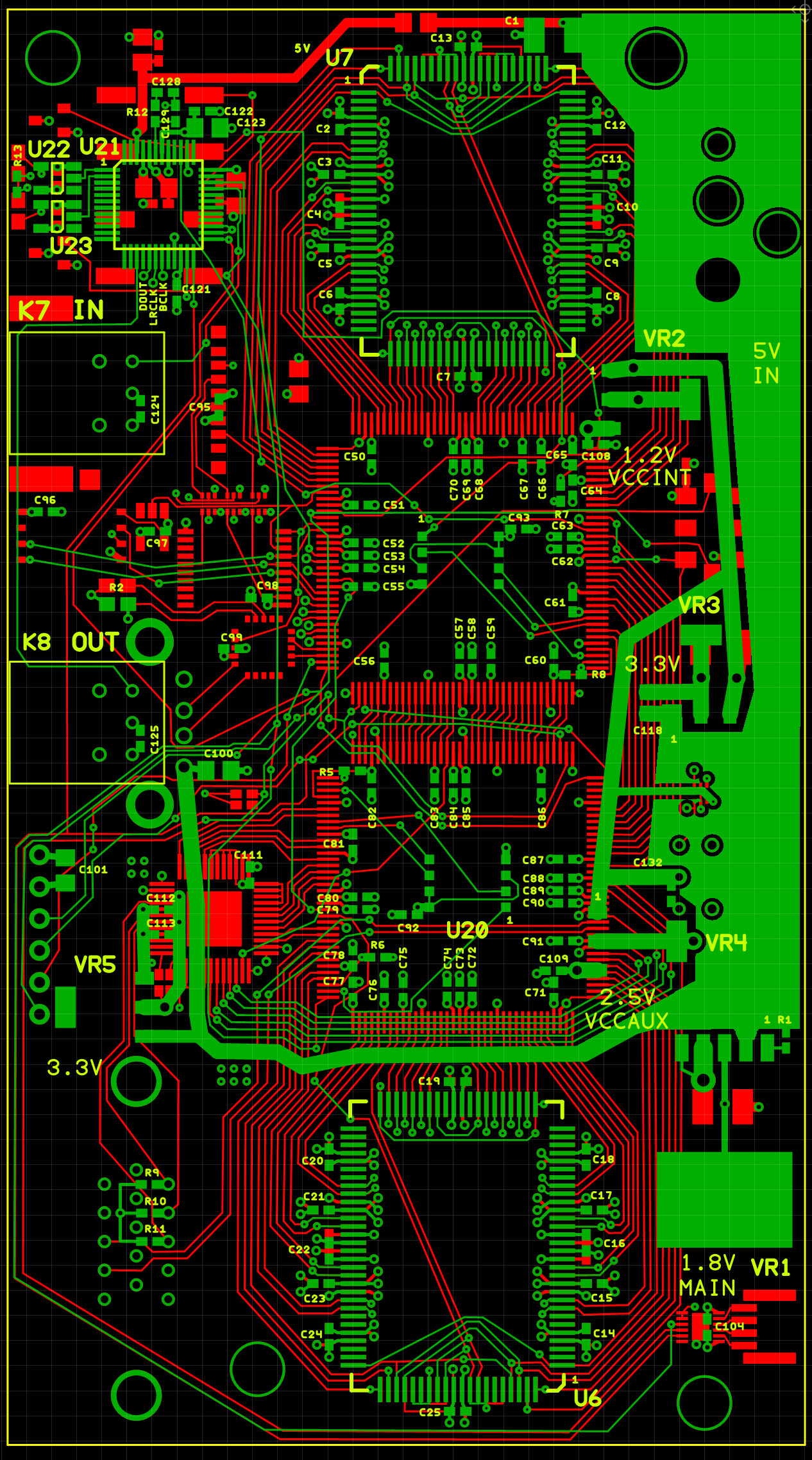

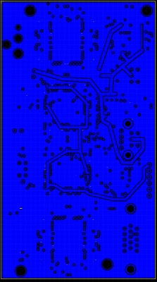

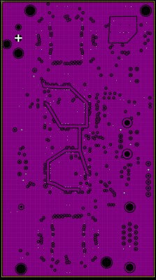

EDIT(1/2/2019): Added views of each layer of the board layout. Revised intentions: no 2nd monitor output. Updated credits for newer members, my oversight.
EDIT(2/1/2019): Updated parts list. Complete?
EDIT(2/4/2019): Updated parts list. Added U21 & U22.
EDIT(2/8/2019): Updated parts list. Removed U22(ADAU1701). Added Optical Rx/Tx modules and other stuff.
EDIT(2/11/2019): Updated parts list. Updated layout pics to V1.1 production run.

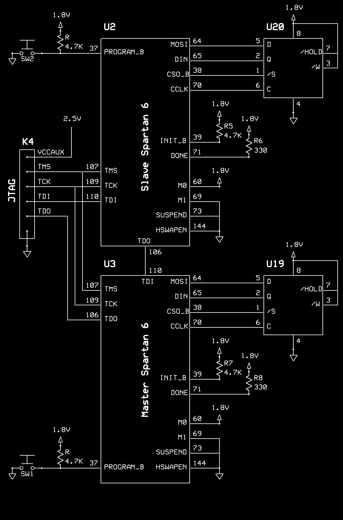

EDIT(2/16/2019): Updated parts list. Added schematic for JTAG interface.
EDIT(3/3/2019): Updated parts list. Updated JTAG I/F. Updated board layout pics to V1.2. Updated capabilities description.Some good video timings HERE. Updated Master/Slave S6 in the V1.2 JTAG schematic.

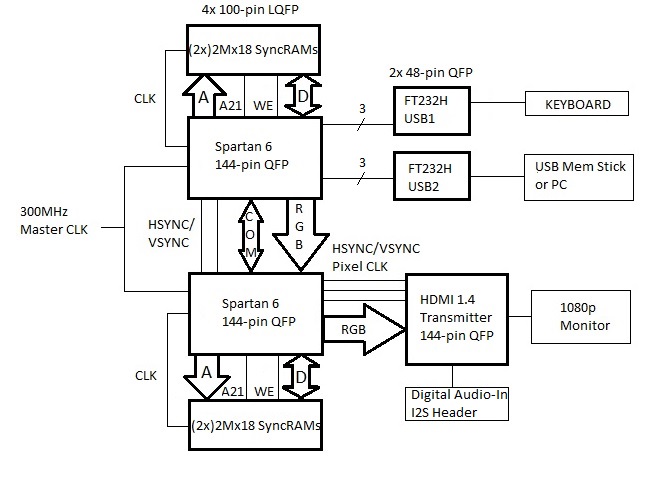

I think it would be wise to use an FTDI FT232H http://www.ftdichip.com/Support/Documen ... FT232H.pdf to interface a USB keyboard to the FPGA.
Also, another FT232H to communicate direct to a PC or a USB memory stick. These are USB 2.0 devices. Scratch the SDHC card idea.
I am investigating an HDMI interface for video output. If it turns out to bee too complicated, I'll just do a VGA out using a high speed videoDAC. Worked very well before.

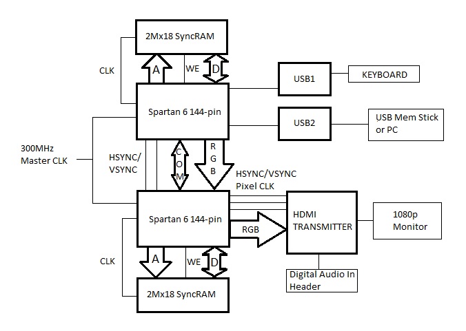

2 2Mx18 RAMs per 144-pin Spartan 6 is too much. Not enough pins. I remember now that's why BGA was looking so delicious back then when I quit 5 years? ago...
Today I came up with a scheme to use 2 Spartan 6's controlling 1 2Mx18 RAM each. Each RAM can hold a video frame and the 1 Spartan 6 sends the RGB data to the 2nd Spartan 6 at which point that Spartan 6 can choose what data to send to the HDMI for output. This is very similar to what I was doing with 2 parallel video boards, except that PVB setup was not capable of page flipping. The bottleneck in this current system looks like it will be the communications path between the Spartan 6's. I don't believe this has to be bidirectional. It will be more of a master/slave setup. I'm getting excited! I know I can do this as I've done it before...
Now I would like to take a break and start looking at the 65Org16 core. The latest one I have I believe is not even on Github. Time to start some opcode trimming and start to see the max speed of the project file using SmartExplorer. It's too bad ISE doesn't take advantage of multiple Intel Cores. This is going to be time consuming.
So far I think absolute worst case is the 1080p pixel clock running @150MHz and the 65Org16 running @75MHz.

Can't you attach two 2Mx18 SyncRAMs to the second Spartan by organize them as either 4Mx18 or 2Mx36 ? Don't know whether this would be helpful, but if only the second Spartan controls the video RAM would the RGB connection between them still required? Perhaps it can be reduced to R|G|B using dedicated commands?
Truly, just marginal more than 280x192 / 6502 / 1 MHz :lol:

You've read my mind! I was busy working on extending the RAM to 4Mx18 per Spartan 6 already. After all I already bought the IC's. Thanks for your suggestion! It will take 1 more pin from the Spartan 6 and an offchip TinyLogic 74series inverter. The RGB info sent from the top S6 to the bottom is neccessary. The HDL will have to chose which RAM output will paint the picture to the HDMI transmitter. This is making the bottom S6 the Master and the top the Slave.
BTW, I've seen Arlet's 8-bit core running at 110MHz on a Spartan 6. Those speeds give a new level to software creation.
I really just now trying to get a grasp on pin count and potential board layout in the near future, so I've included a more up to date block diag. Regarding the FTDI USB IC's, I think I can get away using the RS-232 Tx/Rx pins only? I'm rusty on my RS-232, but no voltage level corrections needed per the datasheet.

Glad that I could be helpful :)
If you can afford two more pins one on each Spartan, I would omit the external inverter and submit A21 and /A21. Then there is no further delay to be considered.
RS-232 is usually running no more than 230400 Bd. With a 10 bit frame (startbit, 8 data bits, 1 stop bit, no parity) this is just 23040 characters per second or roughly one char every 40 µs. Should be no real challenge :D but you may even provide a FIFO for some chars. Handshake isn't use frequently. So things like /RTS or /CTS etc. are often omitted.
What are you intend to do with that RS-232-IF?
Regards
Arne
PostPosted: Sun Aug 26, 2018 4:59 pm
Regards
Arne
Excellent suggestion regarding the A21 line! No delay would be top priority on high speed video.
For the RS-232, I was reminded of the MCP2200 I've used before. I do believe I used just the Tx and Rx and this IC has much smaller real estate. I would definitely use that IC again for a keyboard I/F. However, for the PC/USB memory stick option, I would like a high speed interface to transfer 1080p images. I think that's why I was looking at FTDI's parallel option. But then again if I'm running out of FPGA pins, it might be wisest to use an SD card core internally. But then would have to switch the card back and forth...
PostPosted: Sun Aug 26, 2018 5:17 pm
Posts: 660
Location: North-Germany
I am a bit puzzled :) :oops:
I thought that RS-232 was an optional IF to Spartan 1.
There are already 2 USBs. If you intend USB-1 for keyboard you need to be an USB master. Being that (in theory) you could attach any HID to that USB port. Changing the mode (still being master) to file I/O an USB stick could be used as data source and destination as well. If this USB is capable doing USB2.0 20..30MB/s are possible (but you have to implement a filesystem as well, and a lot of other stuff :| ).
All that could be established for USB-2 as well (I assume).
So I am still a bit puzzled for what purpose you think about RS-232? File transfer would be rather boring. As a diagnostic IF perhaps. The MPC2200 you mentioned appears to me as a chip that adds a COM port to a PC.
Regards,
Arne
