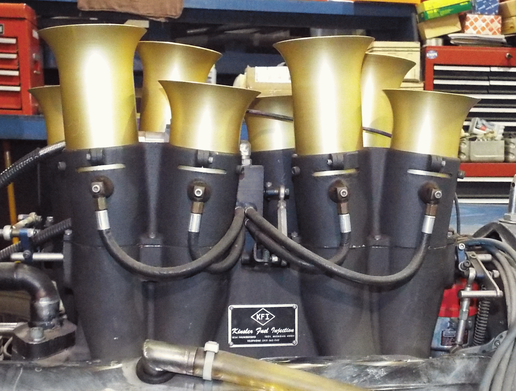

Hugh Aguilar wrote:
Only ignition timing needs to be accurate.
Not so! Fuel injection timing must be equally accurate, as all modern systems inject fuel only during a precisely delineated portion of the intake stroke. There are two components to this: the point relative to the start of the intake stroke when injection is to commence and the duration of the injection. These two factors, along with injector design, determine how much fuel gets injected. As a gasoline engine should ideally be run with a stoichiometric air-fuel ratio to assure total combustion, injection timing is one of the most critical factors in getting best engine performance.¹
Something that complicates the achievement of stoichiometry is the inertia of fluids, which means that the onset of fuel delivery into the intake air stream does not instantly occur when the injector is commanded by the control circuitry to commence injection. This lag is a constant that is determined by the injector design and condition, whereas the interval during which injection must happen is constantly changing as the throttle opening, engine speed and loading vary, further affected by other variables, such as air density and in some cases, the fuel's octane rating. In general, the control circuitry has to start the injection sequence earlier at higher engine speeds in order to compensate for injection lag. If the engine is running at full throttle injection has to start sooner than at part throttle. In all cases, injection must cease before the intake valve closes, as any fuel injected after valve closure will be added to the fuel charge on the next intake stroke, causing the cylinder to run rich. The relationships are complex and the system activity required to achieve stoichiometry is considerable.
Of all the control subsystems in modern cars, fuel delivery control is usually the most complex and demands the most accurate timing. Things have certainly come a long way since the days of the constant-flow injection systems that were developed for race cars and aircraft in the 1930s. :D
¹In modern cars when being driven at part throttle, the engine is run leaner than stoichiometric as a fuel economy measure. Doing so has emissions implications, however, as combustion temperatures are higher, which encourages the formation of oxides of nitrogen. Also, the higher combustion temperatures can adversely affect engine life.

The cars I've seen the fuel injection on used one sprayer for all the cylinders, and it sprayed continually. The computer told it how heavily to spray; but it did not turn off between intake strokes. I can imagine a reason to have a sprayer for each cylinder, but I think you'd want to have it far enough upstream to give the fuel more time to evaporate, and you wouldn't want the intake air to be "striped." :lol:
I am not familiar with any system that operates the way you describe. I certainly haven't seen it all, but I have seen a lot in my 33 years of working on cars and trucks for a living.
The closest thing to what Garth described was probably the early GM throttle body injection system, which was more like carburetion than fuel injection. However, that system was timed, not constant flow. The fuel injection on my race car is constant flow, but injects through individual nozzles located in each intake runner above the throttle plates, which sacrifices low speed behavior for best top end performance. In some respects, it resembles modern port injection systems, but is purely mechanical in operation and is tailored for use with straight methanol or a methanol/nitromethane blend.
File comment: Kinsler Fuel Injection
