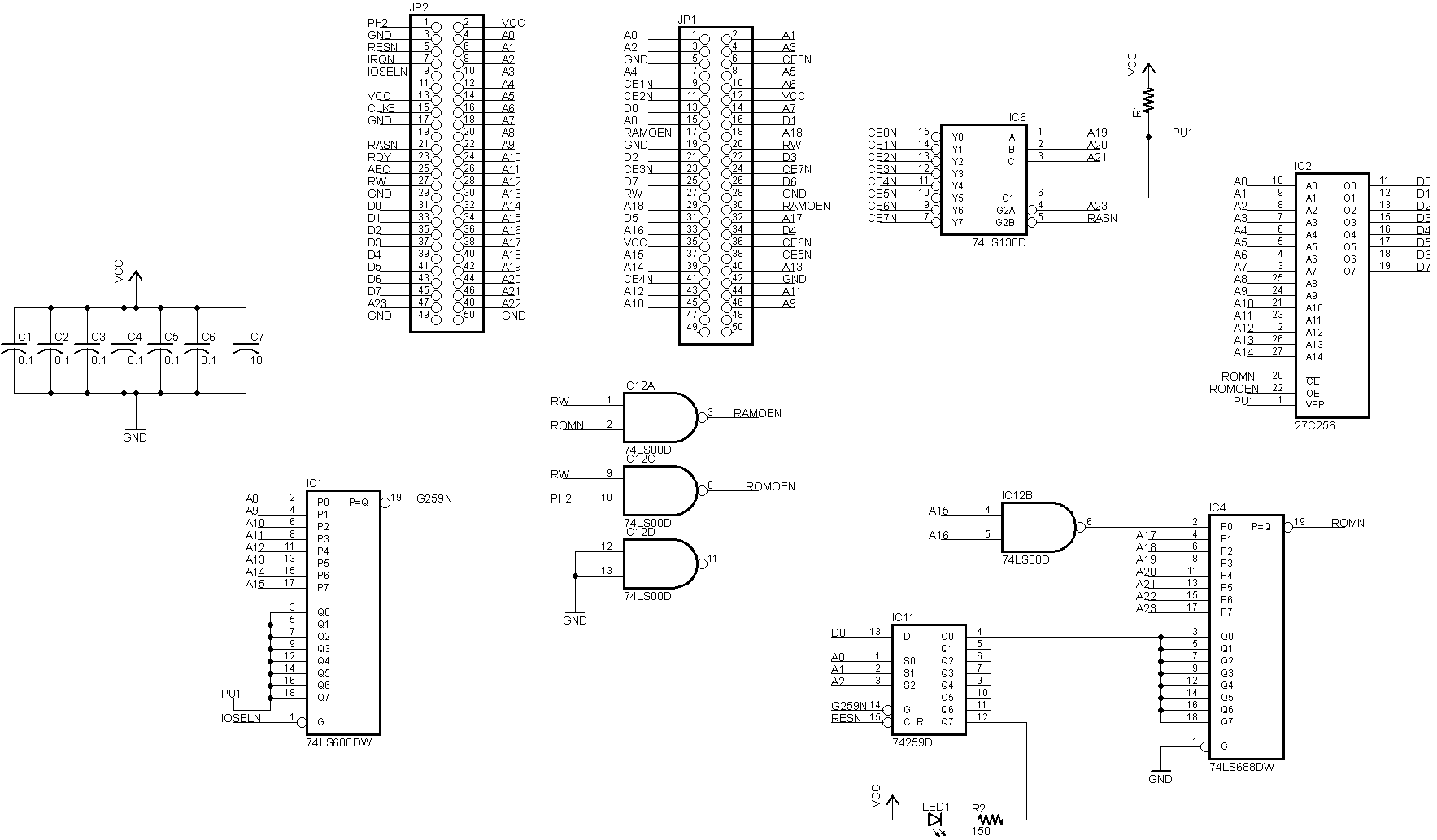

It looks like I'm designing a modular computer composed of five board on a backplane.
Memory Board
- on reset the ‘259 is output is cleared causing the ‘688 to decode the rom address into bank zero $00xxxx.
- ram range is from $000000 to $3FFFFF there is a mirror image of the ram at $400000 to $7FFFFF.
- ram and rom occupy the same range at reset, however the ram outputs are disabled when rom is selected. Ram can still be written however.
- the reset routine will copy a partial image of the rom to ram then set the ‘259 ff so that rom is mapped to $FE0000.
- The ‘259 latch is selected at $FDFFxx in the IO address range.
File comment: FAL Memory Board

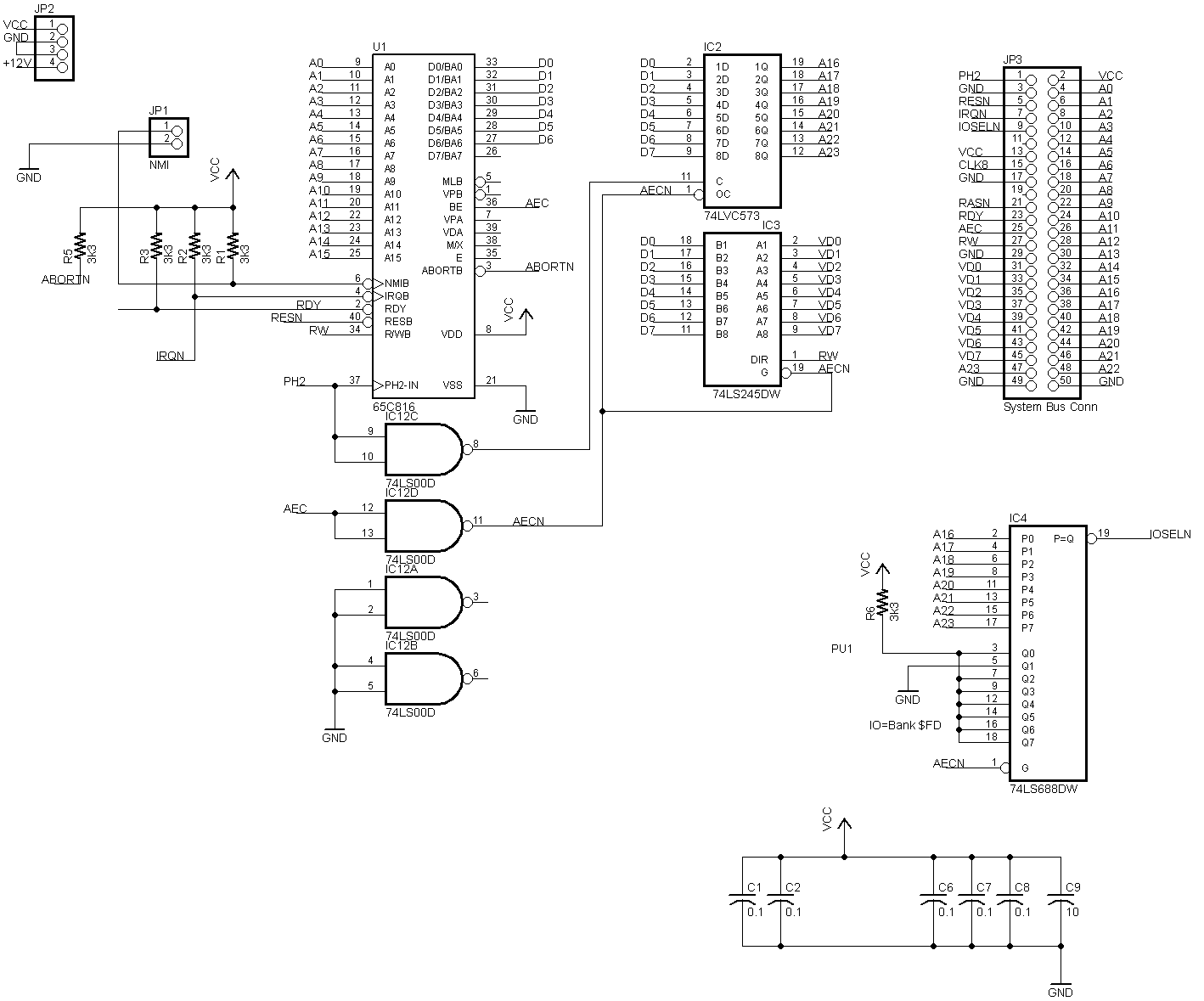

And now for the cpu board. The cpu is just running at 1MHz to keep things simple. I tried to come up with an interface between a higher operating speed and lower speed peripherals but it was just too complicated, complicated by the fact that the VIC-II chip is a bus master on alternate cycles.
CPU Board
- contains the ‘816, address latch and data buffer
- also decodes the I/O address range as $FDxxxx
This all hinges on me being able to find an '816 processor.
I've been working away on pc board layouts as well. It's all being save in my GitHub account.
File comment: FAL65816 cpu board

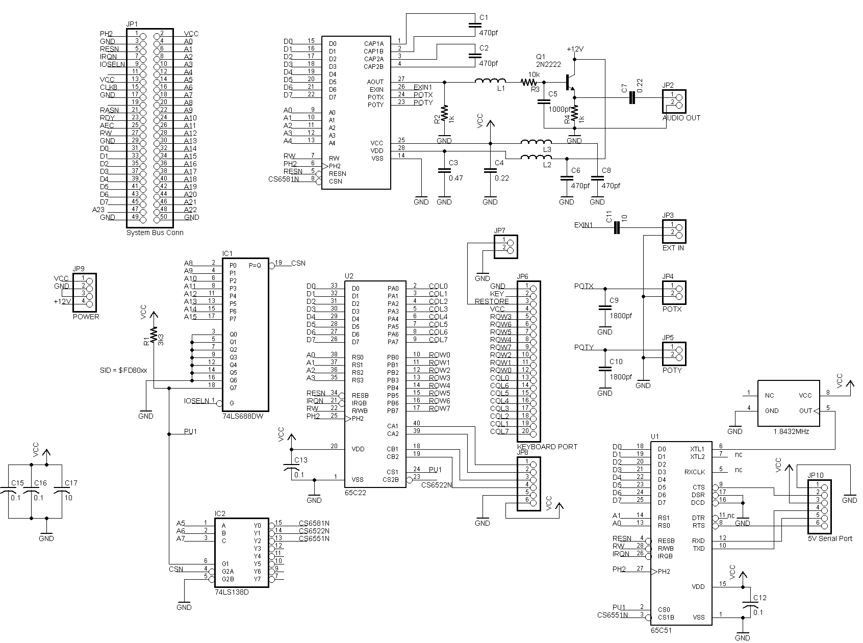

Audio Board
- contains a 6581 SID chip, 65C22 to connect a keyboard, and a 65C51 to connect a TTL level serial port.
- decoded to address range $FD8000 to $FD801F for the SID and $FD80820 to $FD803F for the 65c22 and finally $FD8040 to $FD805F for the 65c51.
A C64 keyboard connector was used as a keyboard is available in my junk drawer.
File comment: FAL65816 Audio board schematic
http://www.finitron.ca

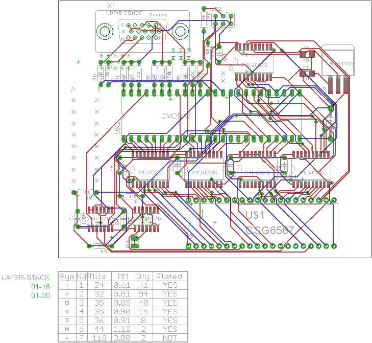

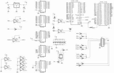

Posts: 449
Updated schematics and board layout for FAL6567. Added a latch on the address bits which ultimately allows 9 bit color instead of 6 bit.
Placed the resistor dac right next to the module to reduce emi.

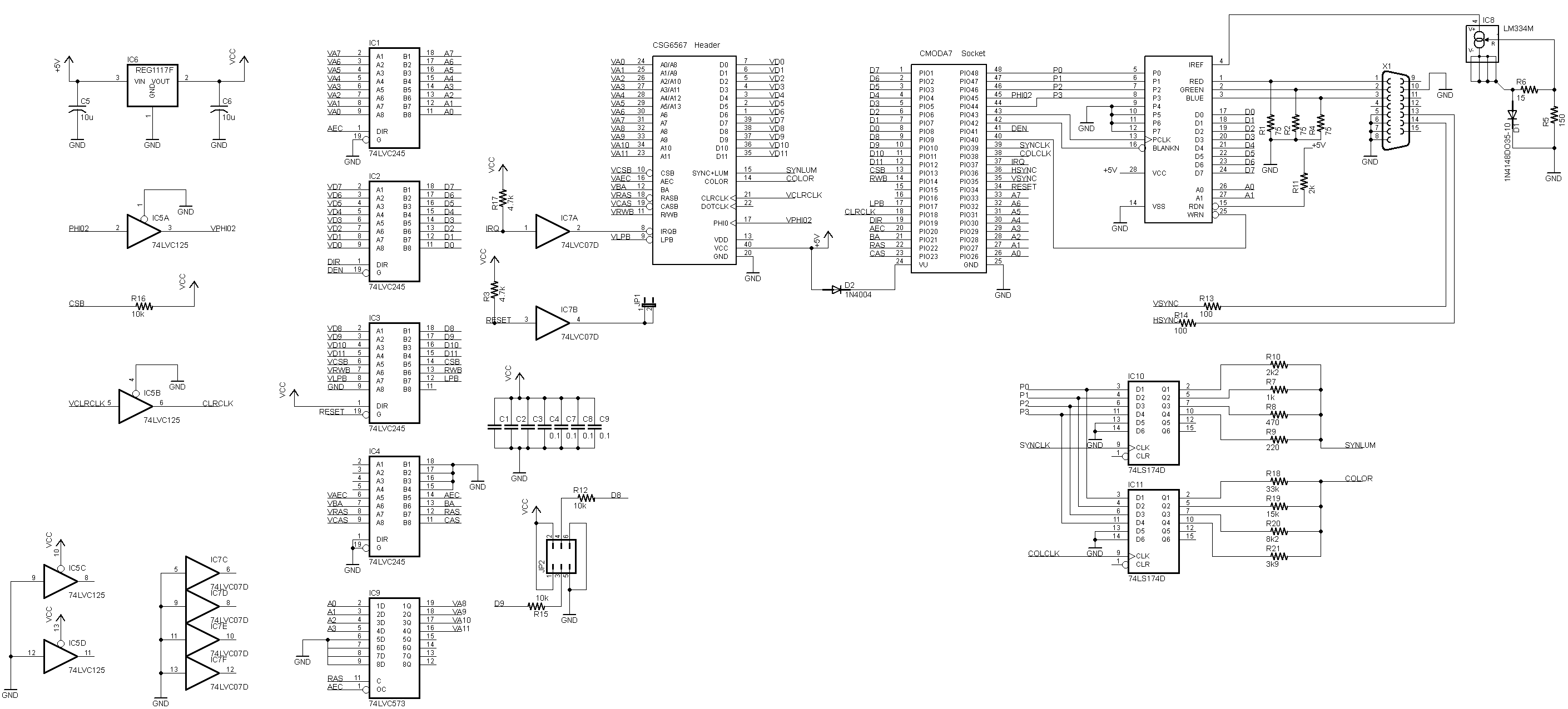

This project is still evolving.
I created another version of the board that uses an ADV476 color palette for the dac output. The reason to use the palette is it requires fewer pins from the cmoda7. A second reason is it allows more accurate color rendition. A four-bit color code can be fed to the dac rather than using nine pins. It ends up saving three pins as a clock and blanking signal are needed in addition to the color code. The three pins could be put to use to generate a composite output signal for at least monochrome output. It’s somewhat dubious to use the ADV476 as it’s an obsolete part.
One thing I’m not sure about is if the two four bit dacs for used for generating sync, luminance and color components will work. The color output is open source on the VIC-II and recommended there be 1k to ground. So on the assumption that that output has a 1k resistor attached to it I made the dac so that the voltage at the output is approximately 1v at maximum output. According to the C64 schematic there is a pot available to adjust this a little bit.
The other output for sync+lum is open drain with a recommended 500 ohms to +5v. So I adjusted the dac resistors to have this output at about 1v again.
I seem to remember reading somewhere signal measurements in the range 0.0 to 1.0V.
File comment: FAL6567 schematics with color palette
PostPosted: Sun Mar 11, 2018 1:08 pm
Posts: 449
I had to adjust FAL6567’s base clock frequency slightly from 33.750MHz to 32.727MHz. The MMCM (clock pll) can only multiply by up to 64 and I thought it could go up to at least 128 so I had it set at an illegal value of 66. 1 clock cycle was trimmed off all the timing shift registers. This may cause a problem of the ras high time (90ns instead of 120ns) being too short in the case of extra sprites mode. This shouldn’t affect the default operation.
The 32.727MHz is exactly 32 times the phi02 clock rate and exactly 4x the 8.1818MHz dot clock rate. There is also an exact divide for the color burst frequency of 3.58MHz.
