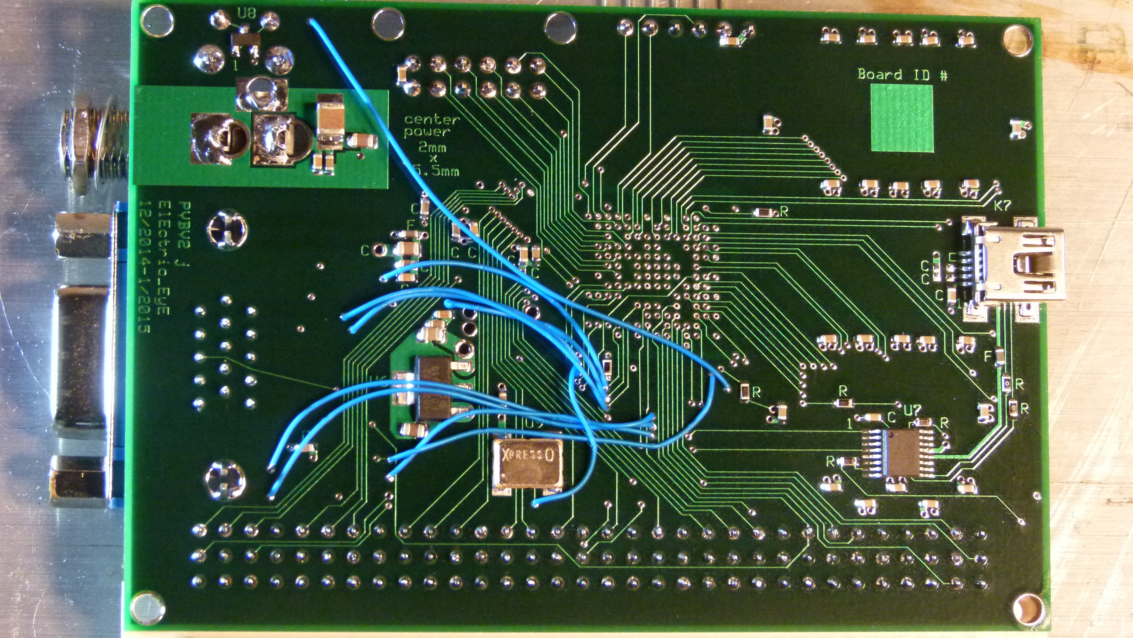

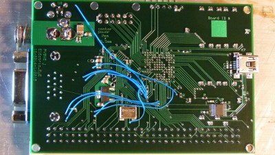

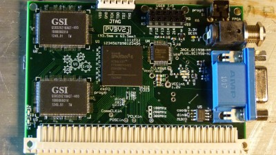

First some pics! If the board is fully functional, these will be the pics I add the the header post on this thread. Unfortunately, I head to work tomorrow so it'll probably be about a week of on-off testing.
The 300MHz check box should be darkened, as that 300MHz can oscillator is what's soldered underneath.
First a pic of the top of the board. Again, after soldering in the connectors I put the board into a heated isopropyl solution in an ultrasonic cleaner I purchased on Ebay way back. Nice and clean after about 5 minutes.
Then a pic of the bottom... You can see I've reached the limits of a 4-layer board with the blue 30AWG WW wire making less critical connections.
These connections are between:
The SPI FLASH PROM and FPGA
The 300MHz main clock signal to the FPGA
The Program button to FPGA.

Bittersweet moment: ISE14.7 sees the FPGA and SPI FLASH PROM, like it did in PVBV2.h, and successfully programs either one, but no video output. Not even an out of range, which is not an encouraging sign.
I set up all the constraint info and the FPGA PLL for a 300MHz clock input from the onboard can oscillator to output pixel clocks @148.581MHz and an internal cpu clock at 1/2 speed.
I've limited time each night to dedicate. I'll have time tonight to desolder the 300MHz oscillator and solder in a known good 200 MHz one.
PostPosted: Thu Feb 05, 2015 1:21 am
ElEctric_EyE wrote:
...I'll have time tonight to desolder the 300MHz oscillator and solder in a known good 200 MHz one.
Instead I drag out the 'scope and check for any output from U9, the 300MHz can oscillator. I see no clock... Checking part # and pinouts.
PostPosted: Thu Feb 05, 2015 1:38 am
Jeezus, I would've fired myself. This 300MHz can oscillator, part# FXO-LC726R-300, is a 2.5V part! I'll have to settle for 200MHz for now, as I'll dismount the 300MHz part and mount the proven 200MHz can oscillator.

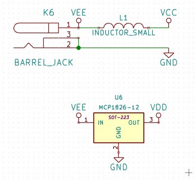

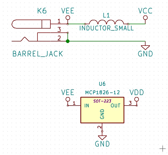

Without the need to create any special symbols for FPGA's or any other IC's in Eeschema (the schematic editor portion of KiCAD), one can save ALOT of time. The barrel jack connector may not even be needed, but these are the NETs Eeschema passes on to PCBnew for the power planes. Although in my project VEE is not a plane, it's a filled copper pour.
Through some experimentation, I discovered this is all I needed to do in Eeschema for a rather complex FPGA design and can add bypass cap's later in PCBnew (PCB layout editor). Also, any pin can be manually assigned to one of these: VCC, VDD, VEE, GND.
So...
VEE is unfiltered 3.3VDC.
Power planes:
VCC is filtered 3.3VDC.
VDD is filtered 1.2VDC after the VReg.
GND is GND.

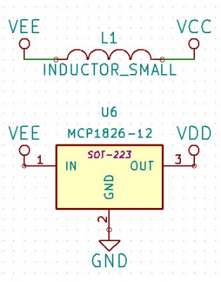

PostPosted: Fri Mar 13, 2015 11:32 pm
I was able to reduce the schematic to a minimum. The barrel jack connector was not needed.
