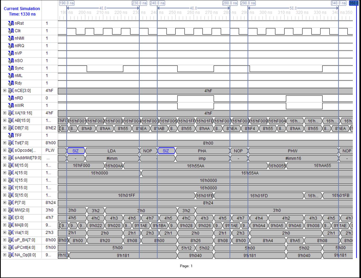

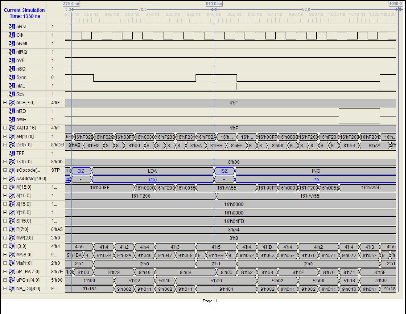

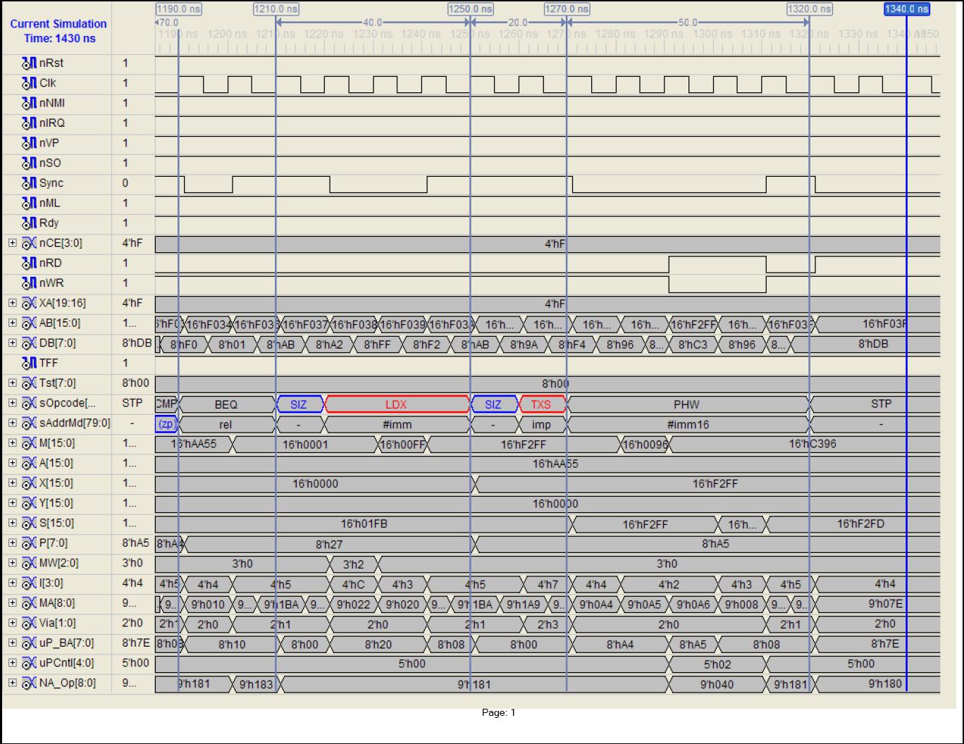

PostPosted: Sun Dec 07, 2014 4:52 pm
Posts: 760
Location: Huntsville, AL
Finished adding in the register override prefix instructions. Took an unforced error and took a wrong turn last Saturday and Sunday. Attempted to make S into an accumulator like X and Y. After running into a wall on how to implement this, I sat down and mapped all of the effects of the register override prefix instructions and finally concluded that making two simultaneous register swaps with one prefix code was not feasible. Furthermore, it precluded the use of A for stack relative instructions using the auxiliary stack (Y -- stack pointer) in zero page.
Therefore decided to leave the register override prefixes to OAX, OAY, and OSY. OSY and OAX can be combined; OAX and OAY are mutually exclusive. OAY and OSY are also mutually exclusive. The register overrides can be combined with the addressing mode modifier prefix instruction IND.
When OAX or OAY are prepended to an instruction, A replaces X or Y as the index register. A becomes the pre-indexing index register when it replaces X, and it becomes the post-indexing index register when it replaces Y.
When OSY is used, Y becomes the stack pointer, but S does not become the index register. However, S does gain access to all of the instructions specific to Y: STY/LDY/CPY, INY/DEY, PHY/PLY, and TYA/TAY. There is only a single cycle penalty imposed by the OSY prefix instruction on the execution of these instructions with S as the source/destination register compared to Y as the source/destination register.
I've wrapped up the project to date and updated its GitHUB repository for those interested. I've added a DOCS subdirectory and added a table of the instructions and addressing modes gained by implementing the OAX/OAY/OSY/IND prefix instructions. In addition, I've included a write-up on the FORTH VM analysis I conducted to determine what additional instructions and features to include to support ITC/DTC FORTH VMs.
All of the additional capabilities have not caused a significant increase in the size of the core:

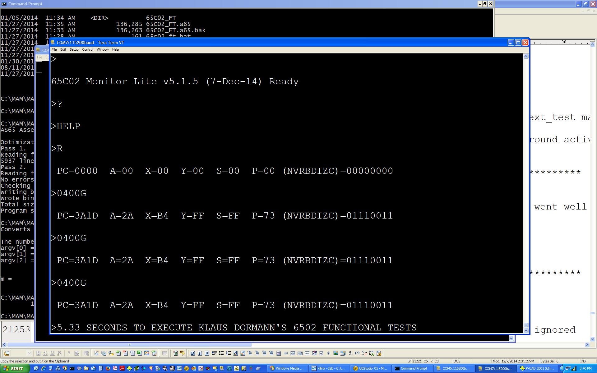

PostPosted: Sun Dec 07, 2014 9:52 pm
Posts: 760
Finished configuring Daryl's SBC2OSLite Monitor for the M65C02A and checking the FPGA UCF for the M65C02/M16C5x Development Board. With the M65C02A running at 14.7456 MHz, the clock frequency of the on-board oscillator, and without invoking a DCM clock multiplier, Klaus Dormann's basic set of functional tests run in 5.33 seconds. (Timing performed using a handheld stop watch.)
I've attached a screen capture of the terminal screen below.
File comment: Execution of Klaus Dormann's 6502 Functional Tests using 14.7456 MHz (without DCM clock multiplier): 5.33 seconds.
And the tests are linear with operating frequency. When the M65C02A is targeted to the Chameleon board, with a on-board 29.4912MHz oscillator, the 6502 functional tests complete in 2.77 seconds. It's nice to know that the core will execute twice as fast when operated using a clock twice as fast. :D

The following trace (note: the clock period shown is not representative of the core's performance) shows the operation of the core for the LDA #imm and PHA instructions when preceded by the SIZ prefix instruction. Also shown is the PHW #imm16 instruction that has been added to the M65C02A core from the instruction set of the W65C816S. It execution shows that it is three cycles faster than the SIZ LDA #imm16; SIZ PHA; sequence of instructions.
The following trace shows the operation of the core for the LDA (zp) and INC zp instructions when preceded by the SIZ and ISZ prefix instructions, respectively. Notice that the operation of the INC zp instruction has been increased from 8 bits to 16 bits, and that its zp direct addressing mode has been converted to zp indirect addressing mode.
The following trace demonstrates how the SIZ prefix applies to the LDX #imm and TXS instructions. Notice that the system stack page has been relocated to page $F200. It will remain located in this page until it is reloaded with an 8-bit TXS instruction, at which time the upper half will be loaded automatically with $01.
