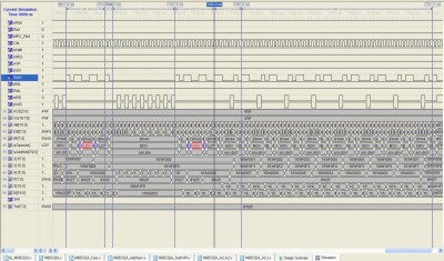

Completed testing of the M65C02A core's enhanced instruction set. The following two diagrams provide a map of the instructions as currently implemented.
File comment: M65C02A Enhanced Instruction Set Opcode Map: 0x00-0x7F
File comment: M65C02A Enhanced Instruction Set Opcode Map: 0x80-0xFF
Now the issue is how to add the features previously discussed that can be used to support a FORTH VM. Before continuing, I think that I'm going to wrap this thread up and start another that will be focused exclusively on what features and primitive instructions are needed to implement a fast FORTH interpreter with the M65C02A soft-core processor.
Several contributors to this thread have recently tapped on a thread in the FORTH sub-forum, 6519 Forth Processor. I am going to have to take some time to study the instructions in that microcomputer that support DTC FORTH.
Edit: added missing word, time, in the last sentence.
Edit: added link to GitHUB repository which has been updated will all the files for this version of the core.

There are three modes supported for the source and destination pointers, which means that the M65C02A MOV instruction supports 9 different combinations of the source and destination mode settings. When the source mode is set for increment and the destination mode is also increment, the M65C02A MOV instruction behaves like the MVN instruction. Similarly, with the modes both set for decrement, the instruction behaves like the MVP instruction. When the hold mode is used, the MOV instruction can easily be used to access FIFOs like those used in 16C550-compatible UARTs.
The instruction assumes that the transfer length count is loaded in A, the source pointer is stored in X, and the destination pointer is stored in Y. The instruction can be used as an uninterruptable block move, or it can be combined with a conditional branch instruction to allow the block move to be interrupted. The IND prefix instruction is used to select the interruptable MOV instruction. To facilitate its use with a conditional branch instruction, the decrementing of the transfer length counter (A) set the N and Z flags (like the DEC A instruction).
The instruction terminates the block transfer when the Z flag is set following the decrementing of A, or when the IND prefix instruction flag is set. An initial value of 0 for the transfer length count will move the entire 64kB address space of the M65C02A. In the uninterruptable mode, the initial transfer requires 4 memory cycles, but each subsequent transfer only requires 2 memory cycles. In the interruptable mode, each transfer cycle requires 5 memory cycles plus 2 memory cycles for the conditional branch for a total of 7 memory cycles per transfer. (I think this is similar to the '816 transfer cycle count for the MVN/MVP instructions.) Setting up the registers for the transfer requires 10 or 12 memory cycles; 12 cycles are required if the transfer length is greater than 255 bytes.
The following figure shows both modes of the M65C02A MOV instruction:
File comment: M65C02A MOV Instruction Timing
Michael A.
 Post subject: Re: M65C02A Core
PostPosted: Mon Jul 13, 2015 3:37 am
Posts: 3349
Nice work, Michael -- glad to hear of further progress on this project! And the ability to blast a bunch of bytes from/to a 16C550 FIFO or other burst source/destination will make for a tidy boost in throughput.
In one respect I found your choice of terminology odd. What you refer to as an interruptible bock move seems to me to be better described as simply a byte move. There's nothing "block" about it, unless I'm missing something. (I realize it updates the source, destination, count and sets the flags.)
Is it possible this option could instead be controlled by the operand byte you mentioned? It seems the operand byte would have extra bits available, since the src & dest mode require only two bits each. Perhaps you've already thought of this idea but there's a gotcha! :? :D
cheers,
