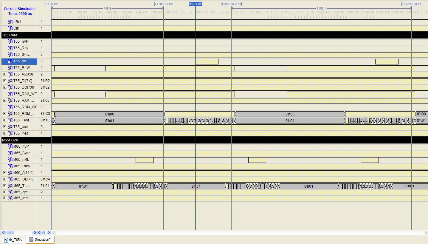

I recently had the need to create a project using the T65 6502 core. To ensure that I had a recent version of the core which passed Klaus' 6502 functional test suite. (Note: I did not allow the functional tests to execute the BCD and Binary arithmetic. Instead, I artificially looped the functional test back to itself after all other tests had been completed.) I was curious to see if the M65C02A core would demonstrate its memory cycle efficiency when running Klaus' test program. It appeared when benchmarking the M65C02A core with figForth 1.0a, that the M65C02A was roughly 40% faster.
The test bench runs the functional test simultaneously using both the T65 core and the M65C02A core. For the tests performed, the M65C02A requires 74687 cycles to execute 50484 instructions, and the T65 requires 119638 cycles to execute the same number of instructions. Thus, for the M65C02A, the CPI is 1.4794, and for the T65, the CPI is 2.3698. The CPI % difference is that the M65C02A is approximately 37.57% faster than the T65 at the same clock rate on this application. This result is similar to the performance advantage noted on the figForth 1.0a Sieve of Eratosthenes benchmark. (Note: the T65 core is a cycle accurate model of the 6502 microprocessor, while the M65C02A is not, and the M65C02A does not implement any of the undocumented 6502 opcodes sometimes used by games and copy protection schemes.) These additional results add additional credence to the improved performance claimed for the 65CE02 as a result of the elimination of dead/redundant memory cycles.
File comment: Comparison of Execution Time of T65 and M65C02A cores on Klaus Dormann's 6502 functional test program.
Edit: [MichaelM] The original post listed the 65SC02 as the processor variant with reduced number of cycles per instruction. Dr. Jefyll pointed out the error, and I've corrected the reference above and provided a link to the post in the Forth topic to which the above text intended to refer.
Michael A.

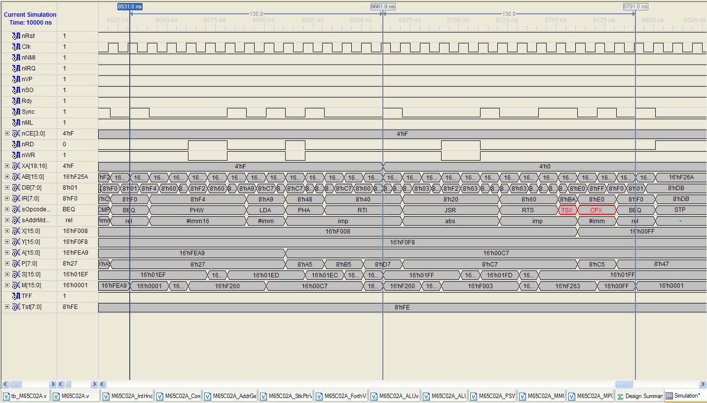

Work continues to verify all of the implemented instructions for the M65C02A core.
Below is an instruction sequence which demonstrates the Kernel/User mode of the M65C02A core. Bit 5 of the PSW has been designated as the Mode bit (M). By default the mode bit is set after reset, all interrupts, and traps/exceptions. The kernel mode stack is used to push the user mode PC and PSW. Only an RTI instruction may modify the mode bit, and only after the PC has been pulled from the kernel mode stack.
The first marker indicates the start of the code sequence used to push the address of the user mode routine and PSW. The middle marker designates the point in the execution stream where the transition is made from the kernel mode to the user mode. Leading up the transition, it can be seen that the stack pointer S (Sk) starts at 0x01EF and decrements as the three bytes are pushed onto the kernel mode stack. When the RTI instruction is executed, the values just pushed are pulled and Sk increments for each pull. After the last pull, when SYNC is asserted at the middle marker, the core is operating in the user mode, and the change in the stack pointer can be noted by a change in the value shown on the screen: from 0x01EF to 0x01FF. The first instruction in the user mode is a call (JSR) to a single instruction (RTS) user mode subroutine. After returning from the subroutine, the user mode stack pointer (Su) is transferred to X and compared with 0xFF. Since the test bench stops at an even address, the comparison passed.
File comment: M65C02A Core Mode Switch from Kernel Mode to User Mode
The following is a hand assembly of the test routine described above.
F25A: F460F2                phw #ModeSwitch
F25D: A9C7                  lda #$C7            ; NVIZC set, user mode selected
F25F: 48                    pha                 ; PSW for user mode routine
F260: 40        ModeSwitch: rti                 ; switch mode to user mode
F261: 2003F0                jsr $F003           ; call user mode subroutine
F264: BA                    tsx                 ; read user mode stack pointer
F265: E0FF                  cpx #$FF            ; Su should be $FF after return
F267: F001                  beq *+2             ; skip if equal, else stop
F269: DB                    stp
F26A:                       stp
If the X register needed to be preserved, then the following code sequence can be used to test the stack pointer directly:
F264: 8BE0FF                cps #$FF            ; Su should be $FF after return

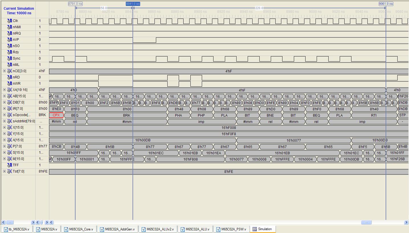

The following diagram shows the execution of a BRK instruction. The key take away is that the operating mode changes after the PC and PSW have been pushed onto the kernel mode stack: the M bit is set (PSW[5]), the D flag is cleared, and the I flag is set. The IRQ/BRK routine executed simply saves A and checks that P has D clear and I set, and then returns. After the RTI, the mode bit is clear, which means that the processor has returned to the user mode; also note that S is set back to 0x01FF as it was before the BRK instruction.
File comment: M65C02A Mode Switch from User to Kernel Mode Using BRK.
Michael A.
