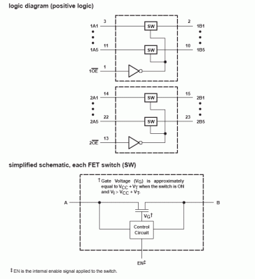

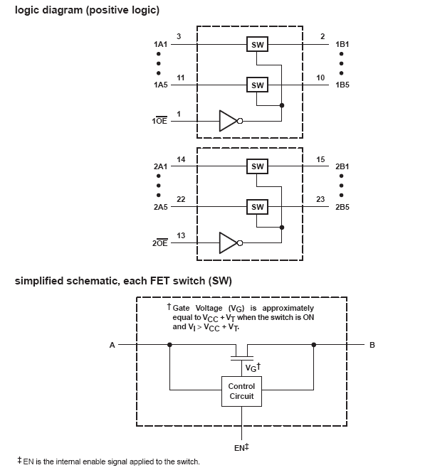

Interestingly, some of the level conversion chips (like the 74cb3t3384 I linked to above) offer essentially zero propagation delay. That's because the device is a transmission gate, and current can travel right through it. IOW the signal isn't buffered or amplified; it actually conducts through the device. It behaves basically as a 5 ohm resistor (except when tri-stated). I'm not sure I understand how the level shift aspect works -- is it acting as a Source Follower? Bi-directional, no less?? -- but I expect some of our members understand the fine points of FETs better than I. Meanwhile the datasheet tells me how to use it, and I'm comfortable with that.

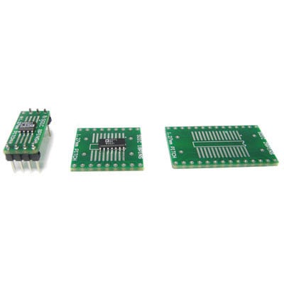

74cb3t3384 seems only to come in SMD :(.
PostPosted: Wed Mar 25, 2015 12:26 am
Posts: 8433
Not a problem, if you can spend $8 or $10 on an adapter to put it in a DIP socket:
http://www.jameco.com/webapp/wcs/stores ... 2130263_-1 :
or http://www.jameco.com/webapp/wcs/stores ... =CAT151PDF :
