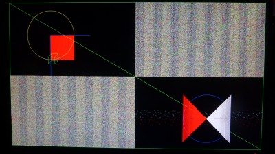

First:
I'm using an ASUS MT276HE LCD flat panel display for my desktop computer and a custom video hardware project.
The desktop computer outputs an HDMI signal into the HDMI-1 port of the monitor. I use this computer for Xilinx ISE14.1 and according to the monitor 'Information' on this input signal, the video board is outputting a 1920x1080 @60Hz.
The hardware project outputs a RGB signal to the monitor's RGB port. The monitor reports an input signal of 1920x1080 @50Hz.

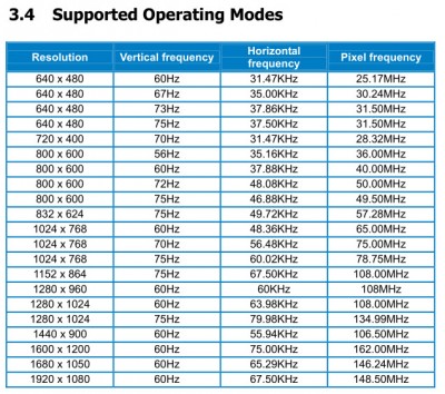

For this monitor the recognized resolutions according to the owners manual are below. I initially focus on the last line for 1920 x 1080 @ 148.50MHz pixel clock...
Second:
The custom video board has an onboard 100MHz can oscillator. From this the PLL divides by 5 for 20MHz, then multiplies by 52 for 1040MHz. For the video generator portion, this 1040MHz is divided by 7 for 148.57MHz, very close to the spec. Then it is divided by 14 for cpu section & hardware circle/line/pixel plotter, which run @ 1/2 of 148.57MHz successfully interfacing to the external SyncRAM.
The cpu programs the Horizontal/Vertical Sync Generator with the following spec's:
LDA #1920               ;2570 (2200 ideal for 67.5kHz) total H cycles      @148.5MHz 17.306uS ->  57,782kHz
                  STA hVIDEO
                  LDA #25                 ;55
                  STA hFRONT
                  LDA #550                ;550
                  STA hSYNC
                  LDA #75                 ;95
                  STA hBACK
                  LDA #1080                ;1139 total     @148.5MHz ->  1139 x 17.306uS = 20.09mS = 49.762Hz
                  STA vVIDEO
                  LDA #2                   ;2
                  STA vFRONT
                  LDA #55                  ;55
                  STA vSYNC
                  LDA #2                   ;2
                  STA vBACK

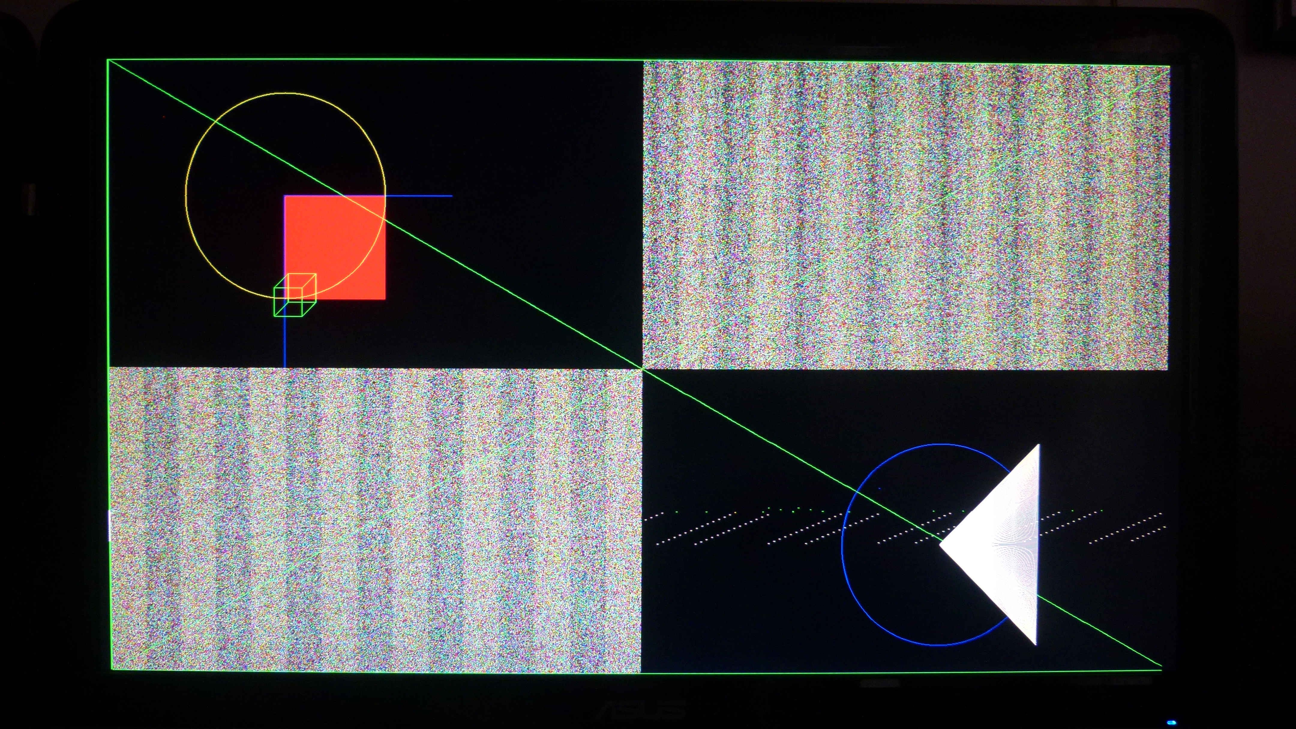

Thanks Mike. There's a few issues to be resolved yet, but I posted not only to show it's possible for a home brew system to go HD, but because I've a question: When I try to match the pixel, horizontal and vertical frequencies to what is spec'd in the monitor's User Guide (which I posted above), the picture does not fit. Interestingly too, 1920x1080 @50Hz is not one of the reported modes in the guide, but the monitor still recognizes it.
EDIT: Also an interesting note. At this fine resolution, a radar sweep of a line drawing algorithm is useful as a fill for a circle for example. In the above pic, on the bottom right, I stepped the line drawing by 2 so one can see the interesting patterns.
PostPosted: Tue Jan 28, 2014 6:56 pm
I forgot there was a problem with dx vs. dy in my line generator module. It cannot draw a diagonal line across the entire screen yet (although it seemed to work fine in 1024x768), so I had to add 2 software code to add 2 more lines to complete the diagonals. I also had to add 1 to the error accumulator in the line generator.
Also, I had to make a small change to the display module so the SyncRAM output is sync'd with the HV sync module, a delay of 2 cycles was needed. Now almost everything is good, except the random (white and red ) pixels which I suspect is a timing issue.
PostPosted: Wed Jan 29, 2014 4:44 pm

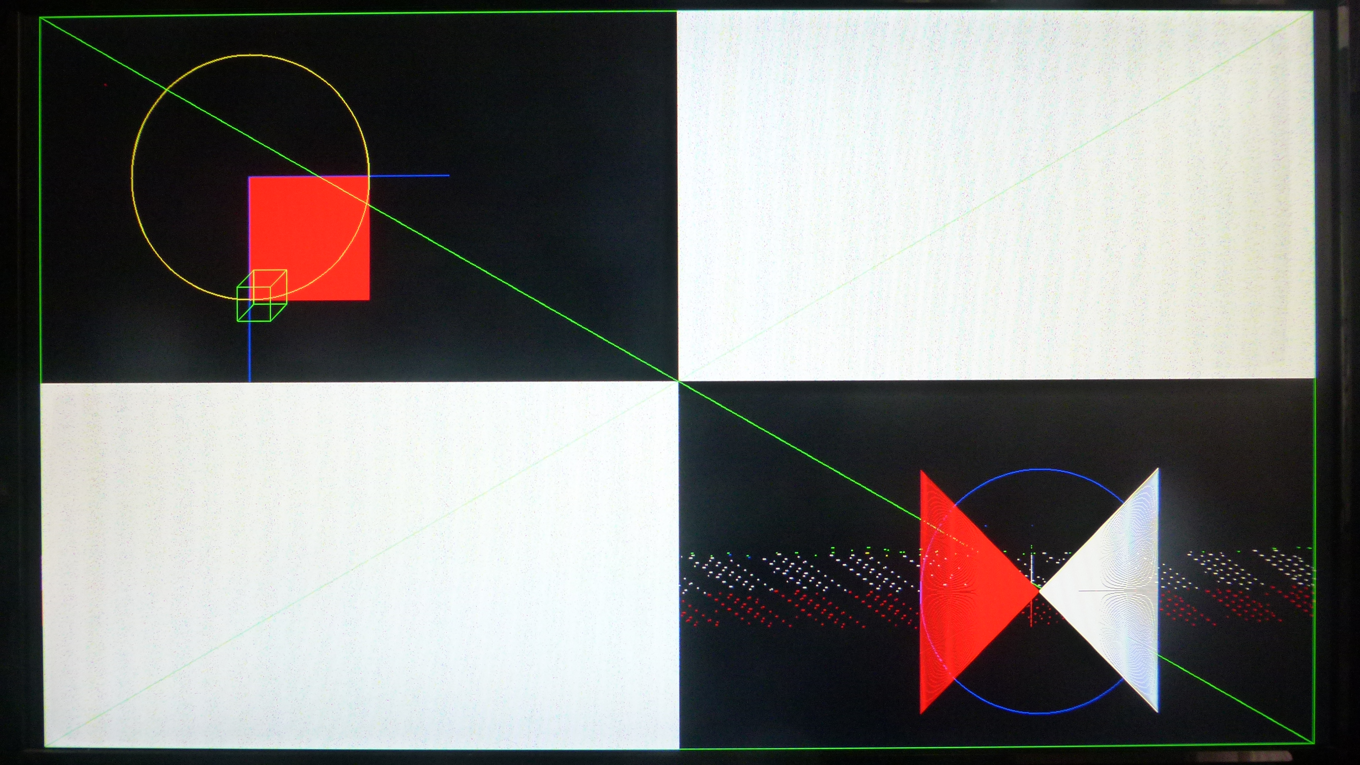

Now I have 4 PVB's outputting the same video.
With the pixels so small and each board adding noise in the form of maybe a 1/4 pixel, it becomes obvious now that this noise is going to be the enemy at this high resolution. I'll add in all the .1uF bypass caps on every board now and report back.
Here's a pic. Still extraneous data being written to the SyncRAM which is most visible in the bottom right. The noise I speak of is most noticeable in the red triangle. It almost appears solid red. Hopefully bypass caps will fix this.
PostPosted: Tue Feb 04, 2014 7:49 pm
The extraneous pixel problem has been fixed. It was a hardware timing problem with the SyncRAM R/W signal, it was late by one cycle. The hunt for the problem revealed to me that I could remove a state from the line plotter as well. This is a full cycle, so it effectively doubles the plotting time of the hardware state machine....
Strange that it only reared it's head when I plotted consecutive lines:

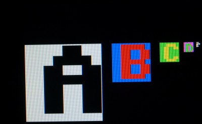

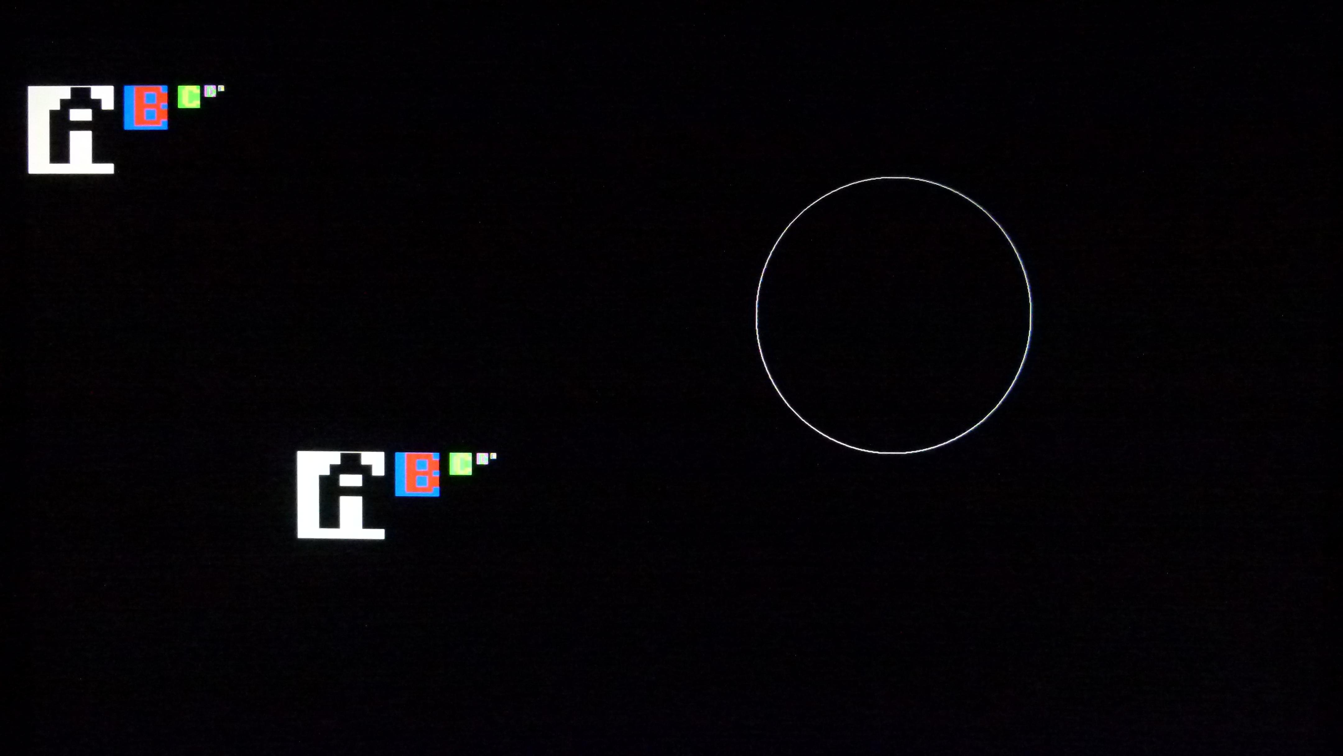

PostPosted: Wed Feb 12, 2014 1:48 pm
Got the copy/paste working, but reading the SyncRAM was only successful at 1/4 speed of the pixel clock, i.e. ~37MHz. It is a state machine that does back-to-back Read/Writes, 2 cycles per operation. 1 cycle to set up the address first, the second cycle to read or write the data as according to the data sheet.
If a write is successful at 74MHz and not a read, I suspect the FPGA data-in lines need to be delayed by an amount less than 1 cycle. I will have to investigate on delaying the IOBs on the FPGA.
In this pic, the upper left has a white triangle which was done by a single step radar sweep of the line generator. (The other triangles are double stepped). An upper portion of that is copied/pasted to another region of the screen. The second 50x50 pixel copy/paste is from the center of the upper left circle. It has been copied to the bottom right of the screen.
The purple circle fill is not successful by plotting concentric circles of decreasing radii...
As far as what is next in 1920x1080 mode, I think a hardware text plotter is in order after I get the Read/Write working @ 74MHz.
I don't think sprites will be possible as 98% of the RAM is used for the screen. However, 1 more mode is possible with 2 FPGA PROMs available. That will be in another thread later.
Here is the simple 65Org16 code for the 2nd copy/paste:
                  LDA #50
                  STA bXlen
                  STA bYlen
                  LDA #300
                  STA bXc
                  LDA #210
                  STA bYc
                  LDA #1200
                  STA bXp
                  LDA #850
                  STA bYp                 ;BLIT!

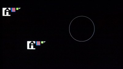

PostPosted: Mon Feb 17, 2014 12:42 am
ElEctric_EyE wrote:
...I suspect the FPGA data-in lines need to be delayed by an amount less than 1 cycle. I will have to investigate on delaying the IOBs on the FPGA....
That was brought up here. I have gotten the CoreGen tools to make one in Verilog, like I believe Arlet had done in that thread. I just wasn't up to his par at that time in my development, so I wasn't able to pursue his ideas.
It's not as simple as I thought it would be either. It will require another module, I will get into it very soon on a new thread.
I was off experimenting yesterday and today making a line scroll left to right then left again. Since the hardware line plotter only looks for the last 1 of 4 coordinates to start it's job, I thought I would post some simple code.
I got tired of the 'snow effect' real quick, so I sent the VSYNC signal into the 65Org16 as 1 of the control flags so the cpu only sends a plot command during a non-active vsync, so no tearing effect like if I would've send the command during a non-active hsync. (Also, as stated before, the cpu is halted by RDY when the hardware plotter is outputting data to the SyncRAM)
It's pretty cool, nice and short. I will have to make a video, it's very fast (the 'delay' code is at the bottom):

I almost broke the machine. I decided to stop progress for today and save. I should've saved my first success...
I had success with 128x128, 64x64, 32x32, 16x16, but the original 8x8 I have a problem melding with the current logic. I'll work on it, also a left/right alignment issue...
The camera cooperated with me today for a close-up of pixels, looks like some noise maybe, not visible to the naked eye.
You're idea of a pointer, like for use with a hardware mouse pointer, shouldn't be too difficult using the blockRAM.
Currently, I'm saving the blockRAM for use when I have a hardware ellipse plotter. Then the vector line drawing and real 3d animation begins.
File comment: 8x8 not working yet on 1920x1080, left corner

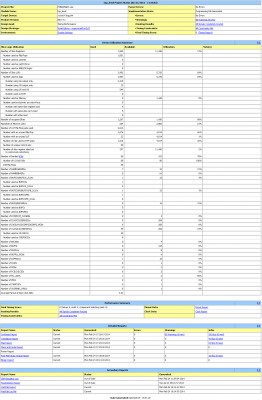

Some of the device usage seems to have gone down:

Alright!
Got several problems fixed now on 1 PVB.
Today I fixed the Verilog character plot code so it will plot 5 different sizes, x & y the same. Not too interested in using up even more resources for different x's & y's (i.e. 16x8, I pursued it for awhile).
So the character plotter can now plot 8x8, 16x16, 32x32, 64x64 and 128x128.
Also, I was able to increase the speed of the part of the module which plots circles/lines/fill/blit/plot pixel to 74MHz. Major success! :lol: :lol:
Camera not as cooperative as the other day.
Char plotter plots characters of different sizes/colors/background colors.
Blit copies and pastes to a different portion of the screen.
White circle of radius 200 scrolls left to right.
Snapshot!
File comment: Updated resource usage.
File comment: Character plots, copy/paste and scrolling horizontal circle
