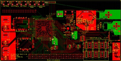

I see a number of unused pins on the 96 pin I/O connector. Can you switch to a smaller connector and thus reduce the hole count?
If there are enough unused ones on a given board to matter, you could omit the holes for those pins and snip those pins off on the PCB end before inserting the connector and soldering it. That 96-pin DIN connector is sure nice though.

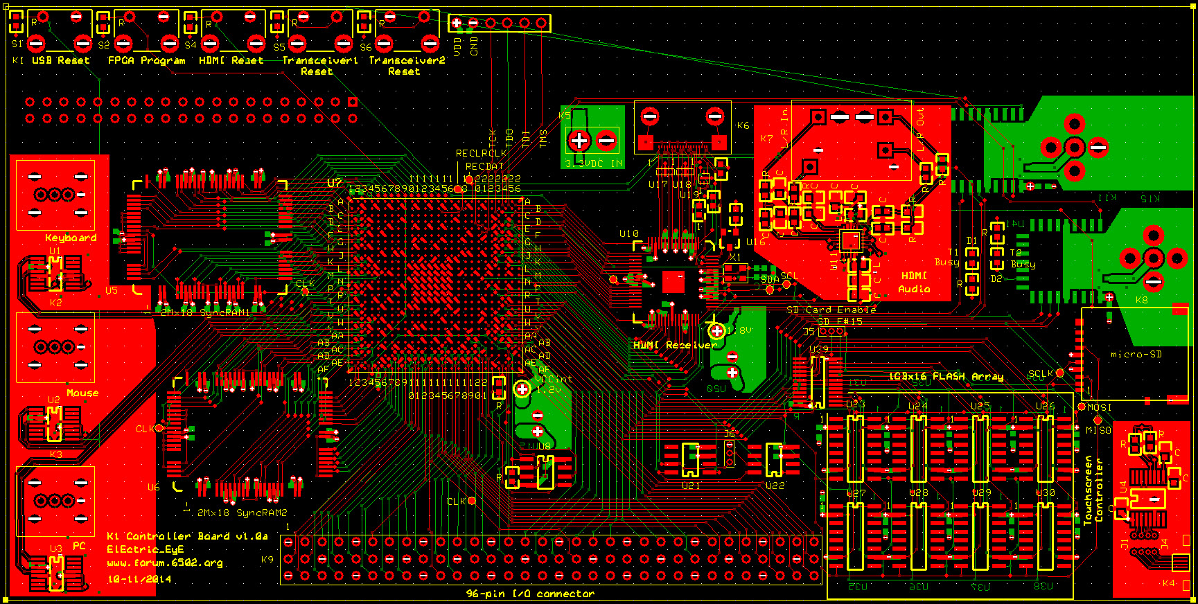

PostPosted: Wed Nov 26, 2014 11:10 pm
Instead of placing the PATA/16-bit audio connector to the NE, it makes sense to place it to the NW (underneath the reset tactile switches) so the mini-HDMI, stereo I/O, and RF sections can rise to the top of the board where their connectors should be. Also, the RF section will have more freedom to expand.

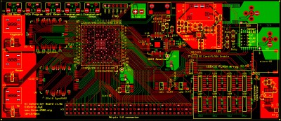

PostPosted: Mon Dec 01, 2014 5:31 pm
I've done a 4-page writeup on the intended functions of this board. It's very general, but does give some insight of my expectations of the inner workings. Should be visible on MS Wordpad. I will post the final version of this writeup on the head post.
Very close to a final PCB layout.
