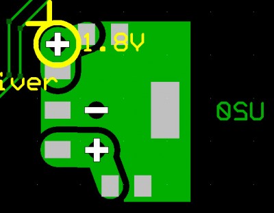

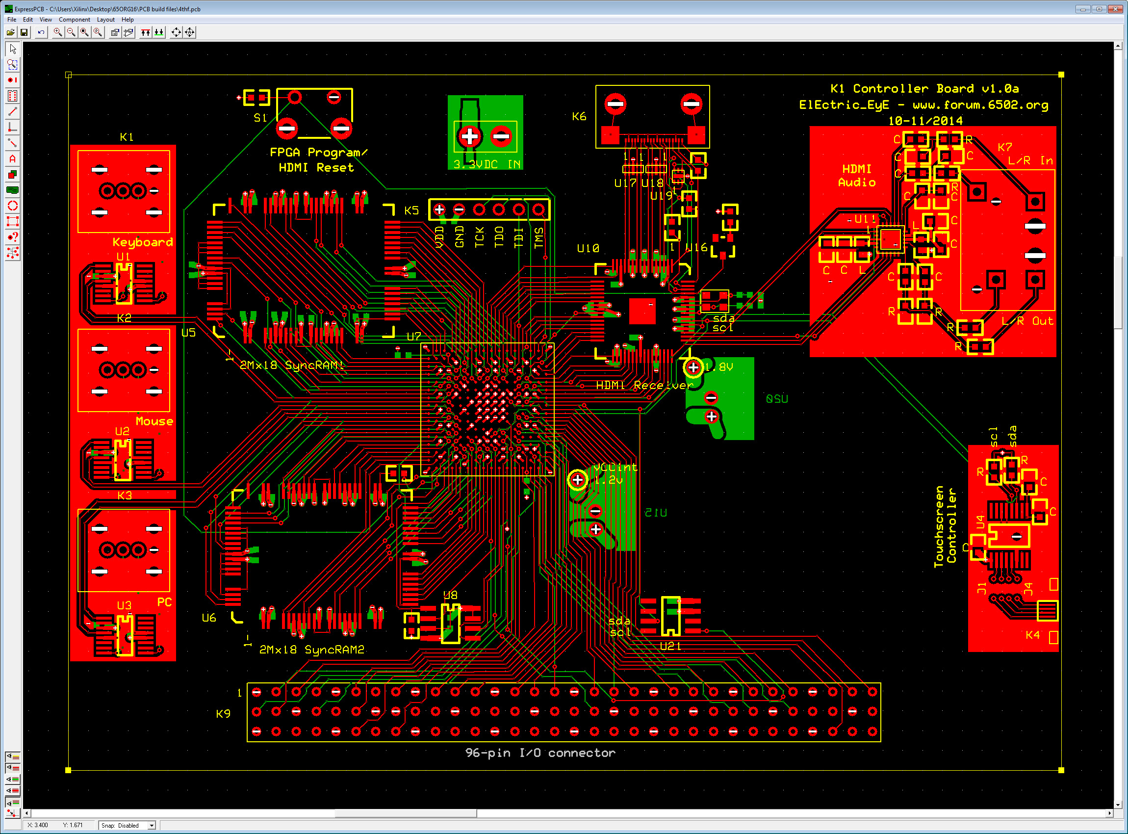

Finished adding in all the bypass capactiors.
I've added filled planes on the bottom of the board around the voltage regulators that should increase the performance.
Originally I did it to avoid adding more vias, for the negative side of the bypass cap's, as there alot of lines running on top of the board (not shown).
The white pads will be free of silkscreen so I can solder the voltage regulators and 0805 cap's.
Now I'll do the same underneath the HDMI audio section, touchscreen section and USB to UART section.

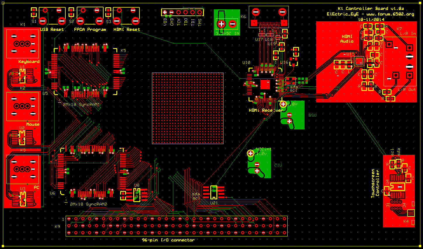

Almost done!
Starting the .ucf pin constraints file for the FPGA today. This is yet another check that will help ensure all the pins are correctly wired.

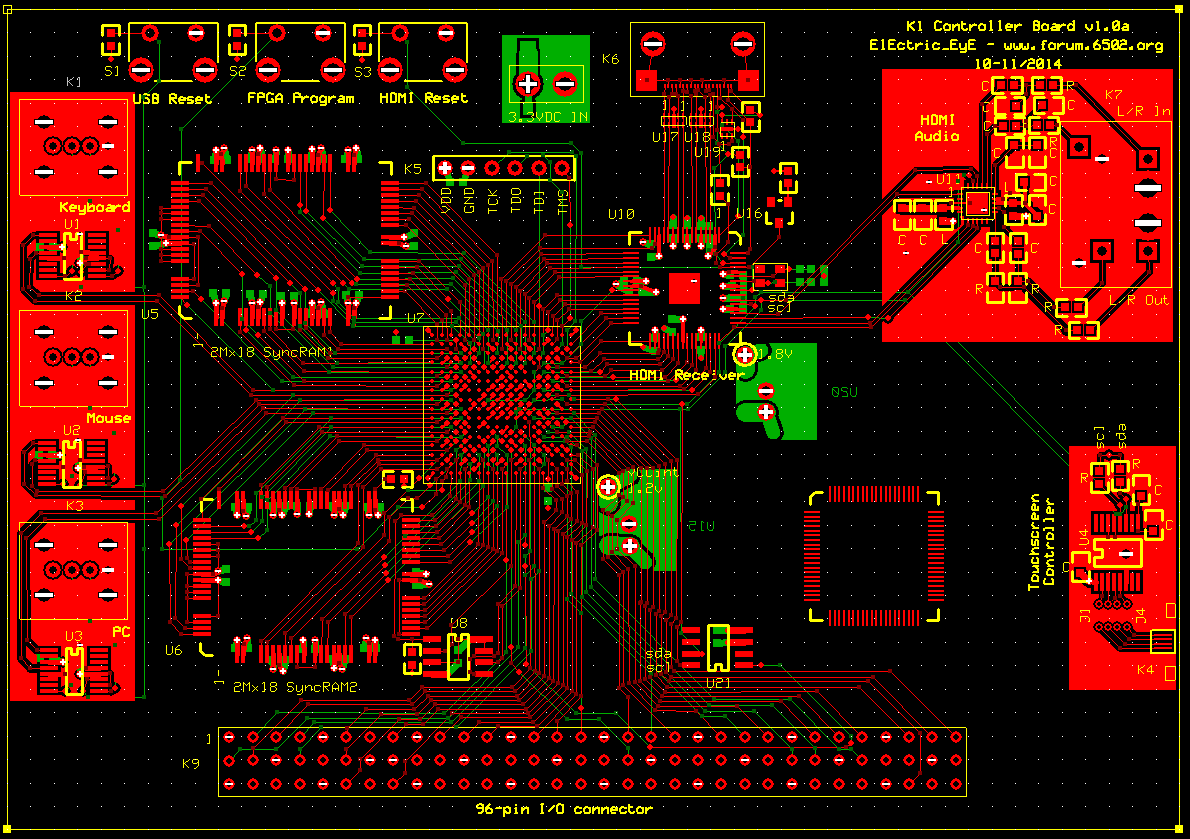

PostPosted: Mon Nov 10, 2014 6:12 pm
The constraints file is finished and posted on the header post. Found a few errors.
Redid some portions of the layout to make it look neater, the pic of the final version 1.0a is also posted on the header post.
Redefined the goals on the header post.
I'm toast. I might read up on the audio codec, it can sample inputs.

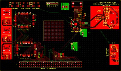

PostPosted: Mon Nov 10, 2014 7:55 pm
Would be a shame to waste that big blank space in there, 4 boards are going to cost me $200US.
That space can comfortably fit an 80-pin QFP. I'm looking into Analog Devices Audio Processors before I finalize this design. Since I have no FPGA pins left, I'm looking for devices I can add to the I2C bus and that can take advantage of other signals already present.
Another possibility might be wireless transceivers?

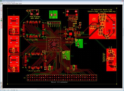

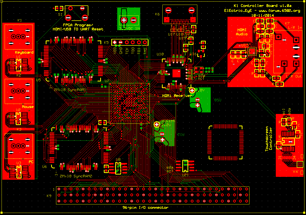

PostPosted: Wed Nov 12, 2014 12:14 am
In the effort to maximize functionality of this board, every inch must be utilized so I continue optimizing...
Instead of 1 switch to reset 3 IC's simultaneously, i.e. 3x USB to UART ICs, a HDMI Receiver IC and a FPGA Program, there was room to add 2 more of these momentary reset switches so now the user can reset each of these IC's individually whenever necessary.
Still doing research on the IC that will fill in the blank space... Probably isn't going to be an Analog part, I'm leaning towards wireless transceivers. The difficult part is finding a transceiver that has a I2C interface. The ones I've seen have a UART interface, some have SPI. Still looking for the one with I2C.

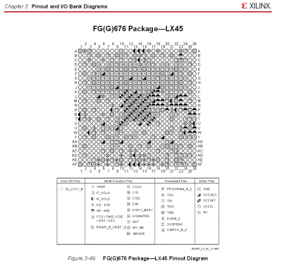

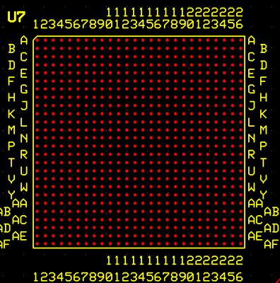

A fresh start
Alot of (n) - (no connects) on the LX45. Lucky for me this design does not require alot of connections north of pin A1.
I put some yellow paint to help me out... This is going to be difficult routing on a 6"x3.5" board.
