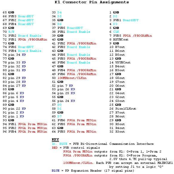

I plan on making a controller board, but I intend this thread to be open ended. My plan for a K1 Controller Board is to hopefully have a modified 65Org16.b core. A version of Arlet's 8-bit 6502 Core in a Spartan 6. I'm sure there may be others who would support a 1GHz 32-bit ARM. Maybe some others would support 8 or 16-bit databus wide CPU or microcontroller. This is a beautiful thing IMO, and this is why I have provided pinouts of all connectors and have gone into so much detail exposing my design. I will update the K1 Controller Board pin assignment table soon (EDIT - 10/23/12 Final update has been made). The bidirectional databus common for each PVB is 8 bits wide and supports a 6500/6800 type R/W signal with a Phase 2, R/W and Chip Enable signals present.

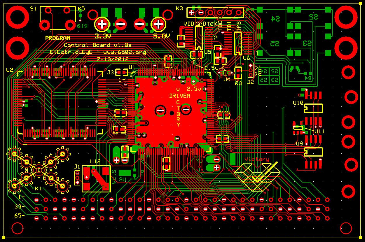

This V1.0a thread will discuss a layout very similar to the PVB itself, i.e. a boardsize of 3.8"x2.5", a 144-pin Spartan 6 + SyncRAM w/provisions up to 4MBx16, a microSD adapter, some serialFLASH, and a 100MHz oscillator. Also, 2 FPGA PROMs will be present. In addition, 2 x PS/2 connectors for keyboard and mouse cores, and an MCP2200 for tx/rx serial transmission from a PC USB port.
Still looking for that elusive camera module with 16-bit RGB output...
PostPosted: Tue Oct 30, 2012 10:28 pm
Ok, I need to forge ahead with this K1 Controller board. I only post now as a progress placement. This board is still very much in flux, this is just the beginnings of a basic 3.8"x2.5" layout:
