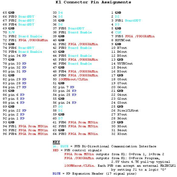

This thread goes hand in hand with the Concept and Design of Parallel 16-bit Video Boards, 16-bits being the RGB video output. There we discuss how we plan to manufacture 1 of these boards. This thread discusses how a multiple of these boards will be connected again using the ExpressPCB service. Although instead of a 3.8"x2.5" 4-layer Miniboard Pro board, this Mainboard will be constructed using their Standard 2-layer service, using a board size of 3.8"x5.5".
6 Parallel Video Boards and a still yet to be designed Controller board will be able to fit on the main connectors K1-K7. Thankfully, the Standard service does not appear to have a hole limitation as this design uses 800+ holes.
After wrestling abit for the layout of this Mainboard, I came to the conclusion this layout must absolutely dictate the assignment of pins for the main connector of the Parallel Video Board. Meaning, at certain points, 2 board layouts (PVB & Mainboard) had to be developed simultaneously.

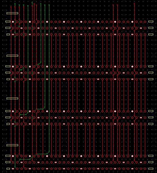

A nice thing I had noticed is that a total of 48-signals can be joined directly using straight traces! This was very good news as early on, as I had not routed a single signal on the bottom layer or have had to use via's...
Also I must mention Garth Wilson, who has contributed significantly to the final layout of this design, spotting some critical errors and making suggestions about improvements for successful high-speed (100+MHz) signal transmission. A great many thanks Garth!

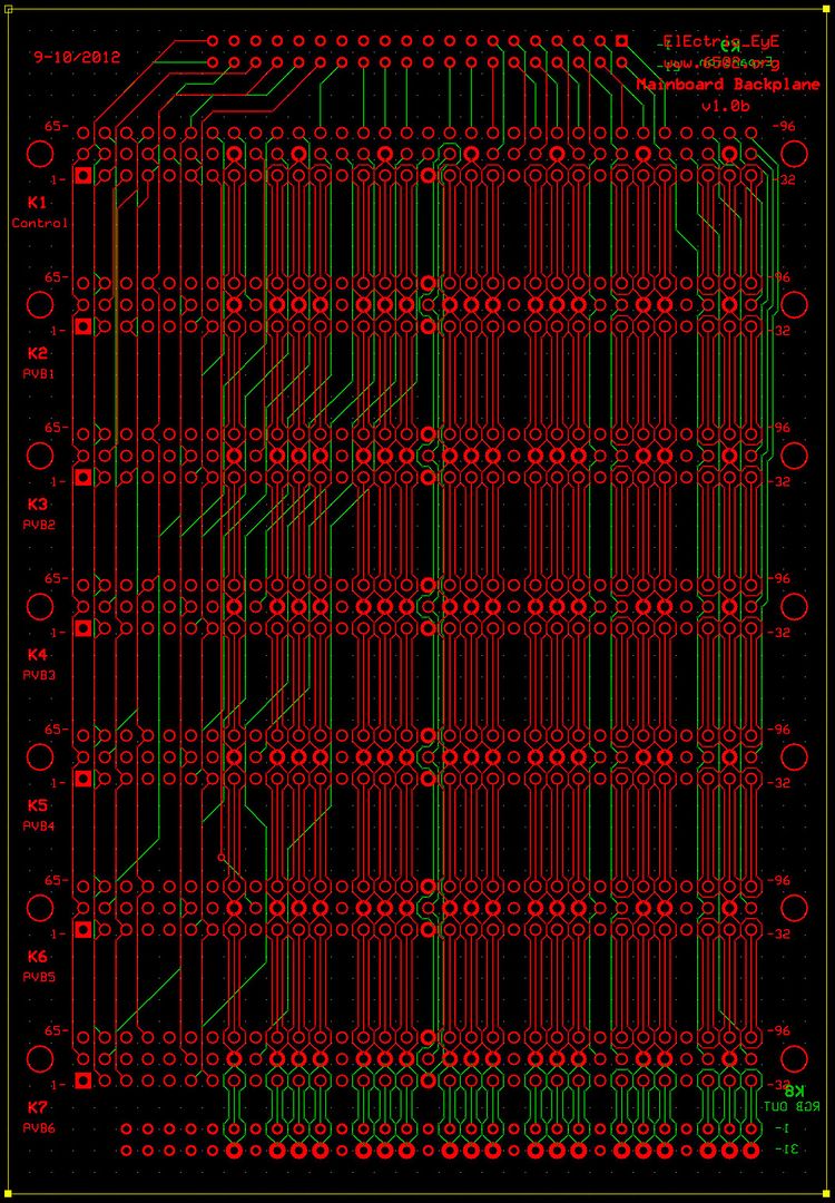

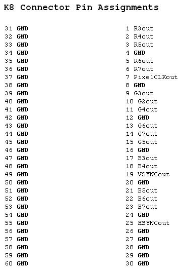

Here is the layout showing 6 PVB headers K2 thru K7. K1 is the controller board. K8 is an expansion header primarily meant for a future HDMI board. K9 is the expansion header meant for a sound board at this point. It uses a 16-bit databus, utilizing the lower 8 bit databus common to all the PVBs. K9's layout is done, but actual pin assignments are still a work in progress. All headers are mounted on top, except for K8 & K9.
Pin assignments for the K1 Controller Board connector:

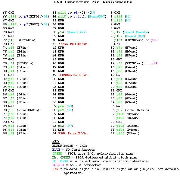

Pin assignments for K2-K7 Parallel Video Boards:
Pin assignments for the HDMI header:

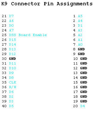

Pin assignments for the Expansion header (in-flux):

What kind of connectors are these? At first glance I was assuming the 96-pin DIN connectors; but those have .100" row spacing, not .200".

The one I'm using on each Video Board and controller board is a right angle female type A32863-ND from DigiKey. The male receptacles used on this mainboard are vertical type A32857-ND.

Yes, DIN 41612 connectors have the rows .100" apart, not .200". You can see it if you click on "datasheet" on the pages you linked. I have a bunch of those I got in WW for a project I never went through with.

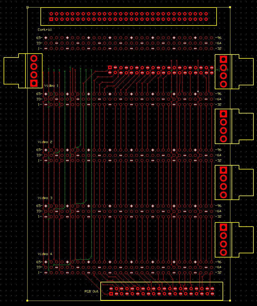

Update: I was able to add some expansion connectors. One 60-pin connector (on top) will be for signals coming off the Control board to future boards. I also added 2 40-pin expansion connectors for RGB-in and RGB out signals so more boards can be cascaded. The RGB in connector will have to be mounted on the bottom, all others on top. Lastly adding in the separate power connectors did not max out my pincount, which is @646. 6 mounting holes are not shown yet.

Is the change to .100" row spacing on the connectors still coming? I don't know of a single connector on the market that will fit the .200" row spacing shown on your board.

Ah, I had a feeling we weren't on the same page Garth. .1" spacing has always been shown on this thread for all the connectors. So those 96 pin connectors are fitting nicely in the 3.8" wide x 5.5" long mainboard.

Correction-- you have them on .150" row spacing, not .200", according to the grid of gray dots which are no doubt on .100" centers. So at the left end, you have .150" spacing between pin 1 and pin 33, and between pin 33 and pin 65. You do have .100" between pins 1 and 2, but not between the rows.

You're correct Garth! A huge error on my part which was multiplied by the copy/pasting. Thank goodness I was more careful on the PVB. I should've made a custom part and saved it to the library, but am always in a rush. Thanks for spotting that, I'll make the corrections.
EDIT: Made the correction to last pic.

Some updates on this board design:
1) No power is distributed through it. Current plans are for all powers to go straight to each board now. New pic will be added & updated on header post today.
2) The controller board will have IDE support using this IC with it's own 80-pin connector. So the expansion connector can now be generally devoted to an audio solution.
