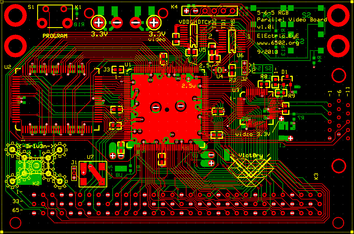

I have to finish the v1.0i board. I will receive 3 boards. After a successful test I will start a new thread.
EDIT 9/11/13: v1.0i complete! Ordered 3 more boards. Just a couple changes: No 5v required, now 2 separate 3.3v supply inputs. 1 feeds the videoDAC only through a LC filter. No Flash memory, SD card and lost 1 testmode pushbutton. New faster 4.0ns SyncRAM with provisions for FPGA control of burst reads/writes and flow-thru or pipeline modes. Also most exciting, is the utilization of the 2 databus parity bits. So each pixel can be assigned 4 functions. The onboard can oscillator is no longer routed to 2 FPGA clocks and then offboard. Instead it feeds 1 FPGA clk, and the other FPGA clk receives an offboard clock.
EDIT 9/18/13: Boards are in. IC's are in. Will have to wait till next week for assembly of 3x PVB v1.0i.
EDIT 9/22/13: BAH! I ran out of the 96-pin main connectors. 2 boards have been soldered up. Waiting on connectors.

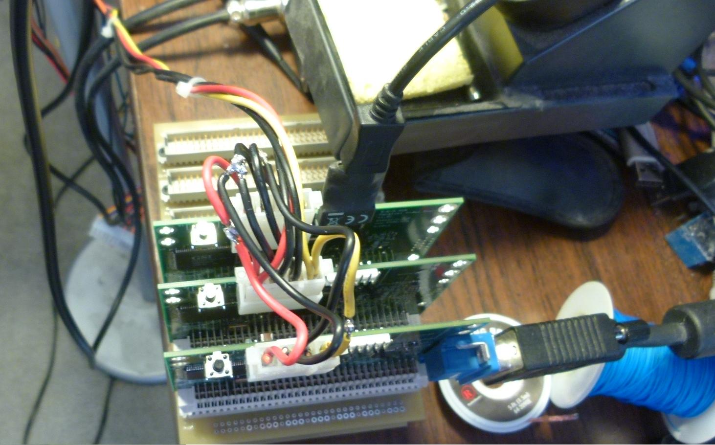

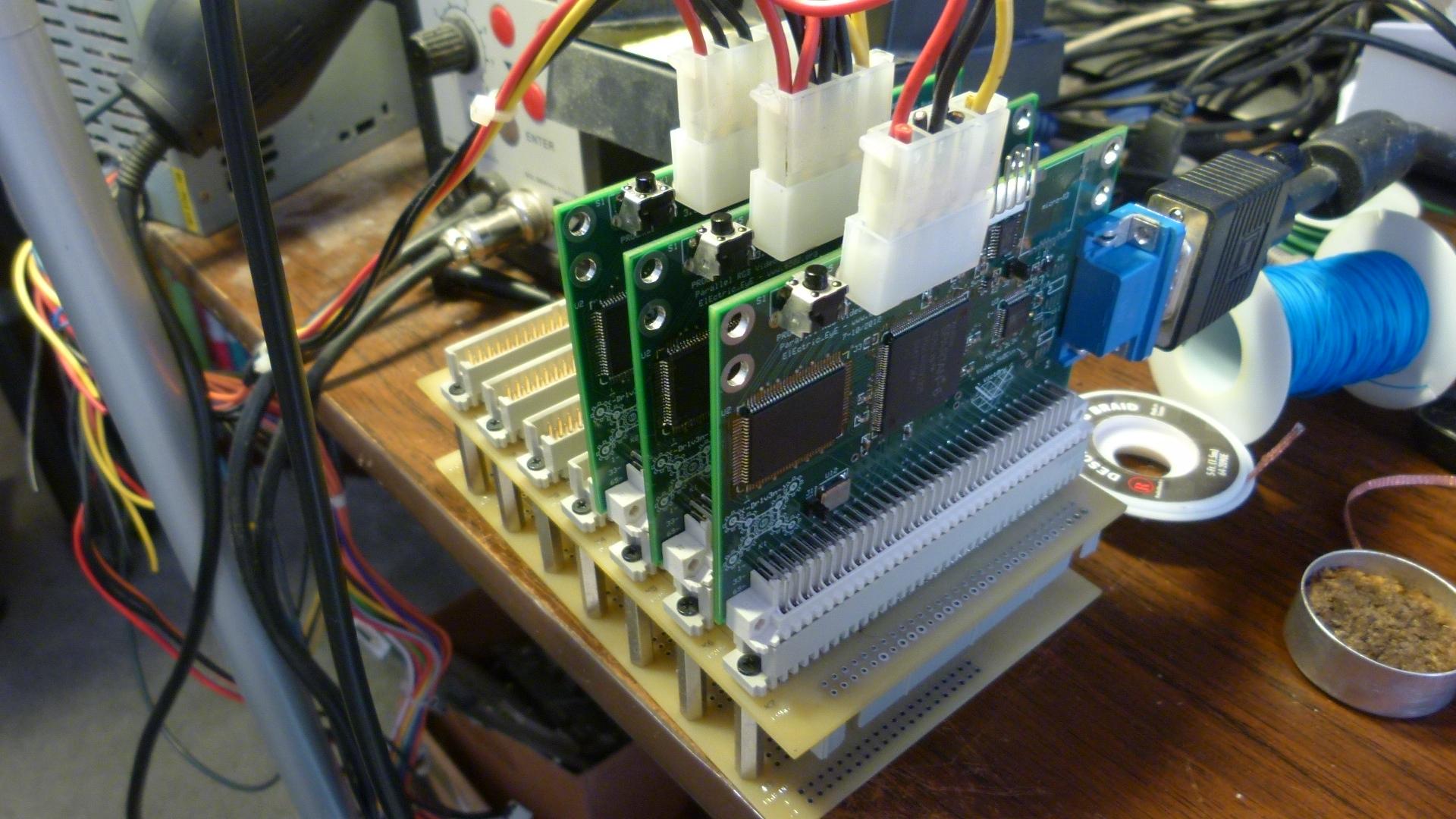

PostPosted: Tue Sep 24, 2013 2:34 pm
I found 1 more 96-pin r.angle connector I needed to make 3 boards functional today. I had overlooked it as a vertical type since it was still wrapped in packaging.
After the hotplate and some touching up, it is up and running. Now 3 boards are outputting good video. It is almost a cookie cutter system at this point, meaning I can copy and paste an entire project and change a few timing variables in the HVSYNC generator for each board and the pictures are lined up and in-sync with increased throughput. This was the goal of the parallel system.
For the horizontal delay, after hstart, I figured out each board seems to have 6 cycle delay. So the PVB(5) before the last output PVB(6) had a delay of 6, PVB(4) has a delay of 12 cycles.
The vertical delay seems to be 11 scanlines. For PVB(5) I adjusted this by changing the Vertical Back Porch from 30 to 41. PVB's(5&6) were in sync and lined up although slightly stretched vertically. This was the quick way to account for the vertical delay, not the correct way. Now with PVB(4) adding 11 cycles to 41 causes the monitor to intermittently lose sync.
How can I do the vertical delay correctly? I have a skull full of mush right now.
Some pics.

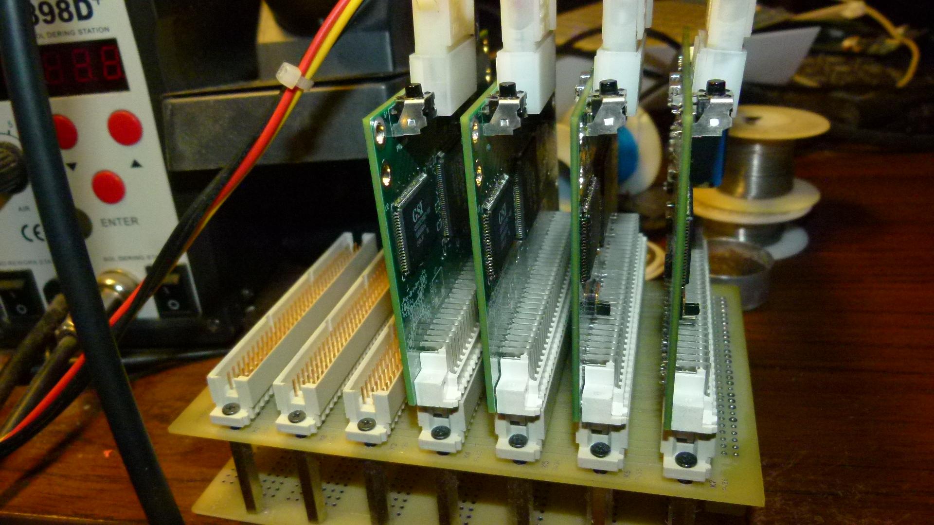

PostPosted: Fri Sep 27, 2013 3:01 am
Now 4 of 6 boards constructed, tested and "working", plugged onto 1 mainboard backplane. The board on the very bottom is an early defunct backplane. I put it to work since it has identical holes for the vertical spacers, in order to strengthen the entire structure.
Some of my Verilog coding needs attention, more time is required to make them all funtional.
