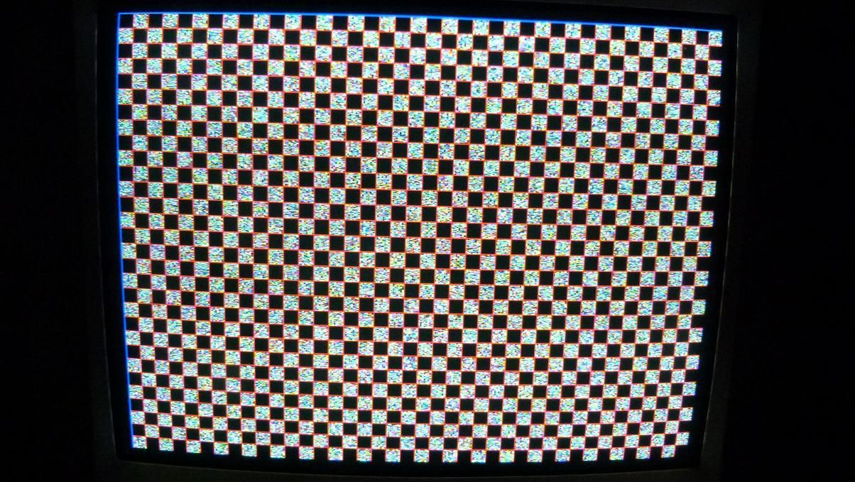

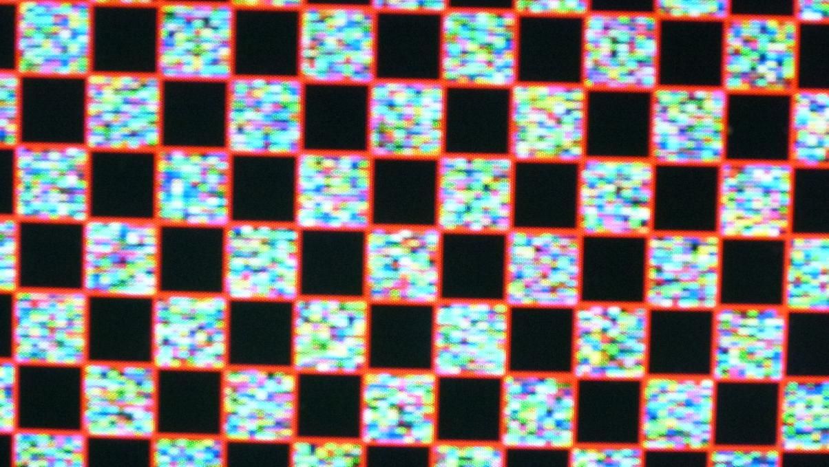

This is what I had previously. I thought it would be cool to show the full code and some pics.

CLOSE-UP - (Sorry about the focus):
PostPosted: Thu Dec 06, 2012 6:27 am
ElEctric_EyE wrote:
Any estimations or real world experience?
Hard to give general statements, because it all depends on what you want to do. It depends on resolution, clock frequencies and access patterns. In general, you calculate how much time you have based on VGA timings, and how much time it takes, based on amount of data and access times.
