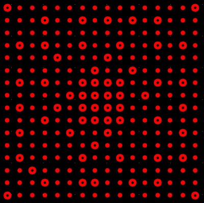

Yes, this is going to be the challenge I'm starting to realize. I've been away from board design for more than 6 months, so some stupid questions:
Is it possible to have a via for every pin of a BGA package? I would think so off the top of my head...
I have a desoldering station which has a hot air gun. Maybe this, in conjunction with the hotplate, would help bring the temps up quicker without cooking the FR4 board material. Not sure if air blowing would move the BGA package though...
PostPosted: Fri Jun 21, 2013 3:22 am
Posts: 899
Generally no.
With reasonable widths, such as 6 mil traces and 13 mil via holes with 7 mil rings, your via will take up the entire space between pins. That means you can't have any other traces going through that square, top or bottom of the via layer.
With 2 layers, as soon as you put a via down, you are finished for that square. The first two rows of balls can go straight out; the third can go to vias and routed out from below; the fourth can go to vias and route out in-between the third row's vias. Finito. In practice you have some power pins that break the pattern.
But anyhow, as soon as you put in two rows of vias you have a perfect roadblock [EDIT] for the board layers those vias penetrate.

Last week I started to do a power layout for the FT256 Spartan 6 XC6SLX25. In the pic all the GNDs & VCCs are the smallest via's available from EPCB: .026" metal around a .008" hole. The other BGA pads are .016". This will be a 4 layer board, 2 inner layers are power/ground planes. These planes may help disperse the heat from a hotplate more evenly than a 2 layer board.

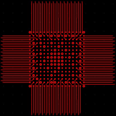

Consistency is nice work enso!...
This is my progress so far of a top level layer board so far, without concern for other specialized pins. VIAs are powers/GNDs as mentioned before.

Some of the remaining signal pins could be routed to the bottom layer using more vias, but I didn't want to cloud that layout as it shows the most basic number of pins one can easily route using a 16x16 1mm BGA package on one layer.
