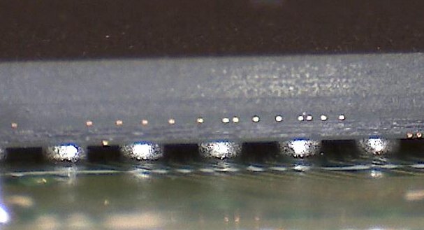

For another project (not FPGA/6502 related), I tried soldering a 256 ball BGA (1.0 mm pitch) at home. It still needs more thorough testing, but at first sight it looks like it got mounted correctly. The part is nice and flat and you can look underneath and see clear through the rows of balls. The device powers up correctly (not too much current), and can communicate over the UART to my PC. This still leaves 200 connections to be tested, of course, but the results are encouraging, and it turned out to be easier than I thought.
Xilinx sells a couple of Spartan-6 devices that have the same size, including the XC6SLX16-2FTG256C ($25 at Digi-Key) and the XC6SLX25-2FTG256C ($35). These have 186 user I/Os, compared to only 102 for the 'LX9 in TQG144 package, and they also have more logic slices. The 'LX25 also has more block RAMs (52 instead of 32).

1mm BGA might not be so bad, especially if you can see underneath.
How did you apply the solder paste? How did you heat it up? Did it self-center when the solder melted?

I applied the solder paste using a laser cut stainless steel stencil from the PCB manufacturer (about $60), and a small steel putty knife. Heating was done in one of those.
It did self center, but it was already pretty well aligned to start with, so it only moved a tiny bit. I worried a lot about placing, and came up with various ideas for alignment. In the end, I just used a simple manual vacuum pick up tool, and just placed it by hand using the silk outline as guidance. Then I checked from the side to see if it was okay.

The board is a 6 layer design with 4 mil trace/clearance and 0.15 mm finished holes (6 mil).
