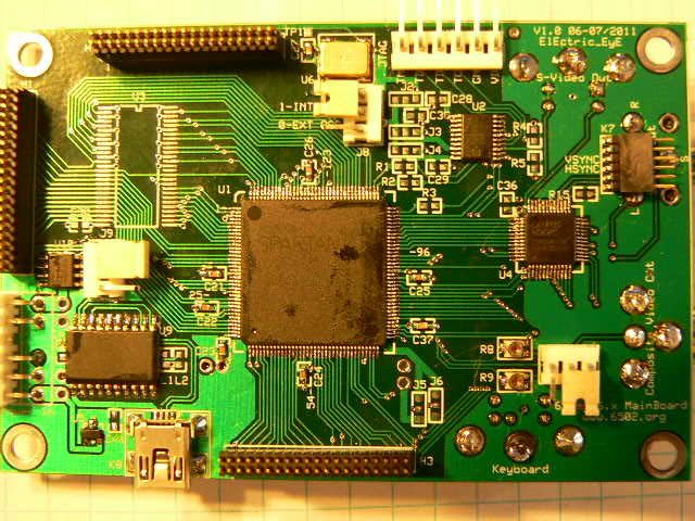

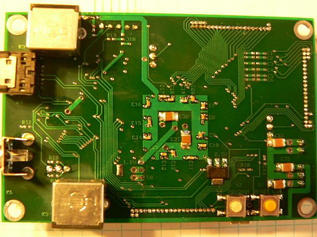

I was impatient today and decided to try to assemble the whole thing in one shot. During my trials and errors I decided to lose the butane micro-tipped soldering iron. It just didn't get hot enough. I actually used my big fat soldering iron on the 0605 parts. Just had to hold down the cap's and one small application of high heat and a puff of smoke with hardly any .015" solder, bam a nice clean connection. This was after initially soldering 4 caps using the smaller soldering iron and after I almost punched a hole in the wall.
Anyway, I measured 17ohm resistance between 3.3V and GND and .4 ohms between 1.2V and GND. So there is a big time short after soldering. On the other 2 bare boards there was infinite resistance. So I screwed up "slobbering"somewhere. In retrospect, I should have take resistance readings after soldering each part... Not only that, I noticed resistors for the PS2 keyboard and the S-Video connector are underneath the connector. They need to be on the top side. So all these factors in combination with the fact that I can't even fit the SDRAM on this board forces me back to the drawing board for version 1.1. Sorry for the letdown folks
But I will take a pic of both sides just for the hell of it.

Hi Ed,
I plan on deconstructing this board 1 part at a time until I find out where the 1 hard short (.4ohm) and a semi? short (17ohms) are. In the pic's the 1.2V reg has been removed already. It was getting hot and the Spartan 6 was getting warm after about 20 sec's. These 2 IC's unfortunately have been sacrificed. But if I can learn what not to do, then it's a worthwhile experience. All I plan on salvaging are the connectors from this thing...
This is a totally new beast to me as far as prototyping. I used to prefer wirewrapping, but the cost of SMD adapters equal if not surpass the cost of manufacturing 3 boards. Bear with me. Anyway here are the pics as promised, before further deconstruction...

Pity about the SDRAM thing - can you shake out any more bugs, now that you have the boards in your hands? Is it still worth populating one of them with most of the other parts or are you heading straight for a 1.1 revision?
I would have liked to solidfy the JTAG jumpers. I may still have a chance... Today's IC's are very forgiving. Although the Spartan 6 was getting warm, it wasn't dissipating heat like the 1.2Vreg, , and I only had GND & 3.3 voltage applied for a very limited time...
1 question? If one of these SMD caps did blow out, could it become a conductor? I could have sworn I heard a small pop as soon as I initially plugged in 3.3V, but it was very faint so I'm not sure...

I'm starting to think maybe it's the extreme liberal way I applied the solder flux to the board with a cotton swab to help keep the caps in places. I did clean up the flux around the parts using acetone, but I can't get underneath.
I think next attempt I put the flux in a needle (wife used to take shots, I have one or 2 around) maybe very briefly heat up the metal needle tip and put the smallest drop on each pad, then place the part.
Another concern is maybe the first 4 caps on the topside got damaged from too much heat, I was really struggling with getting a routine down. That is, incidentally, the 1.2V bypass caps which I intend to remove first.
Heh, I am up very early this morning thinking out loud about this dilemma. Can't turn on the lights yet, family still asleep.
Also, I did notice the the .1uF caps had a place to solder on the sides of the package creating a possible short, so I removed all those caps and am using the .01uF.

For new boards, I usually work in stages. First try to get power supplies working, oscillators, and then add main ICs one at a time. Every time I add something, I test and measure to see if it works.
It takes a bit more time that way, but if a short develops in a supply net, you have a good idea where to look.

Yeah, I rushed it and paid a price. I blew out the Spartan 6.
Focusing on the 1.2V .4ohm short to ground, I removed all the VCCINT bypass caps. That 1.2V supply only goes to 5 pins on the entire board. Still, removing these caps did not remove the short. After surgically removing all of the VCCINT pins from the Spartan 6, the short to GND disappeared, proving I let the smoke out of the Spartan 6. Poor thing...
I'm now busy with V1.1 of a new PCB. It will have a correct template for the SDRAM and just a few other placement corrections. Turnaround will be much quicker than V1.0.
I also will have the correct tools and will take it slower this time and measure resistance on each of the power lines with respect to GND and with respect to each other, after soldering each and every part!
You shouldn't use acetone to clean up. Aside from the fact that acetone is extremely flammable and can cause a flash fire, it will damage the solder mask and possible delaminate the board layers. Isopropol alcohol, sold as denatured alcohol solvent in hardware stores and paint shops, is the preferred solvent for cleanup.
Do be a bit sparing with the flux. Try to confine it to the pads to avoid making it easy for a bridge to form during soldering.
