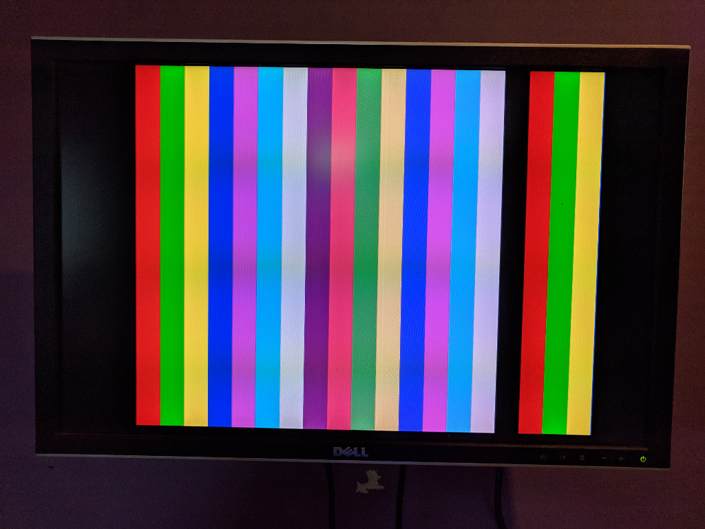

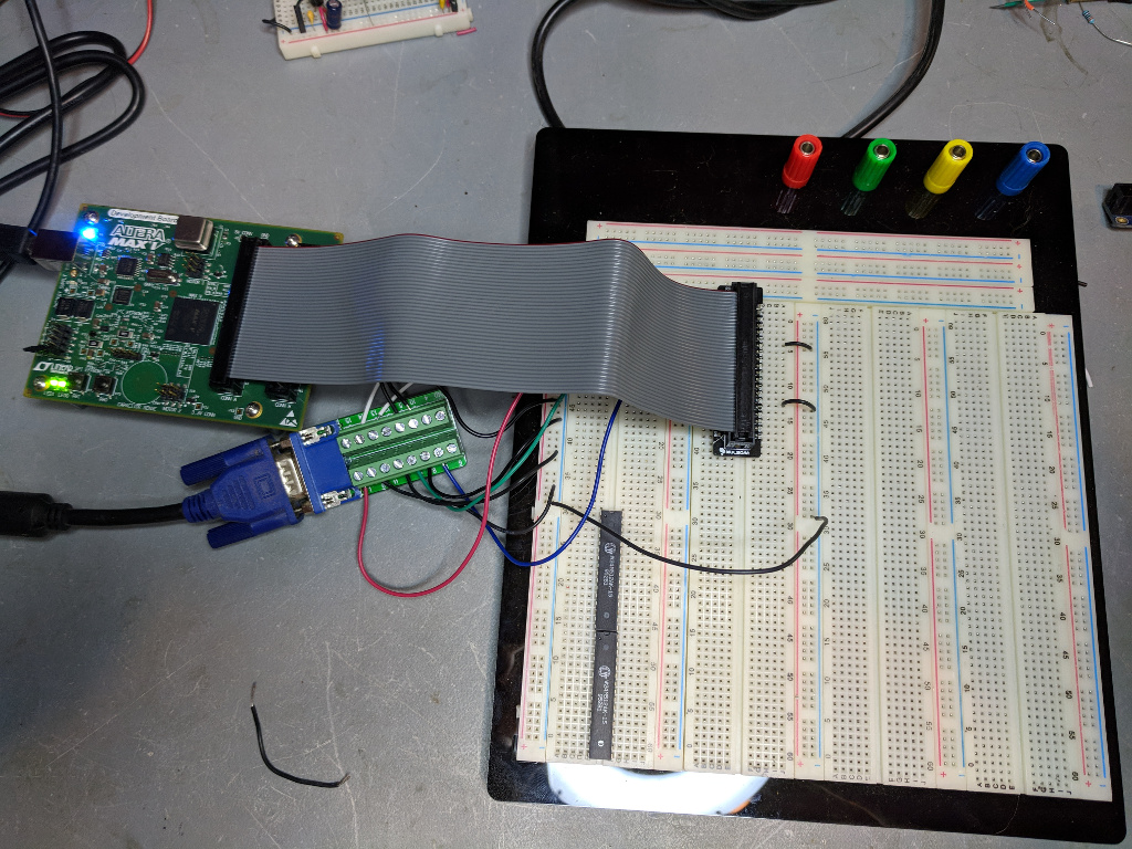

I've been working on my own video chip for a few months now and finally had success today!
It outputs a 640x480 60 Hz signal, and can generate 320x240 graphics with 6-bit color (BGR222) or 80x30 text with 16-color foreground and background colors and a font read from high RAM (it is designed for 128K of VRAM with a sparse memory mapping like the Apple II). I'm going to also be adding PS/2 keyboard (and possibly mouse) support onto the chip as well, maybe hardware SPI if I'm feeling lucky.
The code is in VHDL and currently runs on a Max V dev board with a 5M570ZF256 with 570 logic elements, of which I'm using about 25% right now. It will probably be back up around 30-35% once I disable the test pattern and re-enable actual VRAM reads, but that still leaves plenty left over to cram in more functionality. My only constraint is that the final design needs to fit into one of the QFP models so that I can actually solder it; for the most part this just means I'm limited to 144 pins, and since I'm only at 48 or so now I should be fine.
The chip is designed to eventually slot into a future 65816 SBC and share the video ram banks with the processor. Since all I have now is my 6502 SBC I'm going to rig up something with a big AVR chip (like a 644, which I have already) to let the 6502 SBC talk to it over its VIA ports. It won't be fast, but it'll get me decent keyboard and text mode support at least, and let me debug the VHDL before building the next SBC.

Looks good, Josh! I can well imagine this is an exciting milestone.
I'm a little curious about how an '816 would share the video ram banks, but I expect these details will become clear later. You're intending to implement both bit-mapped and character mapped modes, is that right?
Does your 6502 SBC run on 3 volts or 5? Will there be issues interfacing with the FPGA board?
For sharing the RAM I am going to have the video RAM banks on physically separate chips, and any attempts by the '816 to access those banks will temporarily slow the CPU until there is a free cycle (probably using RDY). I'm also providing a vertical blanking signal and interrupt so the CPU can try to do most of its work during the downtime between frames, but there are some free VRAM cycles even during frame draws. Text mode doesn't fetch much data; every 8 pixels fetches a font byte, and every 16 lines it also fetches the character code and attributes bytes. For 320 mode every other line is blank (240 lines out of 480) so there's some spare ram cycles there too.
Yep, the implementation is actually already done, and looks good in simulation, but until I can get something rigged up to actually load a font into RAM I can't really test text mode.
The plan is to go 3.3V to make it easier to interface to the Max V, and it's also a lot easier to find larger RAM sizes in 3.3V these days. I know this will limit me to 8 MHz but I'm willing to make the trade-off.

It outputs a 640x480 60 MHz signal,
Great work. But I think you mean 60 Hz. :-D
