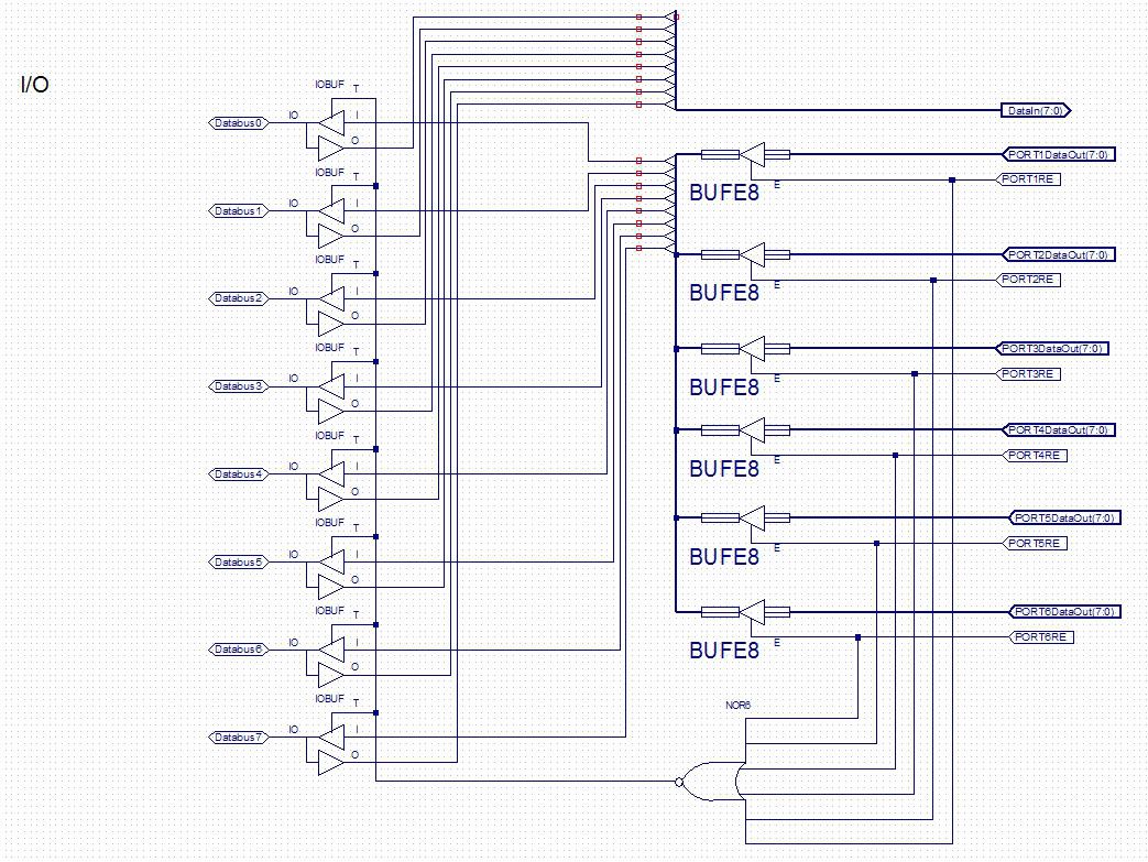

 Post subject:
PostPosted: Sun Oct 31, 2010 11:54 pm
Andre,
I can only speak from my use ot FPGA's and CPLD's using schematic entry as I have not crossed the bridge to HDL yet, but I can say this: That link I had posted has given me insight to problems I've been having.
This what I have learned about implementing bidirectional buses inside CPLD's & FPGA's:
When working with CPLD's, you can have a bidirectional bus that goes to each of your internal ports.
RE, WE are Read Enable & Write Enable signals decoded with Address and R/W.
When working with FPGA's however, you can have only 1 point within the entire IC that is bidirectional (i.e. high impedance "Z" state). So, in that link to the Xilinx forums I mentioned earlier, Gabor stated "... it is best to have this bidirectional entry point at the highest level in your design...".
Below is a module similar to one I'm currently using successfully to interface the 6502 databus to multiple, readable output ports inside the FPGA. The only difference is, I've renamed some assignments and added more ports to express the idea more fully.
Databus(7:0) on the left, is assigned to pins on the FPGA. They connect directly to the 6502.
DataIn(7:0) on the top right is common to all the inputs of all the 8-bit PORTs, present inside other modules.
The PORTxRE (read enable) signals from each PORT are NOR'd, to put the data from the corresponding PORT onto the Databus.
