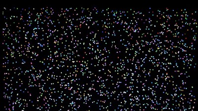

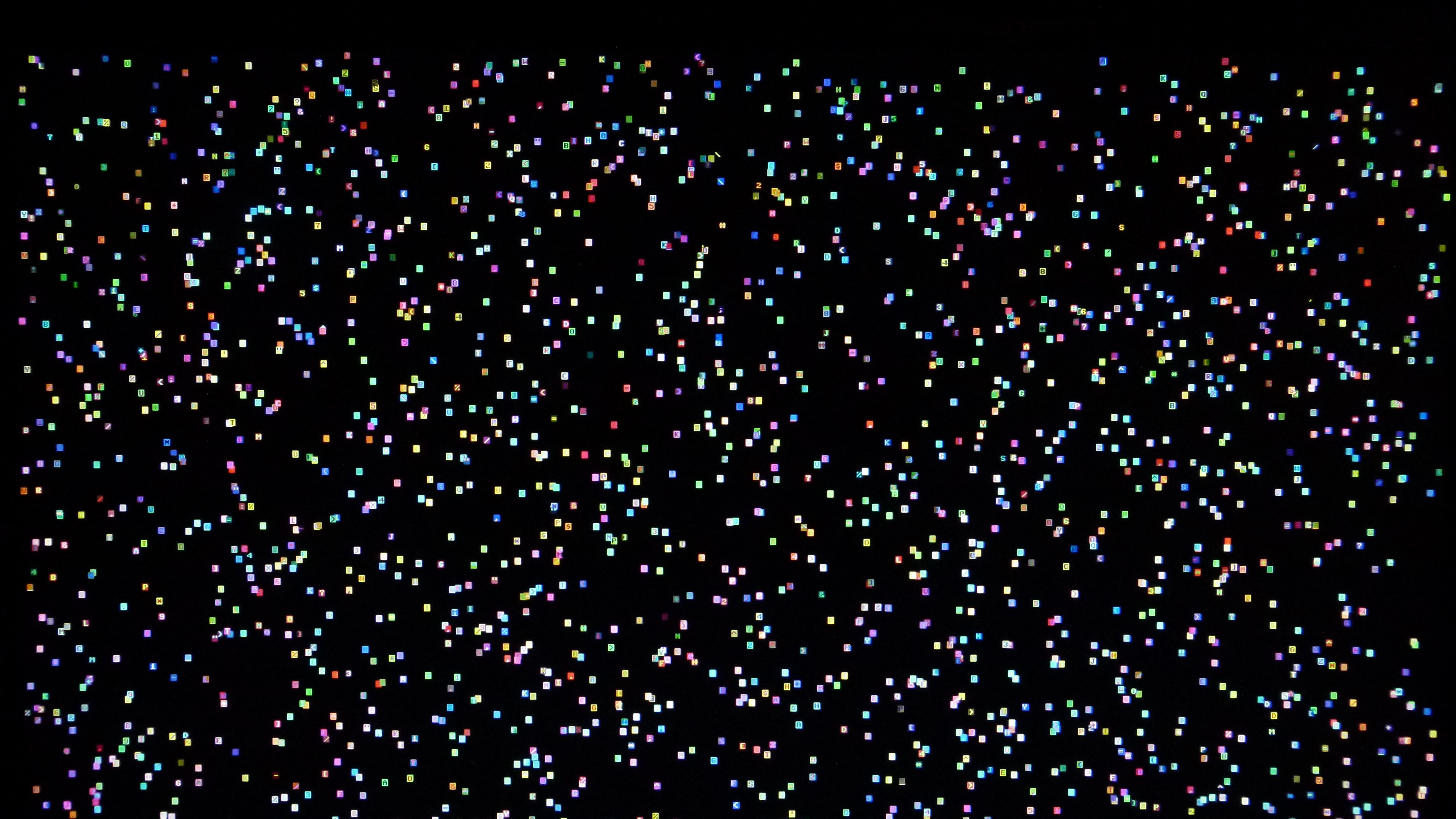

Random 8x8 characters seem functional.
                  LDX #2047                ;plot 2048 random ASCII characters, during HSYNC, using HDL PRNG for Character Plot Function
rock              LDA rng
                  STA color                ;foreground color
                  LDA rng
                  STA bcolor               ;background color
                  LDA rng
                  AND #%0000000000111111   ;[7:0] bits is ASCII value, only 96 characters available so mask off [5:0]
                  ORA #%0000000100000000   ;set bit [8] to 1 for C-64 font
                  STA Att
NG                LDA rng                  ;get 16-bit sample from HDL pseudo random number generator
                  AND #%0000011111111111   ;mask off 11 bits
                  CMP #1920-8
                  BCS NG                   ;if random sample is >1911 get another random sample
                  STA cX
NG1               LDA rng
                  CMP #1080-8
                  BCS NG1                  ;if random sample is >1071 get another sample
                  BCF0C $FFFFE             ;Branch if Control Flag 0 is Clear (0). CF0 is HSYNC input, so branch to itself and wait until hsync = 1, a non display period
                  STA cY                   ;plot Character!
                  DEX
                  BNE rock
imp               JMP imp

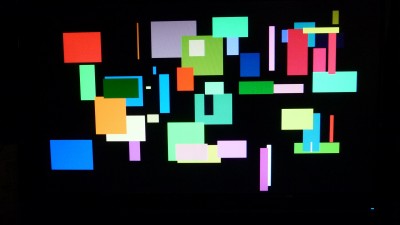

Random Rectangle Fill function has been fixed.
                 LDX #49                  ;plot 50 rectangles using PRNG and Fill Function
rock              LDA rng
                  STA color
                  AND #%0000000011111111   ;mask off 2^8 bits for 256 pixel width
                  CMP #256
                  BCS NG                   ;if random sample is >255 get another random sample
                  STA fXlen
NG1               LDA rng
                  AND #%0000000011111111   ;mask off 2^8 bits for 256 pixel height
                  CMP #256
                  BCS NG1                  ;if random sample is >255 get another sample
                  STA fYlen
NG2               LDA rng
                  AND #%0000011111111111   ;mask off 2^11 bits
                  CMP #1920-256            ;subtract max width to make sure it fits
                  BCS NG2
                  STA fXs
NG3               LDA rng
                  CMP #1080-256            ;subtract max height to make sure it fits
                  BCS NG3
                  STA fYs                  ;Rectangle Fill!
                  DEX
                  BNE rock
imp               JMP imp

PostPosted: Mon Sep 29, 2014 6:15 pm
I just noticed in all the 65Org16 software I've been posting there is a glaring mistake. But Bitwise's As65 automatically takes care of the error. The error is
BCF0C $FFFFE
It must have been truncating the highest hex value so an incorrect
BCF0C $FFFFE
results in an correct
BCF0C $FFFE

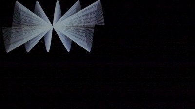

I've been trying abit of software that utilizes the Square Root Function and the Plot function of the simple LineGen accelerator. I've tested the Square Root Function on a few numbers for Xs and Ys and it appears to work in simulation. It takes 2 16-bit registers named Xs & Ys, squares them both then performs the square root mathematics according to Jack Crenshaw's formulas. You can read about that here.
8/26/2014 smg    Programming the 16-bit 2D Graphics 'LineGen' Accelerator

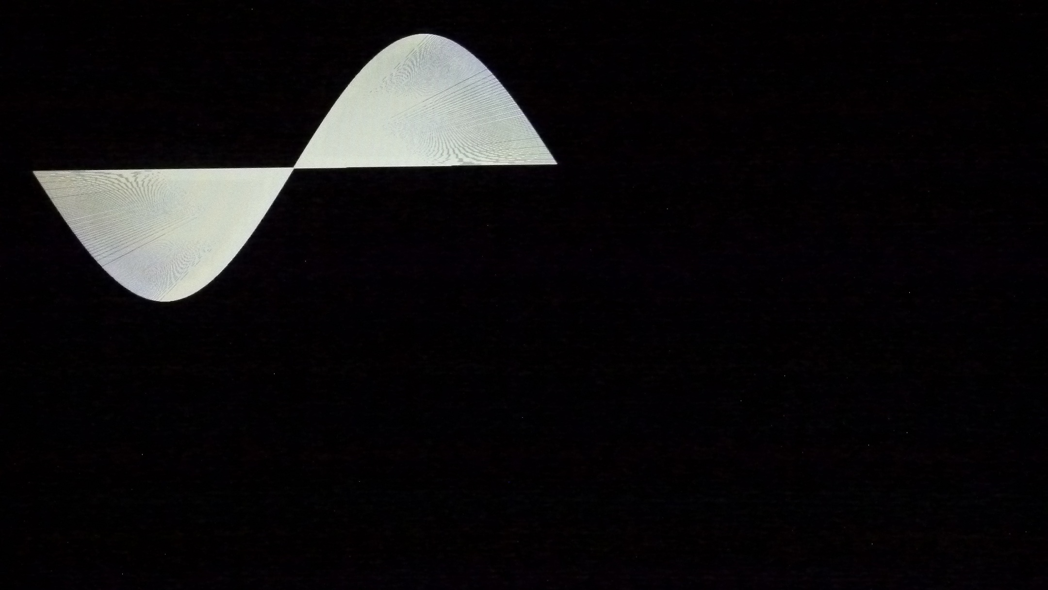

HMMM, I just noticed, no more color effects when posting here. I was trying to highlight the used functions...

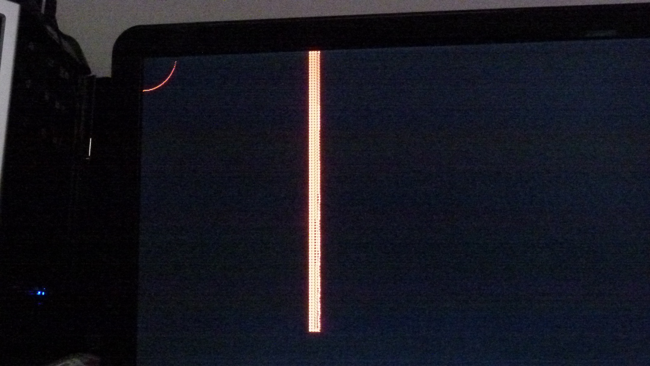

So, this is the software that attempts to plot the first quadrant of a circle.
                  LDY #100
                  STY RADIUS
                  LDX #0
NX                STX Xs
                  STX Xp
                  STY Ys                  ;SQRT!
                  LDA Root                ;Root = SQRT(Xs*Xs + Ys*Ys)
                  STA Yp                  ;PLOT!
                  INX
                  CPX #100
                  BNE NX
imp               JMP imp

Woops. I realized the SQRT formula is incorrect as I need a Y value to be calculated for every X and Radius, so the HDL should perform a SQRT(Rs*Rs-Xs*Xs), i.e. Y=SQRT(R^2-X^2). I'll fix this and also use the Character Plot routine to plot out the X, Y and RADIUS values on the screen. :wink: I can see it is still not a correctly plotted quadrant of a circle.
PostPosted: Sun Oct 05, 2014 12:48 pm
Fixed the SQRT function, it was looping 1 cycle too many for 'i'. Also now it doesn't shift the result in cycle CALC6 like in the old version.
//SQRT state machine
         SQRTINIT:
            state <= CALC3;
         CALC3:
            state <= CALC4;
         CALC4:
            state <= CALC5;
         CALC5:
            if (i != 14)
               state <= CALC3;
               else state <= WAIT;
//square root generator
      SQRTINIT:
         begin
            LGREADY <= 0;
            i <= 0;
            rem <= 0;
            Root <= 0;
            a <= Rs*Rs - Xs*Xs;
         end
      CALC3:
         begin
            Root <= Root << 1;
            rem <= ((rem << 2) + (a >> 30));
         end
      CALC4:
         begin
            a <= a << 2;
            Root <= Root + 1;
         end
      CALC5:
         begin
         i <= i + 1;
         if (Root <= rem) begin
            rem <= rem - Root;
            Root <= Root + 1;
         end
            else Root <= Root - 1;
         end

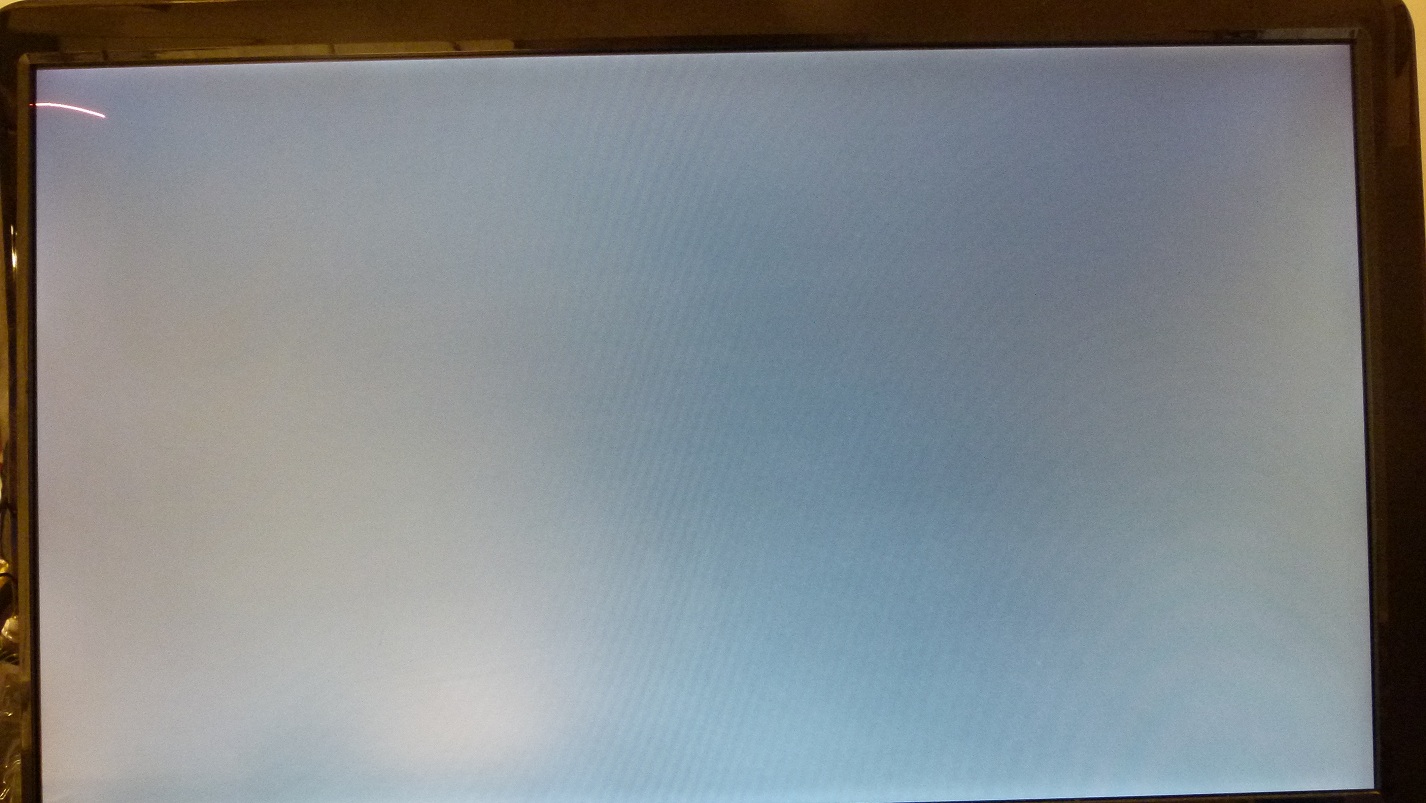

PostPosted: Sun Oct 05, 2014 1:23 pm
Simple program to draw 1 quadrant as X goes to radius.
                  LDA #%1111100000000000  ;red pixels
                  STA color
                  LDY #100
                  STY RADIUS
                  LDX #500
                  STX TEMP2               ;x position of characters
                  LDWi $0000              ;LDW #$0000. character Y position
                  LDX #0
NX                STWzp TEMP              ;STW $0009. y position of characters
                  STX Xs                  ;Xs starts at 0 and goes to radius
                  STX Xp
                  LDY RADIUS
                  STY Rs                  ;SQRT! Halt the cpu, calculate and put value in Root.
                  LDA Root                ;Root = Y = SQRT(Rs*Rs - Xs*Xs). From: R^2 = X^2 + Y^2
                  STA Yp                  ;PLOT Pixel! Halt the cpu and plot.
                  plot_hex                ;MACRO. plot hex value in A accumulator  starting @ coordinates (TEMP2,TEMP).
                  INW                     ;
                  INW                     ;
                  INW                     ;
                  INW                     ;
                  INW                     ;
                  INW                     ;
                  INW                     ;
                  INW                     ;add 8 pixels for plotting on next line
                  INX
                  CPX RADIUS
                  BNE NX
imp               JMP imp
I don't like it.... Y value is shown in hex. I'll have to revisit variable diameter circles later. Need to push on!

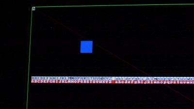

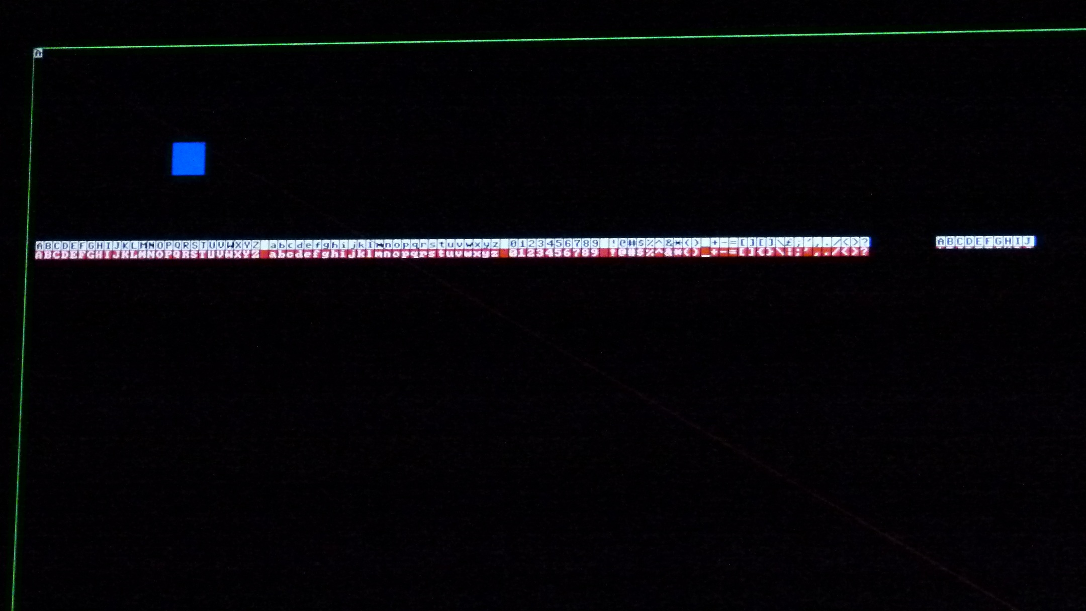

PostPosted: Sun Oct 05, 2014 6:22 pm
6 functions are tested here. The software is well documented, trying to do myself a favor for future viewing. Pix to follow soon.
;----Draw Green Border. Purpose: Test +-dx vs +-dy Line drawing-----------------
                  LDA #%0000011111100000       ;green pixel for a Border
                  STA color
                  LDA #0                       ;from top left to top right
                  STA lx0
                  STA ly0
                  LDA #1919
                  STA lx1
                  LDA #0
                  STA ly1                      ;Draw Line!
                  STA lx1                      ;from top left to bottom left
                  LDA #1079
                  STA ly1                      ;DRAW Line!
                  STA ly0                      ;from bottom right to bottom left
                  LDA #1919
                  STA lx0
                  LDA #0
                  STA lx1
                  LDA #1079
                  STA ly1                      ;Draw Line!
                  LDA #1919                    ;from bottom right to top right
                  STA lx1
                  LDA #0
                  STA ly1                      ;Draw line!
;----Plot 4 Characters. Purpose: Test Read/Modify/Write on register Att.........
                  LDA #%0000000000000000       ;setup pixel color for character
                  STA color                    ;plotting
                  LDA #%1111111111111111
                  STA bcolor
                  LDA #$21
                  ORA #%0000000100000000        ;set bit for C-64 font
                  STA Att
                  LDA #1
                  STA cX
                  STA cY                        ;!Plot Char 'A'. top left
                  INC Att
                  LDA #1079-8-1
                  STA cY
                  INC Att                       ;!Plot Char 'B'. bottom left
                  LDA #1919-8-1
                  STA cX
                  LDA #0                        ;!Plot Char 'C'. top right
                  STA cY
                  INC Att
                  LDA #1079-8-1
                  STA cY                        ;!Plot Char 'D'. bottom right
;----Plot Character String. Purpose: Show all available Characters & Fonts------
                  LDX #10
                  STX cX
                  LDY #200
                  LDWi $0000                  ;LDW #0
cont_plot         LDAaw CHARSTRING            ;LDA CHARSTRING,W
                  CMP #$0D
                  BEQ JOB
                  SEC
                  SBC #$0020                ;make ASCII compatible
                  STA Att
                  plot_string
                  INW
                  BNE cont_plot
JOB               LDA #%1111111111111111
                  STA color
                  STA bcolor
                  LDX #10
                  STX cX
                  LDY #209
                  LDWi $0000                  ;LDW #0
cont_plot2        LDAaw CHARSTRING            ;LDA CHARSTRING,W
                  CMP #$0D
                  BEQ JOC
                  SEC
                  ORA #%0000000000000000    ;clear bit for DOS font
                  STA Att
                  plot_string
                  INW
                  JMP cont_plot2
CHARSTRING        .BYTE "ABCDEFGHIJKLMNOPQRSTUVWXYZ abcdefghijklmnopqrstuvwxyz 0123456789 !@#$%^&*()_+-=[]{}\|;',./<>?", $0D

PostPosted: Sun Oct 05, 2014 7:08 pm
Not so good with the camera! Pixel rate is 150MHz. Monitor expects 148.5MHz for 1920x1080. Could explain apparent ghosting of pixels? I will test..

Limited fun with LUT's:
;----Generate sine wave from 10-bit LUT. Add pixel, phase and BRAM offsets.-----
;----Draw lines from the center and trace the sinewave.-------------------------
;----Display xfreq =  1.-------------------------------
                  LDA #%1111111111111111 ;white pixels
                  STA color
                  LDA #0                 ;[0-15] 1K BRAMs
                  STA Xblock
                  STA Yblock             ;(not used here)
                  LDA #0
                  STA Xoffset
                  LDA #0
                  STA Yoffset            ;plot at top right
                  LDA #1
                  STA xfreq
                  LDA #1
                  STA yfreq              ;1 is minimum for frequency
                  LDA #0
                  STA Xphase             ;sin
                  LDA #256               ;256/1024= 1/4 out of phase for circle
                                         ;generation using (x(sin),y(cos))
                  STA Yphase             ;Generate 2xLUTs! cos (not used here)
                  LDX #0                 ;draw a line from the center of the
                                         ;sinewave to the sinewave Y coordinates.
                  LDA #1024/2            ;
                  STA lx0                ;
                  LDA #1024/4            ;
                  STA ly0                ;from the center
liner             TXA
                  STA lx1
                  LDA scratchx1,x        ;read sin data from BRAM pointer Xblock #0
                  STA ly1                ;PLOT line!
NC                INX
                  CPX #1024              ;
                  BNE liner
grock             JMP grock
