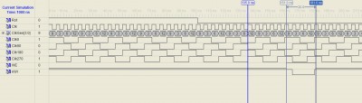

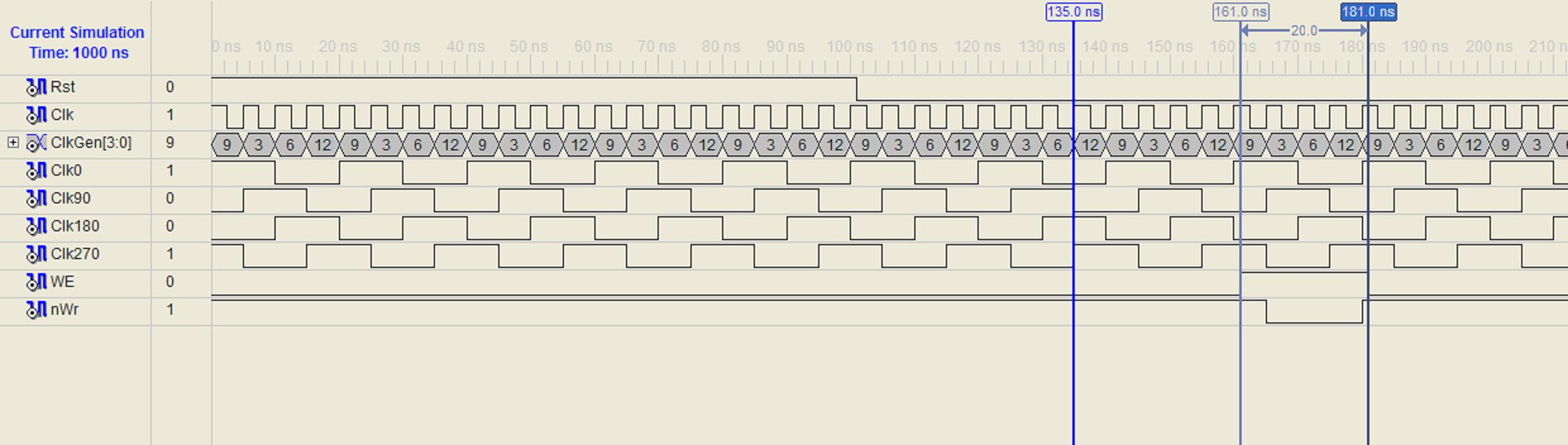

The following is food for thought.
I've experimented with using an ODDR2 output register and quadrature clocks to generate an SRAM strobe within a single clock cycle. The following ZIP archive contains an example which uses a Clk90 and a Clk0 to generate a strobe of 3/4 length of a clock cycle. In your case, with a 50 MHz clock frequency, the strobe width would be approximately 16 ns. At lower operating frequencies, the strobe width would increase.
I've also attached a magnified view of the circuit's functional simulation.
File comment: ODDR2 SRAM Write Strobe Generator.
File comment: SRAM Write Strobe Generator Source Files
SRAM_Wr_Strobe.zip [1.83 KiB]
Downloaded 147 times
Michael A.

Don't be put off by the number of clocks shown on the diagram; there's several experiments of mine in the files that I sent you.
I was suggesting that you can use a single clock domain to generate a strobe whose pulse width is controlled by the appropriate selection of the two clocks that feed into the ODDR2 component/macro. At issue is bus recovery of the SRAM and your bidirectional data bus into the FPGA. Unless you are using some kind of ZBT/NBL (Zero Bus Turnaround/No Bus Latency) device, there's usually some requirement for the output drivers to be turned off for some small amount of time before enabling the drivers in the other direction. In other words, it's important to turn off the FPGA's write buffers (during SRAM writes) before turning on the SRAM's write buffers (during SRAM reads).
If one is able to do this successfully, then the issue of bus contention on the SRAM/FPGA bidirectional bus is eliminated or at least substantially reduced to a minimal fraction of a bus period. The circuit I sent you is intended to be used with a single clock/single cycle memory access of an SRAM. I chose to put the bus turn around delay at the beginning of the cycle, but you can move it to the end of the cycle. It is at the beginning of the cycle because I delay the assertion of the write strobe by one quarter of the bus period by using the Clk90 signal. The circuit terminates/deasserts the strobe with Clk0, which should coincide with a read cycle for the next instruction.
In the scheme that I'm currently implementing, the read strobe to the SRAM will also be asserted using the same strobe generator. Therefore, there should be a quarter cycle where the SRAM output is not enabled. The quarter cycle delay should be sufficient to avoid bus contentions with most asynchronous SRAMs that are capable of operating at the speeds you are attempting on your FPGA board.
If you are using a 40-50MHz oscillator, which I remember you describing it as at one time, then a simple DCM in your FPGA will be able to give you the Clk0 and Clk90 signals needed for generating the strobe as shown in the timing diagrams previously attached. Otherwise, you can use a 4x clock and divider as I included in the test bench that accompanied the source. A 2x clock can also be used with the Clk0 phase generated as a toggle on the rising edge of Clk2x, and the Clk90 phase generated using delay FF clocked on the falling edge of Clk2x.
