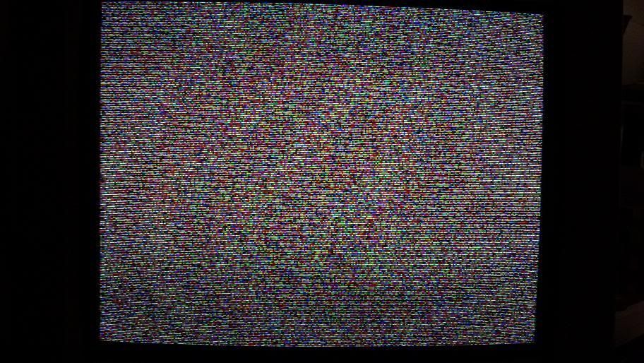

Arlet, thanks for checking the sim.
Arlet wrote:
...The noise you're seeing could be from setup/hold time violations at the data inputs of the FPGA...
Could be, I don't see much noise on 1280x1024 using the CRT like I did with 1024x768. I tried looking at the 1280x1024 video through the flat panel display and noticed just a slight, barely noticeable, darker waves going up the middle of the screen. Like it might be power supply noise. Not noise on the edge of pixels. On the CRT with 1024x768, I did see some noise on the edge of certain colored pixels. More observation is needed. Maybe time to solder in the high frequency bypass caps...
I got 1024x768 & 1280x1024 working also, using 108MHz. I realized the problem with the value 1024 since it sits right on the boundary. Binary 1024 is 100_0000_0000, 11 bits. So one would assume to use [10:0] for the load registers, but this is not this case. I have to use [9:0] in order for the value 1024 to work.
Also, for 1280x1024 to display I had to increase the vertical front porch to 10 and decrease the vertical back porch to 29. A value of 1 for the VFP would not display.
Progress!
PostPosted: Wed Oct 03, 2012 5:40 pm
[10:0] for the load registers should work too. It's okay to have more bits than you need. However, hcount should have 1 bit more than hload, and that bit should be tested for hcount_done.
I have this in my sims, and it works as expected:
reg [11:0] hcount = 0;          // down counter for horizontal state
reg [10:0] hload;               // next load value
reg [1:0] hstate = FRONT;       // horizontal state
wire hcount_done = hcount[11];  // done when count < 0
It should be enough to increase front porch to 2. Due to pipeline delays, that's the minimum value.
PostPosted: Wed Oct 03, 2012 6:23 pm
I will do more testing, I was sort of rushing, but I've made notes of the timings that have worked.
Had to do one last one today:320x200 :lol: :lol: :lol: Not really worth messing around with this low res without interlace capability. I have the 1280x1024 settings in one PROM and 320x200 in the other PROM. Takes about 2 seconds of black screen init time before switching...
Working on the camera settings for a closeup of 1280x1024. Initial try was washed up, I think because the camera is compressing the pic...
Time for a beer! :mrgreen:
PostPosted: Wed Oct 03, 2012 7:31 pm
Arlet wrote:
[10:0] for the load registers should work too. It's okay to have more bits than you need. However, hcount should have 1 bit more than hload, and that bit should be tested for hcount_done...
Now that I've all the timings down I went back and rechecked 1024x768. It works with:
// horizontal counters and state
reg [10:0] hcount = 0;      // down counter for horizontal state
reg [9:0] hload;      // next load value
and
with the appropriate hcount value (either 10 or 11) set in 'x':
wire hcount_done = hcount[x];   // done when count < 0
Well, this just about brings a close to this thread, now that the initial goals stated in the header have been reached...
Although I would like to get my hands on the algorithm for coming up with the timings based on desired resolution.

PostPosted: Wed Oct 03, 2012 9:02 pm
Excellent reading there. I think it might be desirable to do a power-up test from the lowest resolution to the highest resolution to test a monitor's functionality, then pop back to 640x480x60Hz and ask the user if all resolutions were visible, each resolution having a number in the upper left. An interactive self-test.
This is the code I have for the 2 main modules that display 1280x1024. The first is a modified version of your code, running on one clock:

EDIT (10/5/12): Tonight, I tested this last bit of code. I also compared the resource usage numbers in the ISE summary report (short of looking at the RTL schematic) after synthesis and it is the exact same as the previous bit of code... My goal when learning Verilog is to use the least amount of characters/typing as possible. I already skim across my 65Org16.b code and see alot I will change and update/test.

These low resolutions are probably not supported by the monitor. If you really want low resolutions, you'd be better off using a line doubling implementation.

I was able to get down to 280x180@around 10MHz. For some reason, noise is easier to see at lower resolutions. Tomorrow I will start soldering in the bypass capacitors starting at the videoDAC and it's 3.3VReg, then moving onto the SyncRAM bypass cap's, and finally the S6's, and report back my findings.
So far I have 4 resolutions working:
320x200
640x480
1024x768
1280x1024
I will add 800x600. 256x256 might be interesting too.
I think it would be a good idea to post the settings for each resolution along with the aspect ratio, and how much RAM they use and how many frame buffers are possible with each.

PostPosted: Tue Oct 09, 2012 8:58 pm
Arlet wrote:
I'm curious, why do you wait so long to put the bypass caps in ?
I had once spent a year troubleshooting an insidious noise problem. When I finally figured it out, I swore to never relive that experience again, and this was 20+yrs ago (I still remember after a 10yr respite from electronics). Now instead of allowing a noise issue play with me, I play with it... I am ultra-confident in my power supply layout and was curious how far it would go before noise became an issue. I suspect hi speed video would be more of an "ultimate test" of noise versus an oversampling audio circuit. (1) because it is higher speed, and (2) the eyes are more discerning than the ears. What I learn here, I will apply to future construction.
Arlet wrote:
Regarding the code rewrite...at some point in time, you'll discover there are situations where you want to update only one, and not the other, and then it becomes messy to keep them together...
I discovered this today when I was thinking about how to implement a simple write module. A hardware clear screen would be especially useful. I started to realize early on that I would need separate Read and Write buses in 2 separate module, joined for bidirectional use at the top module. Now my top module is schematic only, which is what halted my progress. I am currently making a new project where the top_level is also Verilog.
Arlet wrote:
...you don't keep track of the latency of the SRAM. If you were to implement that properly, you'll find that you need to update the address earlier in the pipeline than the RGB channel data.
Yes, I guess I do it haphazardly. I try to figure out a total timing and try do it within a window. I was never good at timing diag's. Pipelines is a subject matter I must and will learn with some help.
So today I just retreated abit and decided to try to finish off the v1.0h board.
