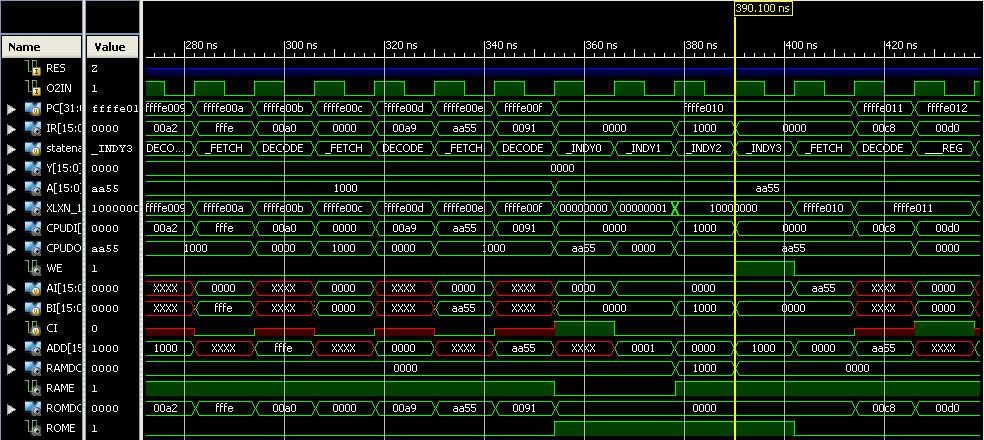

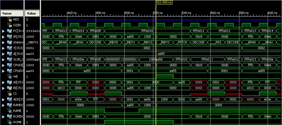

I'm still having trouble. But I have narrowed it down some. Let me explain.
First, I started to focus at the very beginning of the simulation where trouble is first starting with the indirect indexed mode. Using the same program I mentioned before, it is supposed to store $AA55 from $10000000 to $FFFEFFFF using a STA($0000),y.
In the first store it successfully writes to $10000000. The very next store it erroneously writes to $1000AA56. Which means $AA55 is being written to $00000000 at some point before this.
Looking at ISim (even in extreme magnification), there is no instance when there is a high WE, a low to select RAM, and an address $00000000.
This leads me to believe 1 of 3 things are happening: Either I am failing to initialize an internal register to properly see a simulation, the core is acting strangely after the 16-bit modifications, or I am losing my mind.
The last is quite possible!
My branch offsets are correct aren't they?

Can you show us your simulations showing the same signals as Arlet shows?
 Post subject:
PostPosted: Wed Jun 01, 2011 6:49 pm
Here it is from the beginning up to the second store... I used the same signals in almost the same order (XLXN_1 is AB[31:0]).

Hi EE
I ran your program in my setup: I seemed to have the same problem. In my case it was because of the small RAM being aliased, so writes to $1000_0000 were in fact overwriting the pointer at $0000_0000 - to avoid that hazard, it's safer perhaps to initialise the destination pointer to $1000_0002
Once I'd done that, it worked as expected.

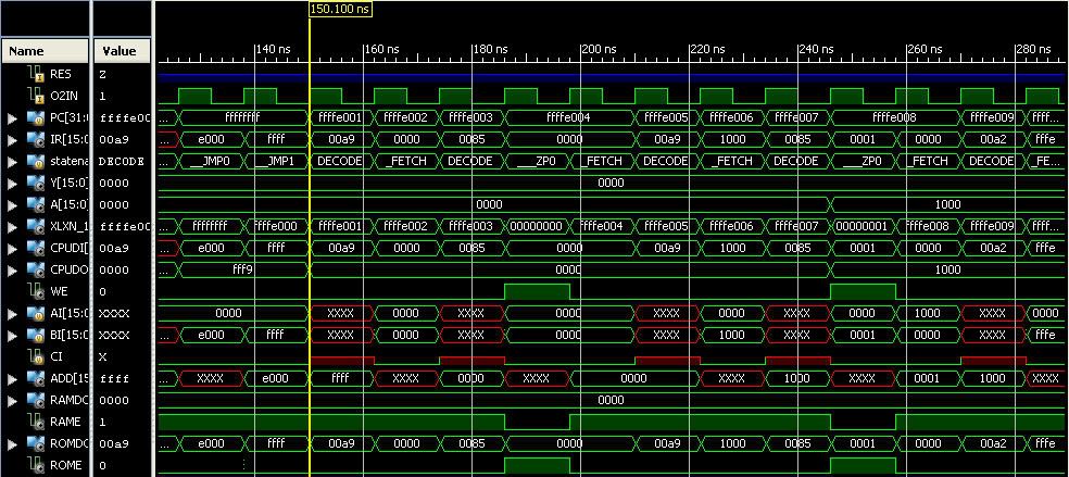

I will try to find out... The Devboard is initializing the display properly, which is a bunch of LDA/STA and LDX,DEX, BNE (for small delay to init TFT PLL)...
I've just finished my testbench which is good incidental timing. Top level signals are in red for when I post future sims, which in this case won't really matter since we'll be looking at internal CPU signals. For simplicity's sake in this testbench, the ZeroPage/Stack/ROM blockRAM's are 8Kx16 each fully address decoded. I'll post the innards any of the modules if needed.
I'll try to find out where the problem might be, write a simple program and follow it in ISim...
Aside from ISim, I am putting this core to use in real life on V1.1 of the Devboard as well, since a simulation won't reveal all.

Ok, I've found out the DEY instruction is not working on the devboard and confirmed by simulation on the testbench... I had rearranged the AXYS parameter assignments for 'd0 - 'd4. Maybe I shouldn't have done this? I'll try putting it back in 'order'.
parameter
   SEL_A    = 2'd3,
   SEL_X    = 2'd2,
   SEL_Y    = 2'd1,
   SEL_S    = 2'd0;
This doesn't matter...
Woops, sorry, I had forgotten to add line 983 from your master thread to my 65Org16.b! (946 on 65Org16.b)
983   8'bxxx0_1000,      // PHP, PLP, PHA, PLA, DEY, TAY, INY, INX
Now I have a viable core, time to add accumulators!
