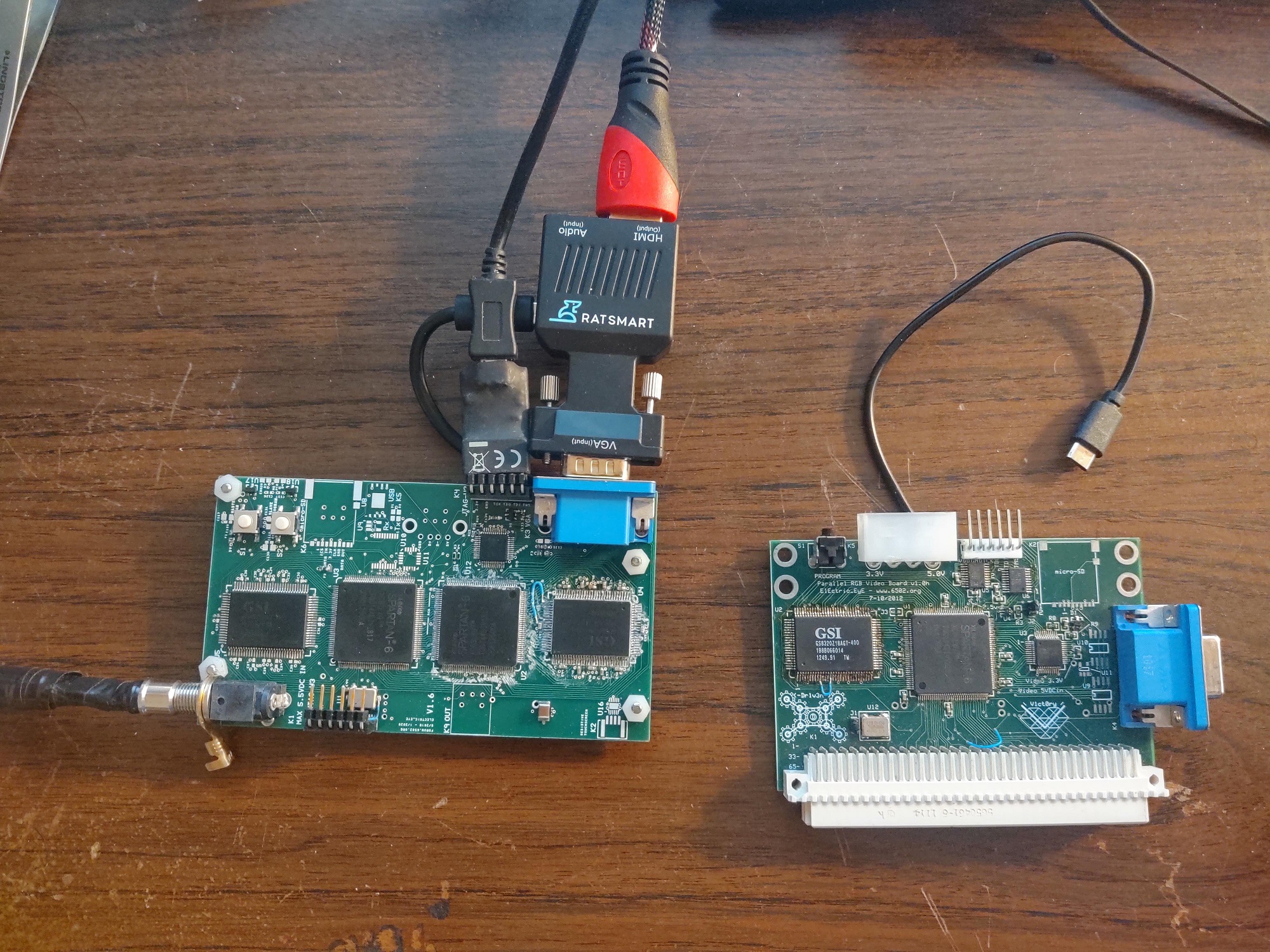

Small progress report:
Finally got the desktop fixed, the Intel CPU I7 6850 went bad. I was able to find a new I7 6800 and got everything installed.
Got the old server backed up to the AS3204T NAS.
Found an old PVB project(s) that worked on the PVB board!
Installed the VGA to HDMI connector and got the PVB board to output video to the Samsung 43" HDMI TV!
I think the next step is to get the old PVB ISE project files adapted to this new AV board for a solid foundation. Going back 7 years for this PVB project, but the good thing is the FPGA, SyncRAM and videoDAC are the common elements between the old and new boards. Here's a pic side by side. ;)
EDIT: It's an older pic, before I gave the AV board an ultrasonic bath in isopropyl.

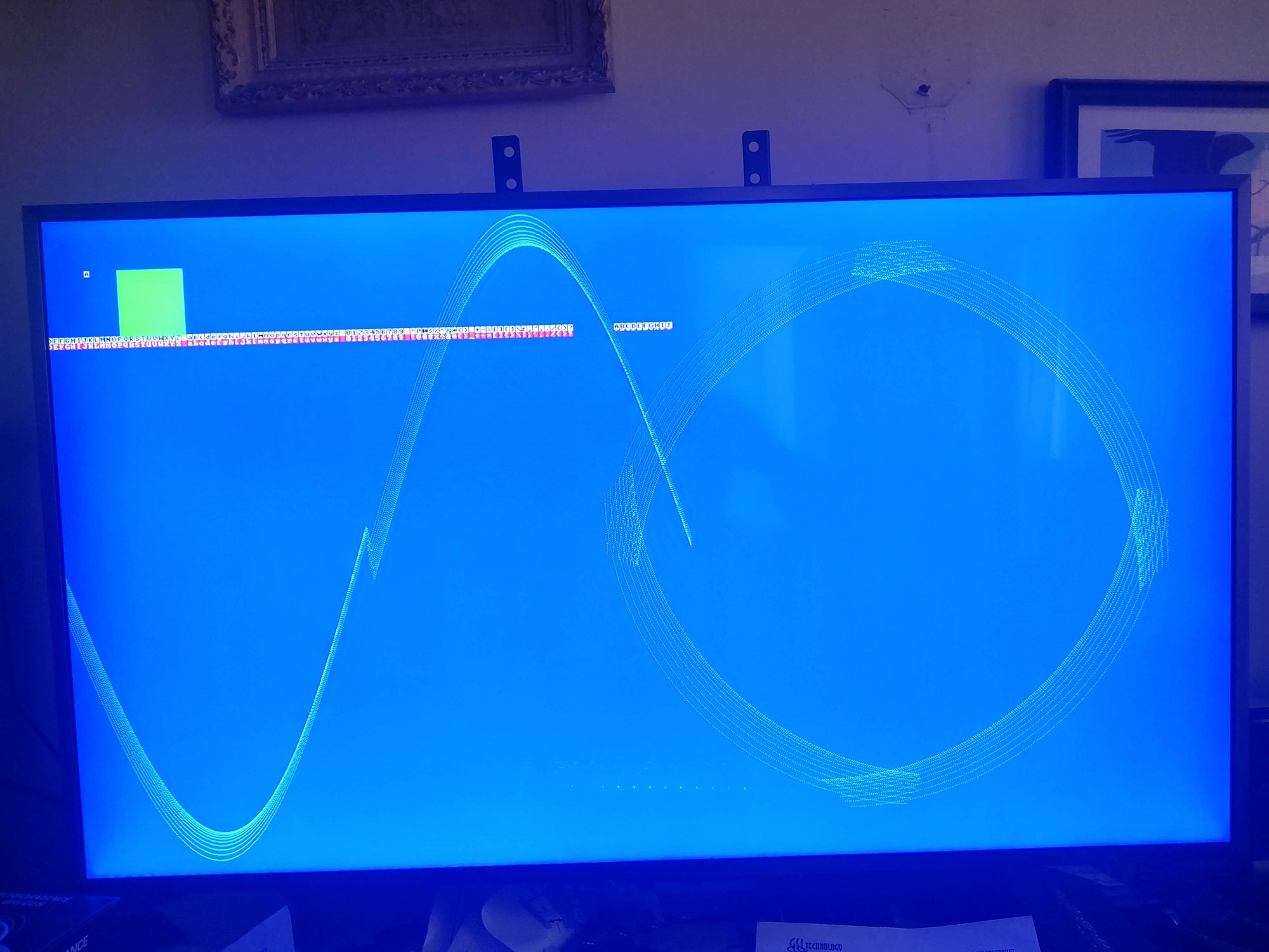

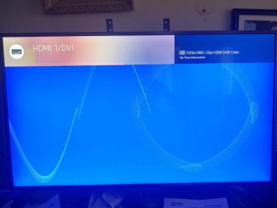

Progress report: So I've got the PVB to output to the Samsung 7 43" HDMI smartTV using the VGA to HDMI adapter and video settings from here. And the TV/monitor does recognize the timings. It did not recognize or even display anything with my timings (which are to the right of the semicolon). It used to work on an analog monitor with a VGA connector.
LDA #1920               ;2430 (2200 ideal for 67.5kHz) total H cycles      @148.5MHz 16.363uS ->  61.111kHz
                  STA hVIDEO
                  LDA #88                 ;205
                  STA hFRONT
                  LDA #44                  ;50
                  STA hSYNC
                  LDA #148                 ;255
                  STA hBACK
                  LDA #1080                ;1139 total     @148.5MHz ->  1139 x 16.363uS = 18.638mS = 53.654Hz
                  STA vVIDEO
                  LDA #4                   ;2
                  STA vFRONT
                  LDA #5                  ;55
                  STA vSYNC
                  LDA #36                   ;2
                  STA vBACK
PostPosted: Sun Mar 22, 2020 6:00 pm
Applying the same settings got the 1080AV board to display an all green screen, which was incorrect. However the monitor did recognize the timings from this board as well. Progress!
PostPosted: Mon Mar 23, 2020 8:44 pm
Confidence is near 100% that the FPGA JTAG section is fully functional due to the fact I have the green screen display output and the monitor recognizes the hsync & vsync signals to display 1920x1080. The scope also verifies nice clean hsync & vsync signals @ the VGA connector. When modifying the video parameters in 65Org16 software, the monitor jives with what I had programmed...
