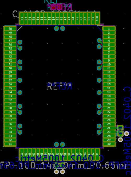

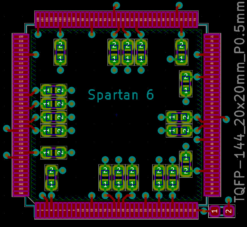

I've finally gotten around to some PCB layout after a couple days of experimentation.
First starting out with GND & power connections and bypass cap's on the master Spartan 6, although not utilizing all 8 layers yet. The VCCO 1.8V layer spans the entire board as does the GND layer. Regarding the 'chopped' layers involving the S6: VCCAUX (2.5V) is a blue area on layer 6 and VCCINT (1.2V) is a green area on layer 7 right under the S6, Blue layer sort of difficult to see.
So far that's all that is going on on those 2 layers, just right under that FPGA. It'll get more complex after doing the same to the slave S6 and then joining those areas on both layers. I'll try not to have too many vias poking holes through that master slave power plane(s) connection.

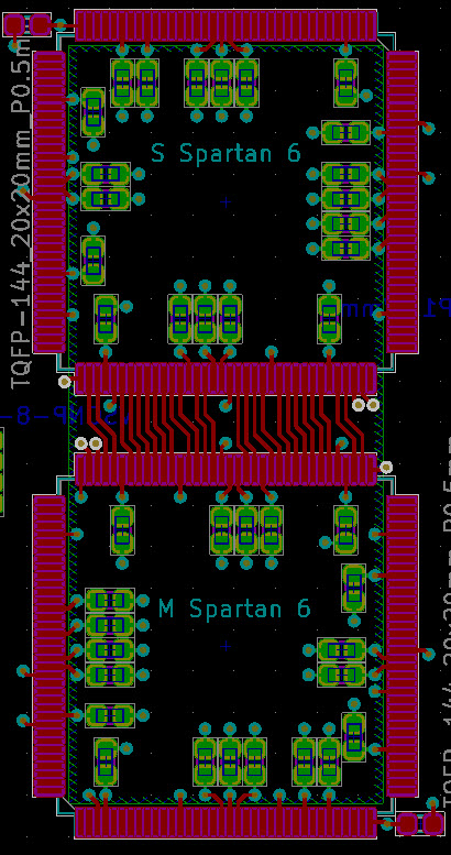

Finished both FPGA powers/GNDs and bypass caps. At which point I could place them as close together as possible. Worked out nice. Now time to do the same for the SyncRAMs. These will be a special challenge as these ICs will be mounted on the top and bottom on the board. So there's no possibility to place the bypass caps on the opposite side of the board underneath the IC.

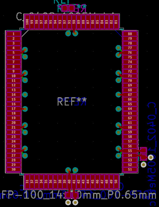

Here's what it's starting to look like on the top and bottom SyncRAMs. Goal was to make no shared power or ground vias. That's a big no-no. Goal achieved.

What I have to consider now, simultaneously, is bringing out all the address and data lines from both top and bottom SyncRAMs into common vias that go to the FPGA.

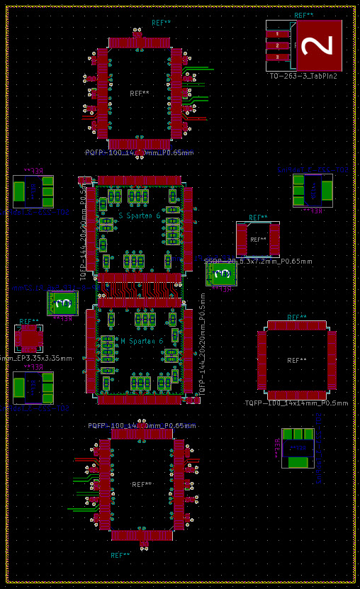

Finished all bypass cap placement for all 4 SyncRams and both FPGAs. Here's a glimpse of the full board from the top:
