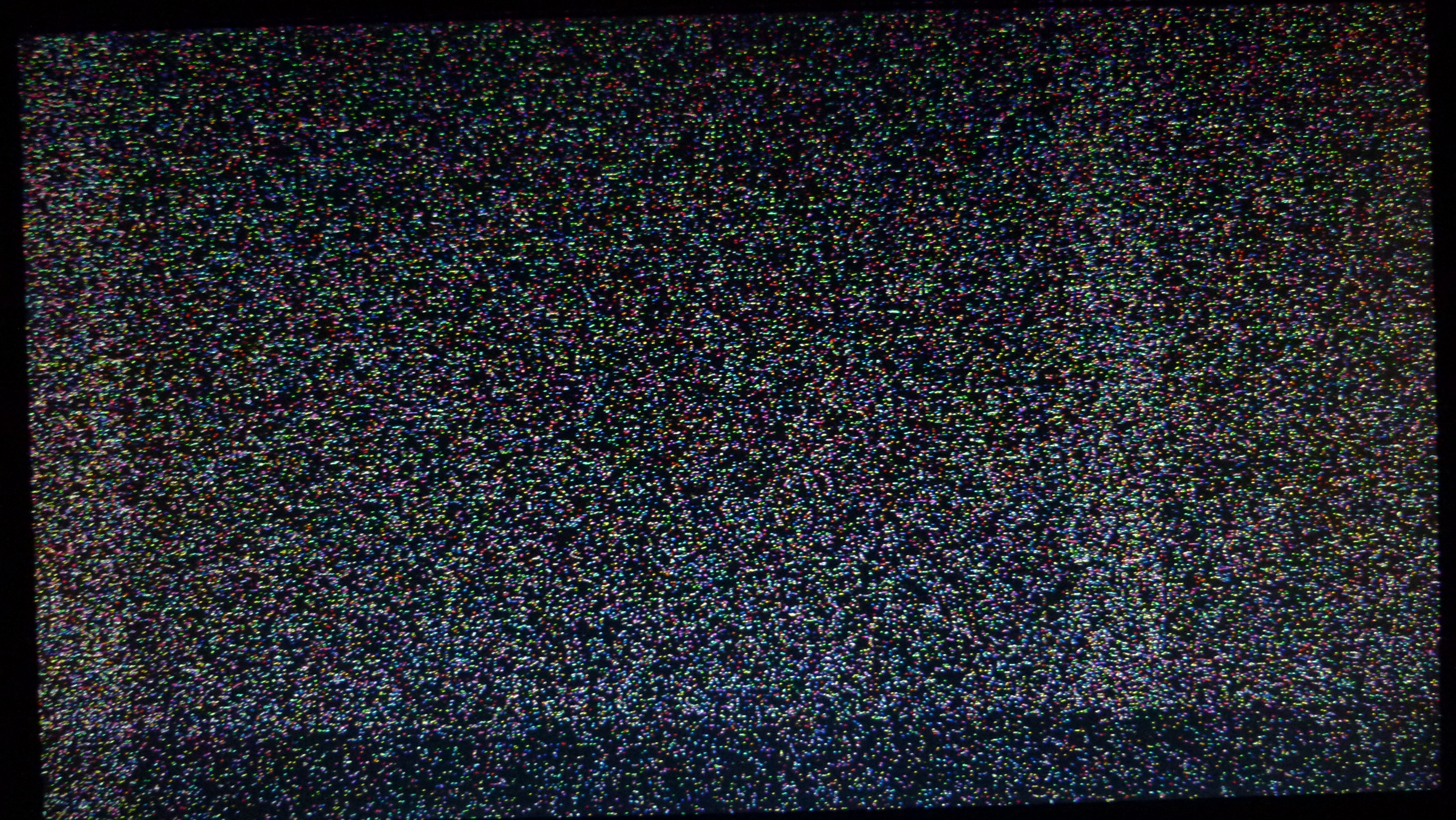

PostPosted: Thu Sep 25, 2014 12:30 am
The next idea was supposed to be simple but I think it shows a flaw somewhere in modification of the rng generator. It plots 65536 random pixels, random X, random Y and random color...Not spending too much time on this. There's a bit of a problem on the 1024 border vertical and horizontal, there seems to be a concentration of pixels, also too many zero values. Oh well, F it, I'm on to the next one. Pseudo Random Number Generators in HDL are not suited for the purpose I had envisioned.
1)read the rng, put a value in the color variable.
2)read the rng, put the value in X position register
3)read the rng, put the value in Y position register and autoplot.

File comment: 65536 pixels.

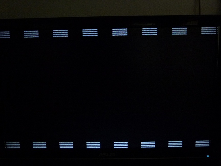

PostPosted: Fri Sep 26, 2014 8:57 pm

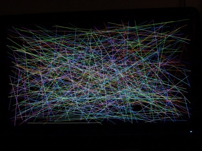

There is something seriously wrong with the HDL rng.
I did modify the Verilog awhile ago and it seemed to be OK for most uses, but I may have done a modification incorrectly.
Now when I utilize it for a random sample for an X coordinate, then mask the value for 1920 (AND #1919) and then another sample for a Y coordinate and mask that value for 1080 (AND #1079) I see something strange. I will post a pic before further experimentation with the rng generator code. In real-time, all random colored dots are being placed within the rectabgles as seen in the pic.
In the modified software code below (from the one above) for the random PLOT, there is the BCF0C $FFFE. BCF0C stands for Branch if Control Flag 0 is clear (i.e. zero). This branch opcode is in a constant loop testing the hsync signal as it has been wired to this control flag 0 bit in the status register of the 65Org16 cpu in the top_level design. As soon as it goes high, the cpu sends the final command to the LineGen accelerator for it to perform a single cycle plot, well within the time of an inactive hsync pulse, I'm not sure how many cycle it is though. The hardware accelerator then puts the cpu in a RDY state until the hardware accelerator is done. This results in a no address conflict between the VGA controller and the hardware accelerator, otherwise the result would be the snow effect.
rock              LDA rng
                  STA color
                  LDA rng
                  AND #1919
                  STA Xp
                  LDA rng
                  AND #1079
                  BCF0C $FFFFE            ;Branch if Control Flag 0 is Clear (0). CF0 is HSYNC input, so branch to itself and wait until hsync = 1, a non display period
                  STA Yp                  ;PLOT! (single cycle).
imp               JMP rock
File comment: Pseudo Random Number Generator in Verilog. Code above
PostPosted: Fri Sep 26, 2014 10:08 pm
Posts: 760
Location: Huntsville, AL
EEyE:
I don't think that there is something seriously wrong with the RNG. Instead, I am thinking that the equation you are using for the modulus operation, i.e. AND #1919 and/or AND #1079, is the issue.
Using the AND #xxxxx instruction to perform a modulus operation which is intended to restrict a pseudo-random value to a particular range only works if the desired range is a power of 2. Neither the 1920 nor the 1080 ranges to which you wish to restrict your RNG samples are powers of two.
Expanding these two numbers into the binary equivalents will show you why the values are falling into little rectangles: 1919 => 111_0111_1111, and 1079 => 100_0011_0111. Those zeroes in the masks are not at all desirable.
You could try masking it with 111_1111_1111 and then checking if the number exceeds 1919 or 1079, and if does, get another sample.

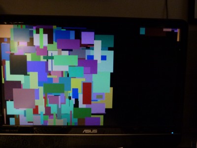

PostPosted: Fri Sep 26, 2014 11:14 pm
MichaelM wrote:
...You could try masking it with 111_1111_1111 and then checking if the number exceeds 1919 or 1079, and if does, get another sample.
Ah Michael, thanks very much!
Absolutely right. I had forgotten. There must be a mental block in there somewhere in my brain.
I've mod'd the software and it looks like this and is working almost 100%, but I've not yet added the part that checks if the number exceeds the borders...

PostPosted: Sat Sep 27, 2014 10:16 pm
I needed a refresh on my 6502 software, it has been awhile! Sorry about that and thanks for the help. I took Michael's suggestion and the following software works. I will have 2 videos for this speed comparison. One using the software below, where it waits for hsync retrace to plot with no 'snow effect'. The other video will use the same software but with the 'BCFOC $FFFE' line commented out, so the hardware accelerator will plot AFAP but with the 'snow effect'. The speed difference is dramatic and I aim for the higher plotting speeds being shown in these videos, without the 'snow effect', in the next build of these video boards.
rock              LDA rng
                  STA color
NG                LDA rng                  ;get 16-bit sample from HDL pseudo random number generator
                  AND #%0000011111111111
                  CMP #1919
                  BCS NG                   ;if random sample is >1919 get another random sample
                  STA Xp
NG1               LDA rng
                  CMP #1079
                  BCS NG1                 ;if random sample is >1079 get another sample
imp               JMP rock

The pixel plot without delay is difficult to see what's going on since this function takes a single cycle, it creates alot of interference.
The second video is easier to see what's going on and shows artifacts from the PRNG.
Pixel Plot function with no delay.
Pixel Plot function waiting for hsync.

Rectangle Fill Software for 256 random rectangles to test rectangle fill HDL Still needs some work:
                  LDX #255                 ;plot 256 rectangles using PRNG and Fill Function
rock              LDA rng
                  STA color
                  AND #%0000000011111111   ;mask off 2^8 bits
                  CMP #255
                  BCS NG                   ;if random sample is >255 get another random sample
                  STA fXlen
NG1               LDA rng
                  CMP #255
                  BCS NG1                  ;if random sample is >255 get another sample
                  STA fYlen
NG2               LDA rng
                  AND #%0000011111111111   ;mask off 2^11 bits
                  CMP #1919
                  BCS NG2
                  STA fXs
NG3               LDA rng
                  CMP #1079
                  BCS NG3
                  STA fYs                  ;Rectangle Fill!
                  DEX
                  BNE rock
imp               JMP imp
Initial static pic for testing rectangle fill:
(EDIT: I see a problem in the Verilog that is limiting the starting coordinates of the fill to <1024)
PostPosted: Sun Sep 28, 2014 8:53 pm
Posts: 411
Location: Minnesota
This wouldn't affect much, but are the values 1919 and 1079 correct? As written it seems to me they will never be accepted, so the last column and last row will never have anything plotted on them. If the values were 1920 and 1080, then all values in the ranges 0..1919 and 0..1079 would show up on the screen.
So..writing to the color and X-position registers do nothing directly, and it's only when the Y-position is written that all three are used to produce something on the screen? Otherwise it seems there'd be no point in waiting for H-sync before writing the Y-position, as writing to any of the three would use any values that happen to be in the other two. So for instance one color would be written three times: at Old-X, Old-Y; New-X, Old-Y; and New-X, New-Y (which then become Old-X, Old-Y for the next color). Which I assume is not what you want.
Regarding the PRNG, you're throwing away a lot of the randomness by tossing out the high five bits. Restricting the range to 0..2047 instead of 0..65535 means you wind up accepting a lot more values than you otherwise would. For 1920, restricting the range that way means you're going to accept almost 97% of the values produced by the generator. If you used the full range you'd accept only about 3% of them. The restricted range does mean you do a lot less looping, but it might have something to do with your artifacting problem.
Or not. But you can try it and see.

Um...after masking the value in A will be in the range 0..255. It will never be greater than 255, but this code will grab another sample if it happens to be exactly 255.
PostPosted: Sun Sep 28, 2014 9:14 pm
teamtempest wrote:
...So..writing to the color and X-position registers do nothing directly, and it's only when the Y-position is written that all three are used to produce something on the screen?...
That is correct, but there are other functions I am testing. I'm going down the list...Here are the spec's:

PostPosted: Sun Sep 28, 2014 9:16 pm
You may have something TT, I'll check it out tomorrow! Thank you for your anaysis.
PostPosted: Mon Sep 29, 2014 2:09 am
teamtempest wrote:
...Regarding the PRNG, you're throwing away a lot of the randomness by tossing out the high five bits. Restricting the range to 0..2047 instead of 0..65535 means you wind up accepting a lot more values than you otherwise would. For 1920, restricting the range that way means you're going to accept almost 97% of the values produced by the generator. If you used the full range you'd accept only about 3% of them. The restricted range does mean you do a lot less looping, but it might have something to do with your artifacting problem.
Very interesting. I think I could make the NBITS value programmable in the PRNG. I'll try this tomorrow. Thanks!
PostPosted: Mon Sep 29, 2014 11:47 am
teamtempest wrote:
This wouldn't affect much, but are the values 1919 and 1079 correct? As written it seems to me they will never be accepted, so the last column and last row will never have anything plotted on them. If the values were 1920 and 1080, then all values in the ranges 0..1919 and 0..1079 would show up on the screen...
I believe so. I was refreshing my knowledge from the old MOS Programming manual. From page 45 regarding the CMP instruction and associated flags, regarding the carry flag it says "...the carry flag is set when the value in memory is less than or equal to the accumulator, reset when it is greater than the accumulator.". After writing this just now, I see you're correct. I was never a strong programmer! :lol:
PostPosted: Mon Sep 29, 2014 12:34 pm
After I noticed the problem with the random rectangular fill, I thought I should test random line drawing. Seems functional.
LDX #512                ;plot 512 random lines, during HSYNC, using HDL PRNG for Line Function
rock              LDA rng
                  STA color
                  AND #%0000011111111111   ;mask off 11 bits
                  CMP #1920
                  STA lx0
NG1               LDA rng
                  CMP #1080
                  STA ly0
NG2               LDA rng
                  CMP #1920
                  BCS NG2
                  STA lx1
NG3               LDA rng
                  CMP #1080
                  BCS NG3
                  STA ly1                  ;draw Line!
                  DEX
                  BNE rock
imp               JMP imp
